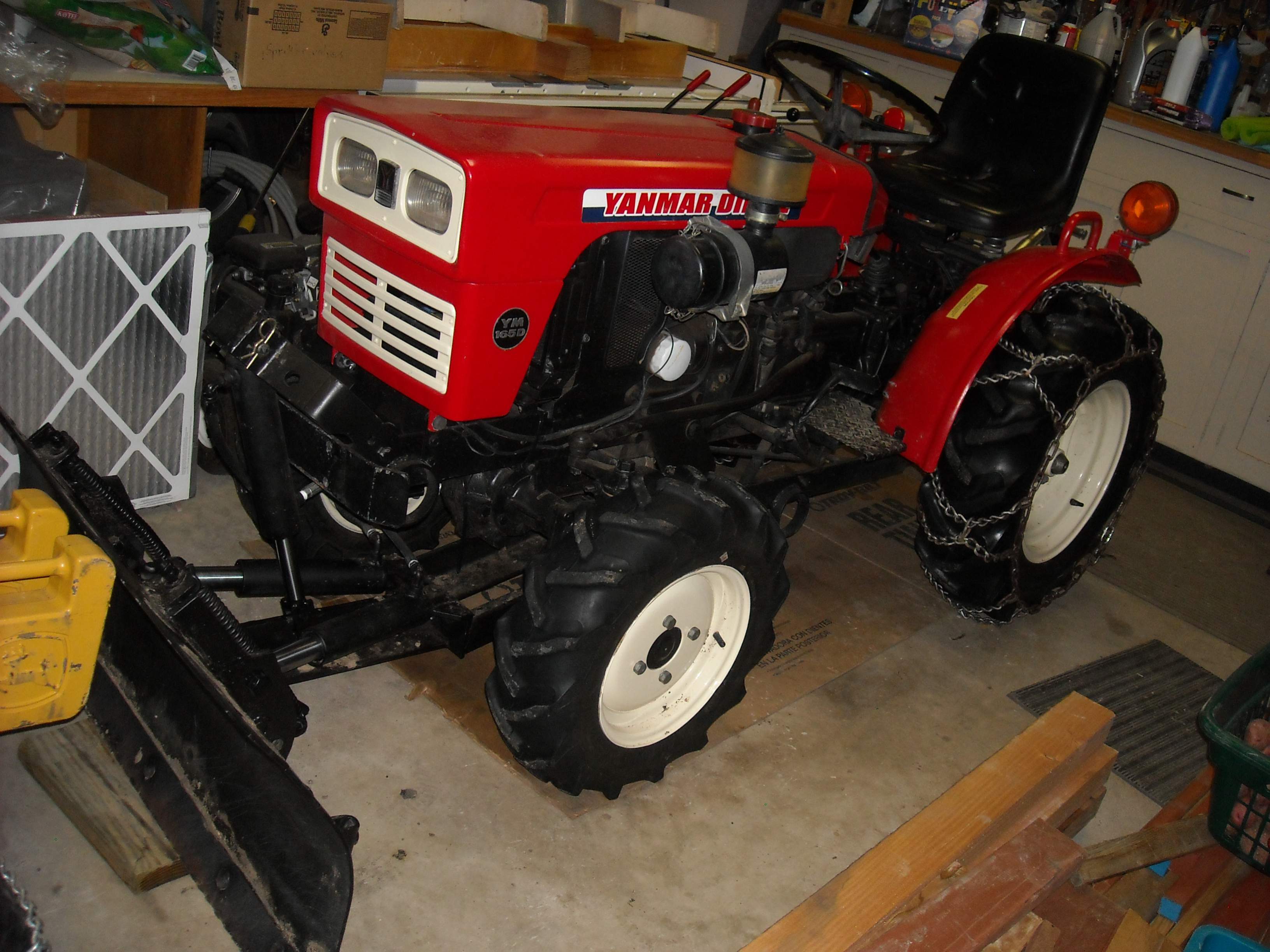

I bought this older tractor with low hours on and was pleased with the results. This little tractor is an awesome work horse.
The front blade pusher assembly has a mounting point at back that is also used to brace the three point hitch. I am missing what attaches these points to the tractor. It appears that I may be missing short bolts that are approx. 3/4 inch in dia. except metric of course. Could someone advise me of what I am missing and the size if possible.
Thanks Paul the Chicora Hillbilly

Thanks winston1, however I cannot get the link to load. Perhaps another member will know what I am in need of.
   / YM186D front dozer blade mounting #5
dexture and sarg 149 - Copy.jpgI have a ym165d with a yanmar dozer blade .The booklet that came with it shows the under frame is bolted to the tractor rear axle six bolts 3 on each side,they are M10x 1.50x70 bolts and six 7/16 lockwashers this may be different on your ym186D Pete
Thank you for the link. What I am missing attaches the bar where the lower lift arms attach to the tractor.
Thank you for the info. Mine attaches at the rear with just one bolt? on each side.
Many thanks to Gary at Jamieson Tractor for the info and drawings. I need 2 bolts listed as M22x50 with 1.5 thread, perhaps longer to go thru both mountings and into the tractor
