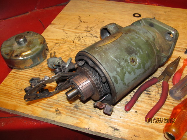

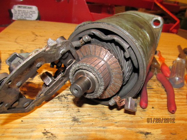

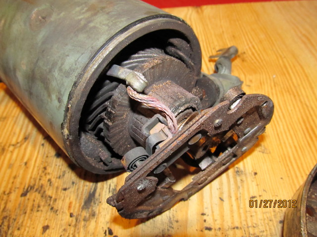

Unfortunately, it does not look like I got lucky. I still get the "click!" from the solenoid when I turn to start, but the starter motor isn't turning. I took the starter apart. I cleaned it as best that I could -- I couldn't figure out how to get the central part to come out of the housing. It was really, really dirty and had a lot of bits of copper floating around -- see before and after pics below. It turns easily by hand. BTW, I also am able to turn the engine by hand. After I reassembled the starter and re-attached to the engine, I still just get the "click!" The connections are no longer getting hot after working on those, so I did make SOME progress. So, does this mean the starter needs rebuilt? I don't know what that entails. Thoughts?

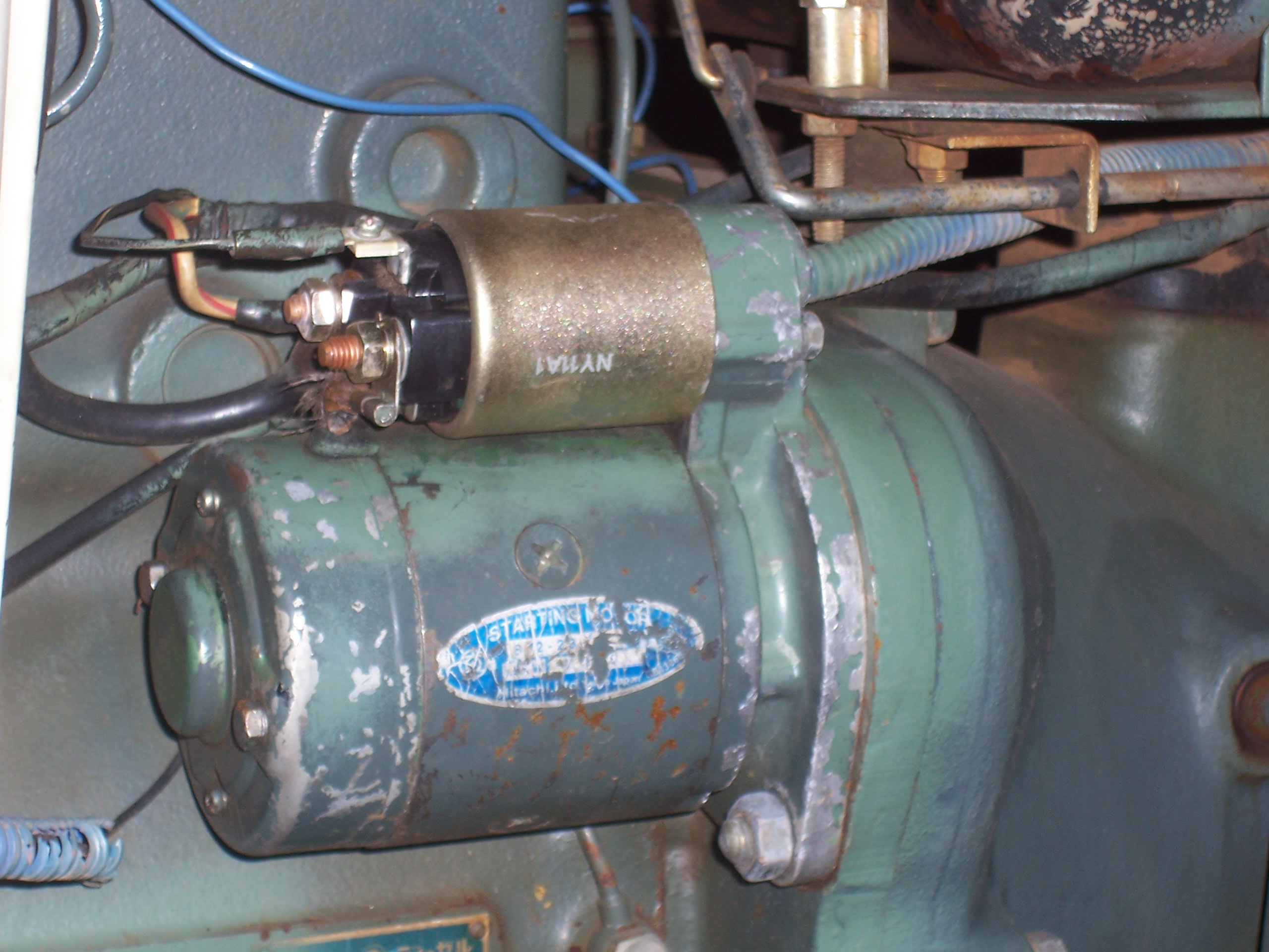

FWIW Rebuild it they replaced my Solenoid also in the Price I stated. I went back and pulled the Reciept It will be a Yr. come May and my Bad it was a Whopping 72.00$ and some change. PM me if you don't have any Luck finding anyone to rebuild it and I will give you the Info.

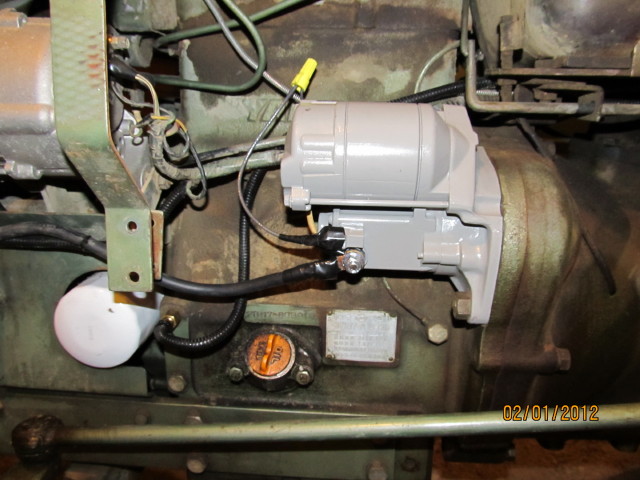

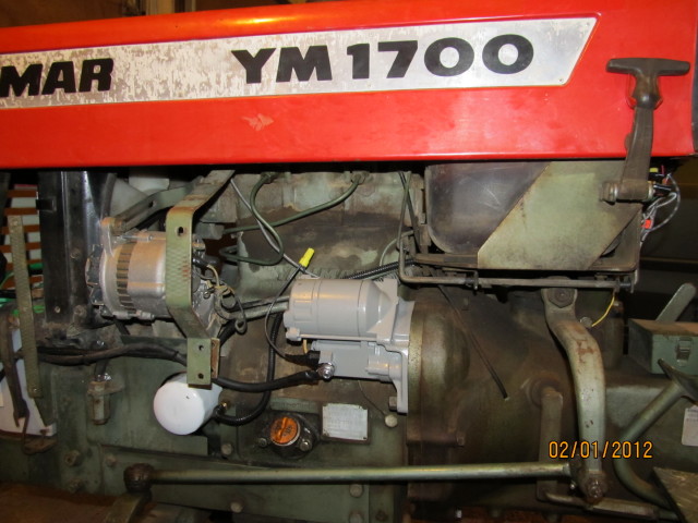

I decided to take my chances with the same Rare Electrical starter that California bought. I purchased it on Ebay for $100 including S&H. Before I installed it, I made a few measurements. The diameter of the gear matched the stock starter. I also measured how far the gear extends when engaging the flywheel during starting. It extends about 1/8" further than the stock, which I decided was ok. The bolt holes matched up as required. One issue I had is that the main fitting was about 0.01" too big to fit into the hole. I'm pretty sure I determined that this was not a problem with the starter but rather some imperfections sticking out on the engine side. I used sand paper, smoothed them out and was able to mount the starter flush as it should be. I connected up the electrical connections and VROOOOM! It started almost immediately. (BTW, it happens to be unseasonably warm today (~55 degrees) so that is obviously going to make starting easier.) I'm just glad it started at all! Time to celebrate... Cheers! :drink:
Wow glad you got up and going
