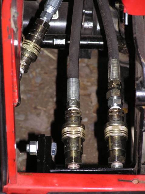

Here's food for thought.
Plumb in the pressure regulated by-pass so it reestablishes the original flow path, i.e. by-pass the FEL plumbing. Another way is to plumb in the pressure regulated by-pass to the down stream side is tapped in to the same flow path as the lowe pressure return line on the FEL.
On my rig the FEL line are up up tight and outa sight so little if any chance to get caught on anything. Both hi-pressure lines are secured to the mount on the FEL via the flange both hoses pass through. I've got my QD plumbed in at this point. No loose ends.
