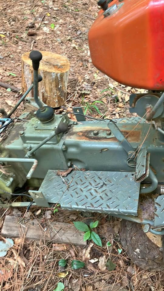

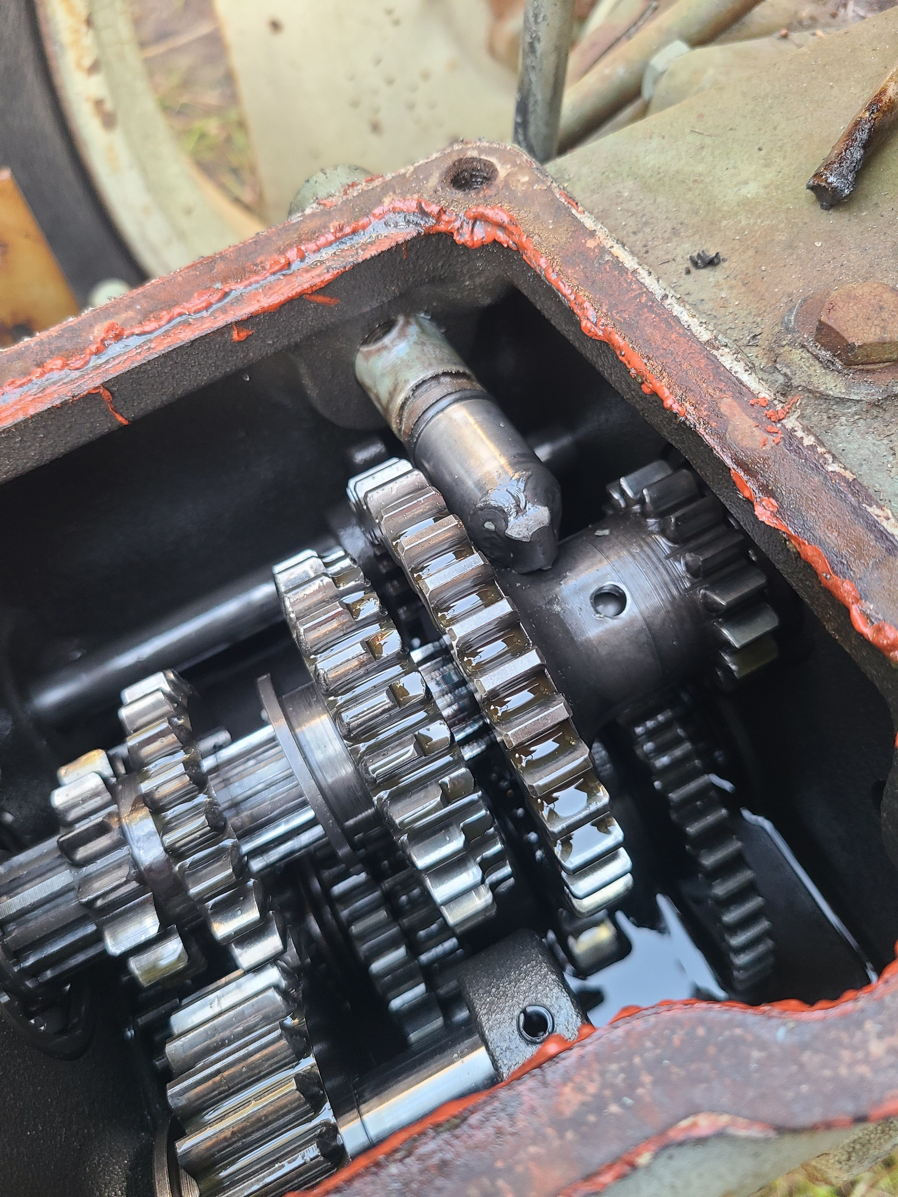

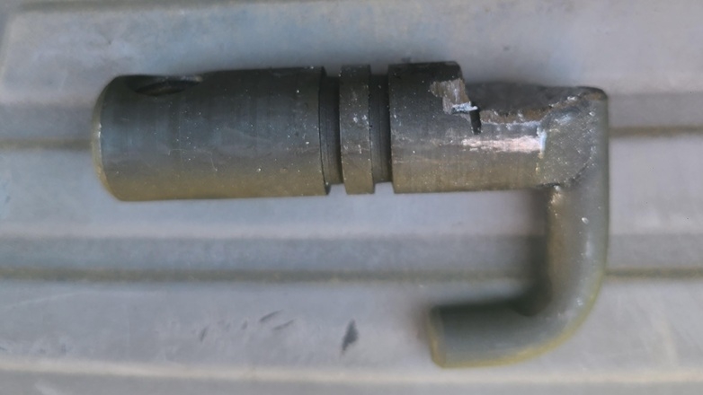

The hook on the High/Low shifter broke off. I removed the handle to be able to tap the old one out by pushing it into the case. Not a problem removing the old one as I tapped it from the inside out but cannot figure out how I am going to get the new one in as it will have to be put in from the inside.
Attached is a pic of the old one. As you can see it still needs to go at least another 1/4". Is there a trick to this or do all those gears need to come out?

An enlarged view . . .

So I was able to beat the broken one out from the inside but the new one would not go in that way and was hitting the same shaft so I notched it out with a bandsaw and was able to get it in from the inside. Works to go from High to Low but now when I put everything back together tractor will not go into Neutral using main shifter.

In event 1, is it possible the HI-LOW shifter broke due to some unknown binding inside. And now with the replacement, the tractor can not go into neutral?
You didn't mess with anything else from what I can see. The underlying problem still is there. :unsure:
   / YM1700 High/Low shifter broke #5
It's possible that when putting the top cover back on, the forks for the main shifter didn't go in the right places. You may want to check that out.
   / YM1700 High/Low shifter broke #6
It probably is installed before the shaft/gears are in place.
This is what I am suspecting but how do I know the "right places"?
   / YM1700 High/Low shifter broke #8
You really have to watch it as you put the top cover on. Make sure the gears and forks are aligned so you can drop the top cover.
