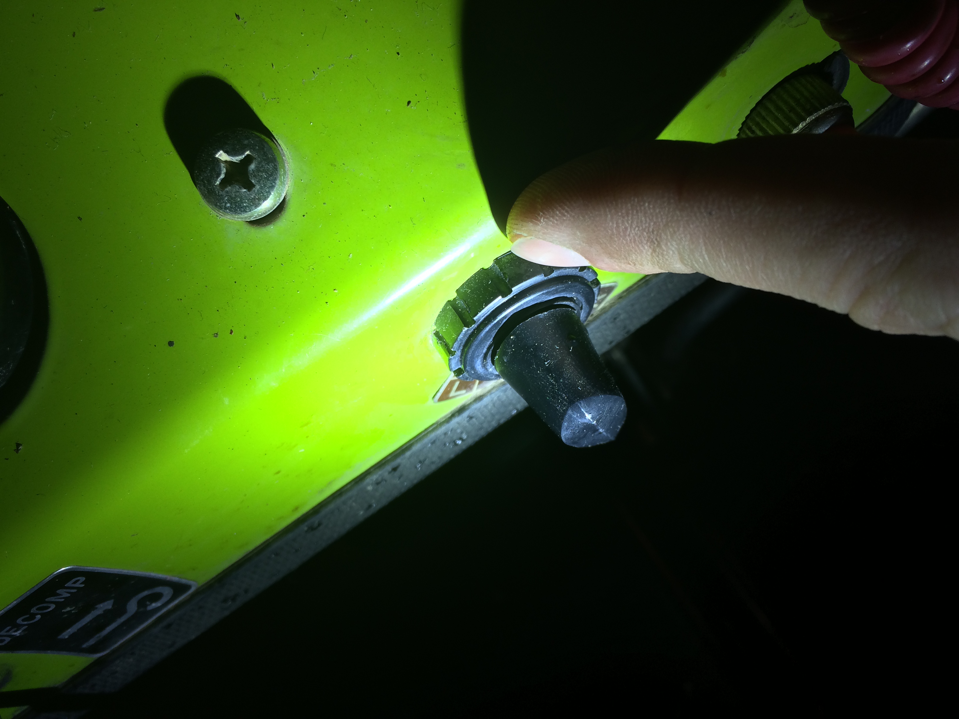

Hi All,
Looking for advice on removing the turn signal switch for my 155d. Standard black switch, center, left, right. How do I remove the leaver ?
I see that the headlight switch has a set nut. Don't see one on the turn signals. :confused:

Vern if you look at the picture I attached you will see a black circle with notches in it. Get a pair of pliers and turn that counter clockwise. That will free up the switch. I am not sure if the black knob pops off or not, but if you unscrew the 3 wires from the back and turn that circle counter clockwise you should be able to get it out. Hope this helps.

Yep, I can get the ring to turn, but not enough to get it off. It starts to rub on the knob and will not let me go further without removing the knob. Ill give it another try to see if I can make it work.

If there is no set screw on the knob it must just pull straight off. With a little force I would imagine.
   / YM155d turn signal switch ??! #5
I didn't want to pull on mine to hard because its only 10 degrees outside and didn't want to break the plastic, but I would imagine it would pop right off Vern. Or get 2 small flat head screw drivers and wedge it off. Then you should be good to go. Let us know if it works

Thanks all. There is very little danger in doing damage to it. Could get a replacement or "epoxy is our friend approach". Will try again today and let you know what I find. :confused3:

It just pulls out. After 30+ years of gunk, it needs a bit of persuasion.
