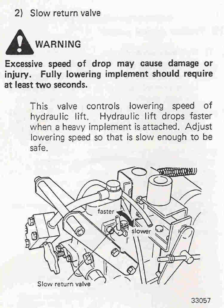

Jan 19, 2006 / YM1510D #1 R razorback98 New member Joined Jan 12, 2006 Messages 20 Location Rogers , Ar Tractor yanmar 1510d I understand that you can adjust the raising/ lowering speed of the three point hitch with a valve that is under the seat . Is that correct? Thanks

Jan 19, 2006 / YM1510D #2 C Cord Veteran Member Joined Mar 21, 2005 Messages 1,719 Location Richfield, Wi Tractor Resident Architect Yes.
Jan 19, 2006 / YM1510D #3 buppy69 Platinum Member Joined Mar 10, 2002 Messages 824 Location Western NC Tractor Hinomoto E2804, Hinomoto N239, Just the lowering. The raising will not be affected. Eugene
Jan 20, 2006 / YM1510D #4 L LawrencePickard New member Joined Oct 10, 2005 Messages 6 Location Chino Valley, Arizona Tractor Yanmar 1510D I'm pretty sure that the valve under the seat is to lock up the 3pt hydraulics, the valve to control drop is on the right hand side under the seat.

Jan 21, 2006 / YM1510D #5 BruceR Gold Member Joined Aug 31, 2005 Messages 429 Location East Texas Tractor YM 2000B, JD 110, cub cadet 109, cub cadet 70, cub cadet 100 Hope this comes out so that you can read it. This is on a YM2000 but I guess it would be the same. Bruce Attachments 810337-slow return valve.jpg 55.2 KB · Views: 203
