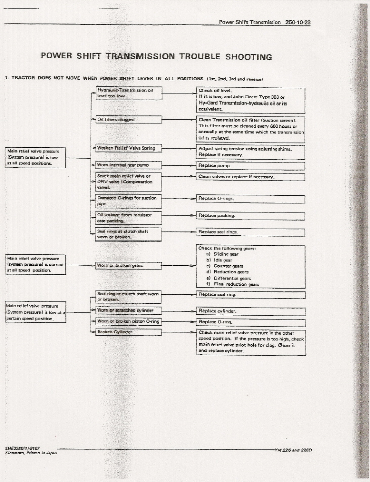

/ YM1510 Power Shift Slipping #11
Here is a page out of a 226 book, I imagine it would be much like yours. Hope it's large enough to read. I think it will be if you enlarge your screen size. Good luck.

#13
Thank you guys so much. As my wife would said the tractor guys rock. I followed the instructions that you guys gave me and took apart the pressure relief valve. What i found was that the springs looked fine. When I examined the cylinder I was surprised to see a small indention on the side that looked like a tuft of brown hair. The hole was completely clogged with some kind of foreign matter. I cleaned this out and reassembled the pressure relief valve. This was all it needed.
I pushed about 2 yards of dirt back into a hole left by my septic contractor and never had a moments hesitation.
Thanks again.
