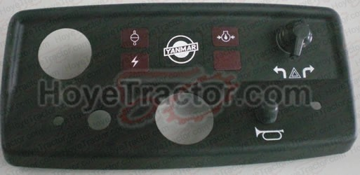

/ YM1502d dash lights #9
Excellent! So do you know what that upper left symbol is for?
Or the upper right for that matter.
Lower left should be volts.
I think lower right is water/ engine temp.
The Hoye image of just the dash panel helps too. ;)
Now, on the YM1510, the lights are bubble red caps that would light up. They are in the same 4 placement locations. I was searching last night trying to figure out IF they are one-in-the-same lamps for the SAME indicators. hmmmm
The YMxx02 or YMxx20 and some other selected YM series machines have similar dash indicators like you YM1502. You'll have to search out those models and get a consensus what those icon images represent. Maybe a US YM manual would give the info easily.
Where is rScotty ???? He would have an inkling on this too.
/ YM1502d dash lights #10
Upper left is high coolant temperature and upper right is low oil pressure. You can test those lights by touching the wire going to the temp switch and/or the oil pressure switch to a bare metal surface on the tractor. The corresponding light should light up.

/ YM1502d dash lights #12
Upper left is high temperature and upper right is low oil pressure.
Is the lower left then voltage for starting? The lightning bolt means something back then and totally different today in vehicles made after 2000.
/ YM1502d dash lights #13
Lower left lightening bolt is on, when alternator/regulator output is lower than sufficient to charge the battery, ie at slow idle.

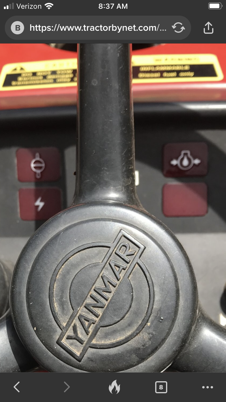

/ YM1502d dash lights #17
I have a YM2002d, I will try to look at it and see what I can figure out. Memory says that blank (no icon) on your photo of the YM226 is also blank on mine and does not light with the “test” button pressed.
I believe they are electric, oil pressure and coolant. Mine has a temp gauge so I seldom look for that light, but watch the gauge. Unfortunately the gauge is electrical, so that is a possible issue as well.
I have not gotten to the tractor yet but found this info in a operators manual on 02 series YM’s. It goes down to 1702 and up to the 2002 models.
Hope it helps. When I get to the tractor, I will try to get a photo if the icons on the tractor warning lights.

/ YM1502d dash lights #19
Here are the icons on my dash. The 2 you can see from the manual match what are on my tractor. Hopefully this helps with with your 1502.
