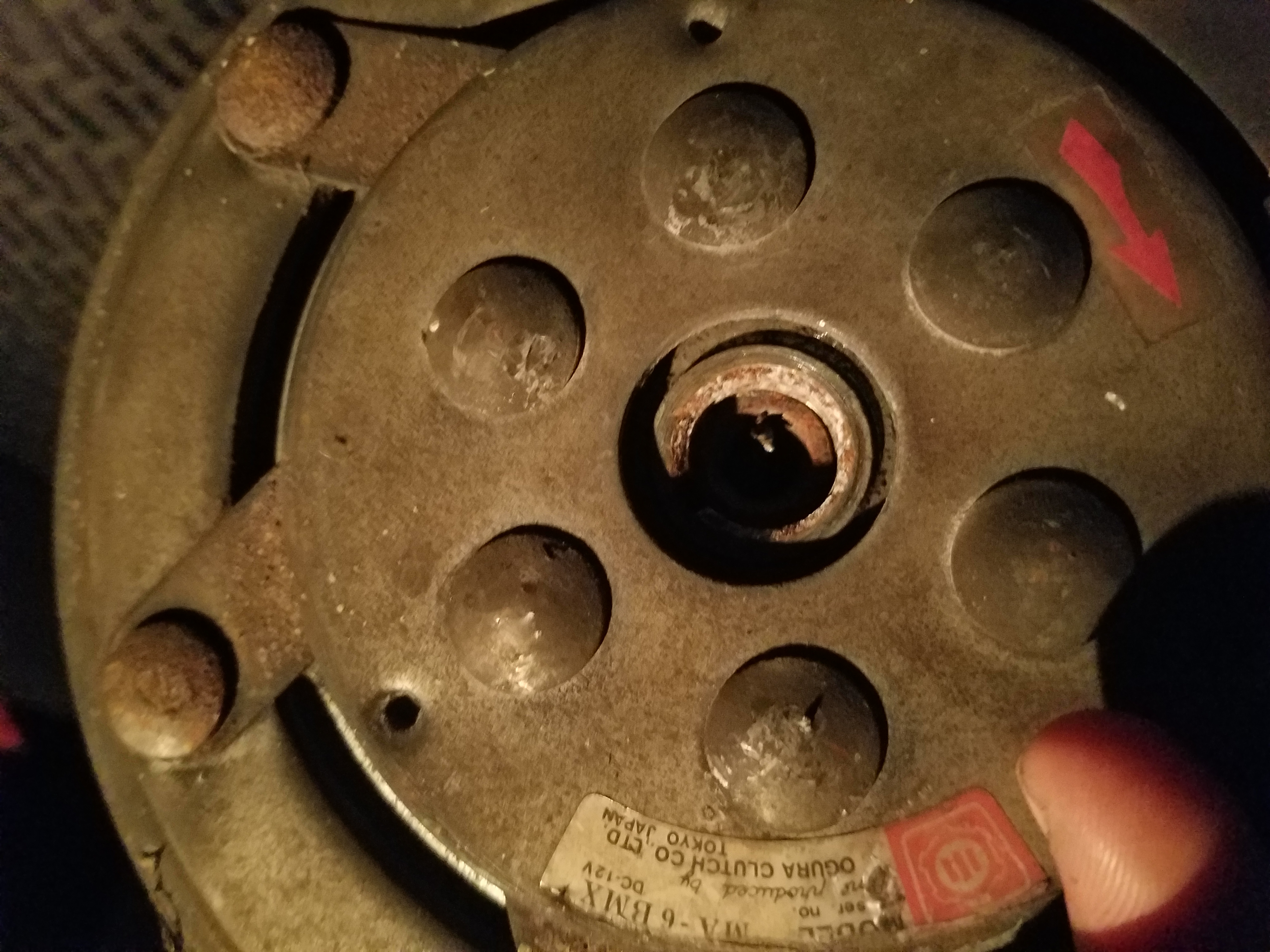

While I am looking for the filter housing, does anyone know how to separate these front PTO parts? Is the Clutch splined, keyd,or threaded on? This one is giving me a hard time.

Hummm... My guess it's pressed on with a keyway. If your can't see in the hole with threads it's pressed on. No Bolt head, Allen wrench head etc. have to be. Put a gear puller on it. Have to come off with it. Can't see down in the hole so that would the tell tale. JMO..
   / YM135D Air Filter Housing.
#23

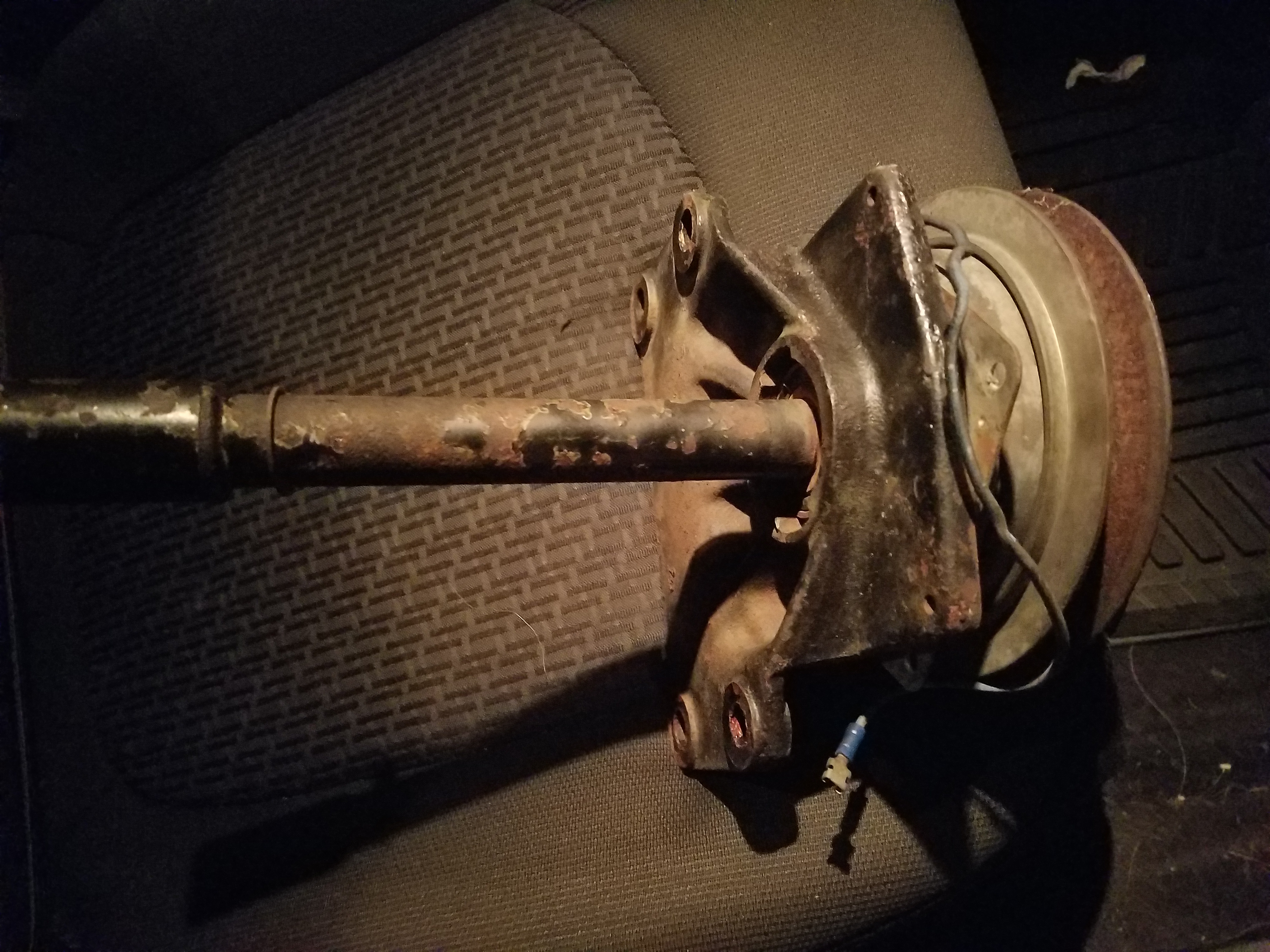

I had to use a gear puller and a brass hammer to pop it off. it is on a keyed taper. Getting the shaft out of the bearing in the casting was much more difficult. I ended up putting the whole assembly in the shot blaster (didn't matter because the bearing was shot) to clean the corrosion and rust off enough to beat it out. New bearing is ordered already and remaining parts will get paint tonight.

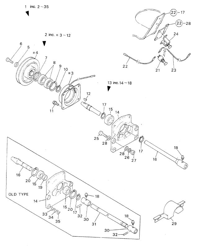

Probably too late but might still be of some help.
   / YM135D Air Filter Housing. #25
Sure makes me feel better. There is a bolt and washer locking it down. And if it wasn't there and end up having problems keeping the pulley on the shaft. ;) But no mention of it having one.
#26
Yeah that still helps. The 2 stacked bearings #8 felt ok but I would probably change them if I could determine how to remove them. I pulled the Circlip and they didn't budge even after a few cycles through our automated parts washer at work. (nice to have access to stuff like that on a project like this)

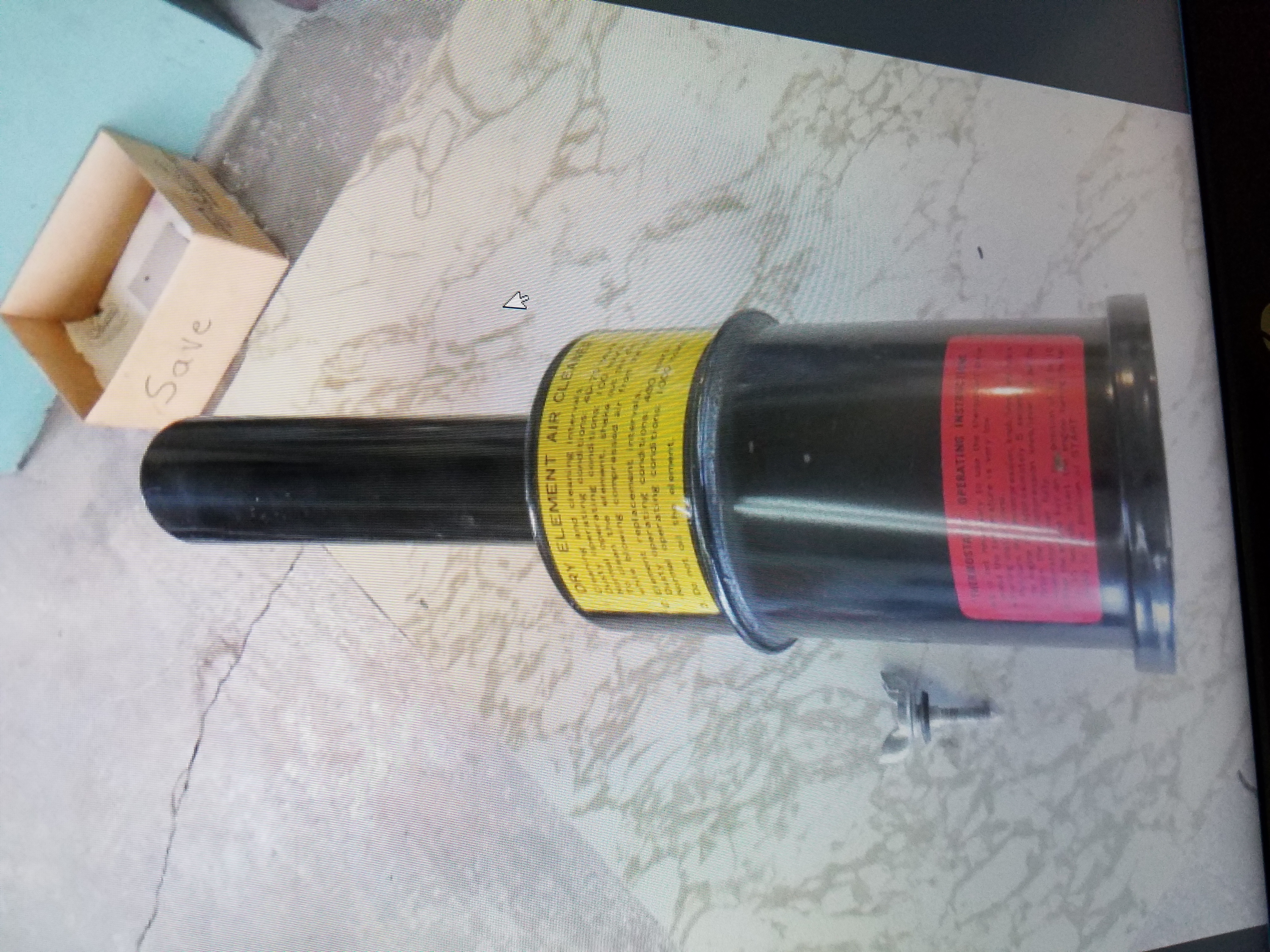

Air filter housing has been purchased! Gary said he found a second new one as well so if someone else needs one call him up! THANKS!
#30

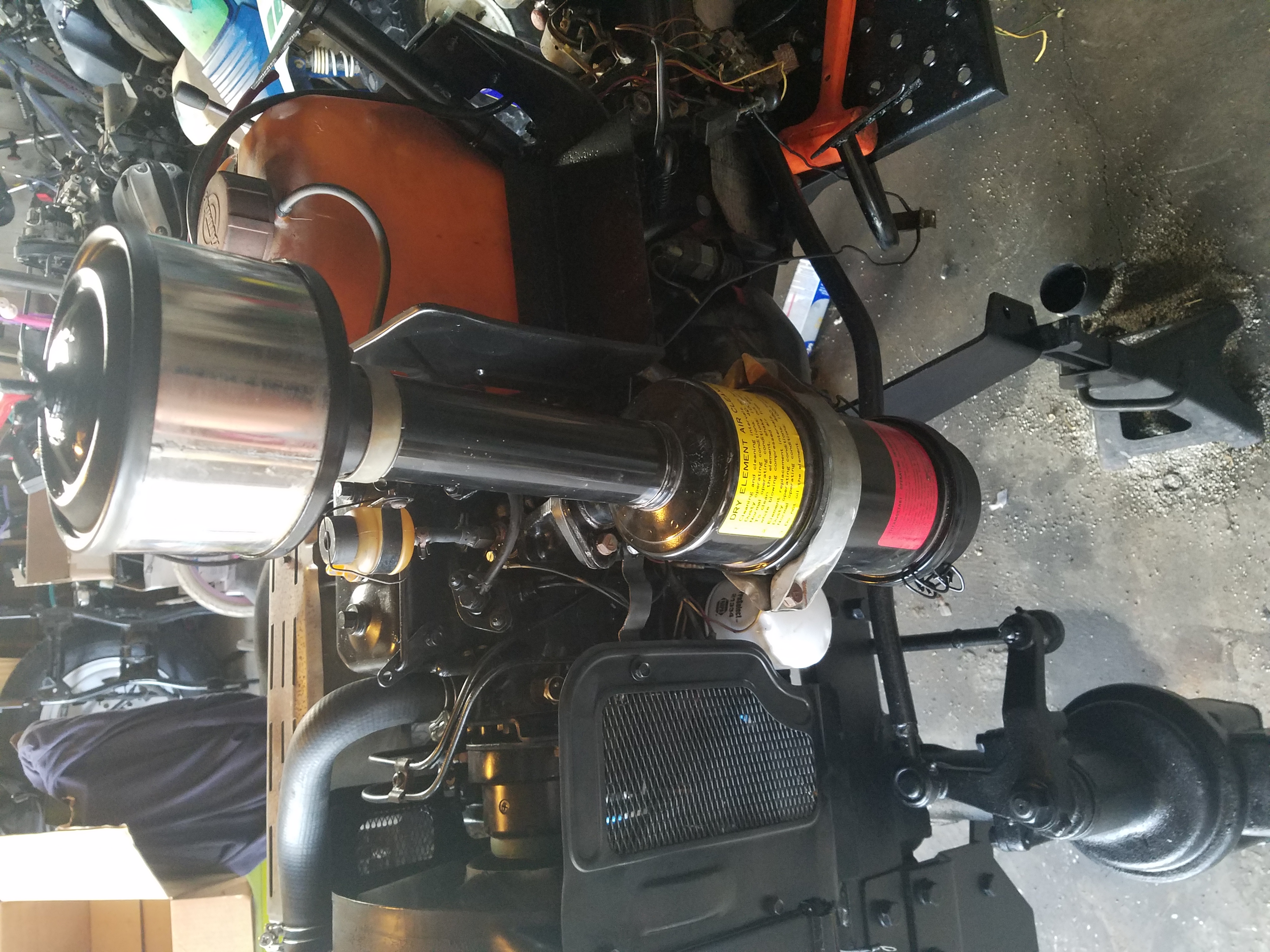

I received the new air filter housing and got it put on last night. Everything went as it should and it looks good. I am starting on the electrical next which shouldn't be horrible.

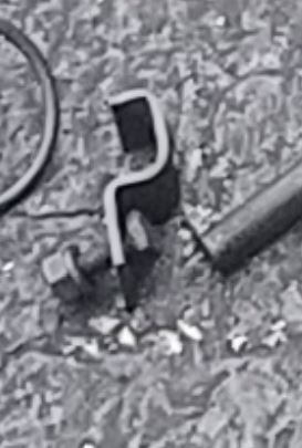

I did notice I have one bracket left over so far and I can't seem to remember where it came from... Does anyone know where this may have come from? It was in the first batch of parts so I am thinking it is from somewhere in the steering box/dash area or left side front area. This is the only bracket I don't remember and somehow it didn't get placed in a baggie like the other parts did for each assembly.
