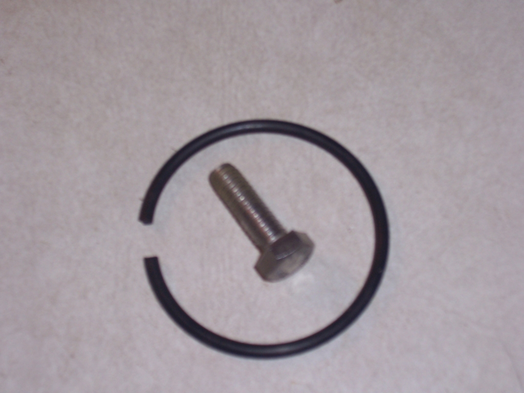

New conversion kit.
It's raining just couldn't help it.
