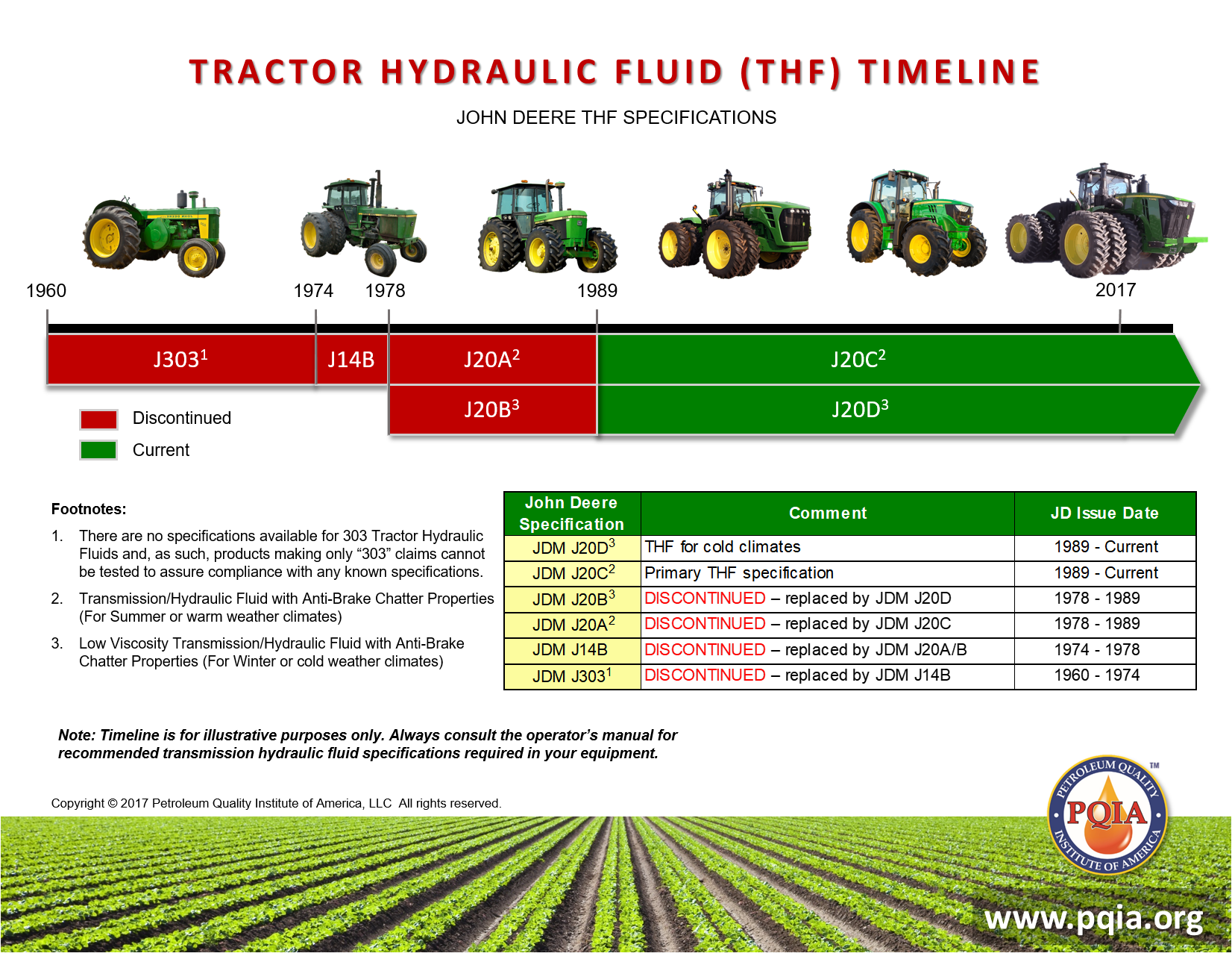

There are only 3 possible fluids to put in your YM180(D).
Hygard = JDM J20C
Yanmar TF500A = JDM J20C
Kubota UDT original = JDM J20C
Ashland-Valvoline makes JDM J20C

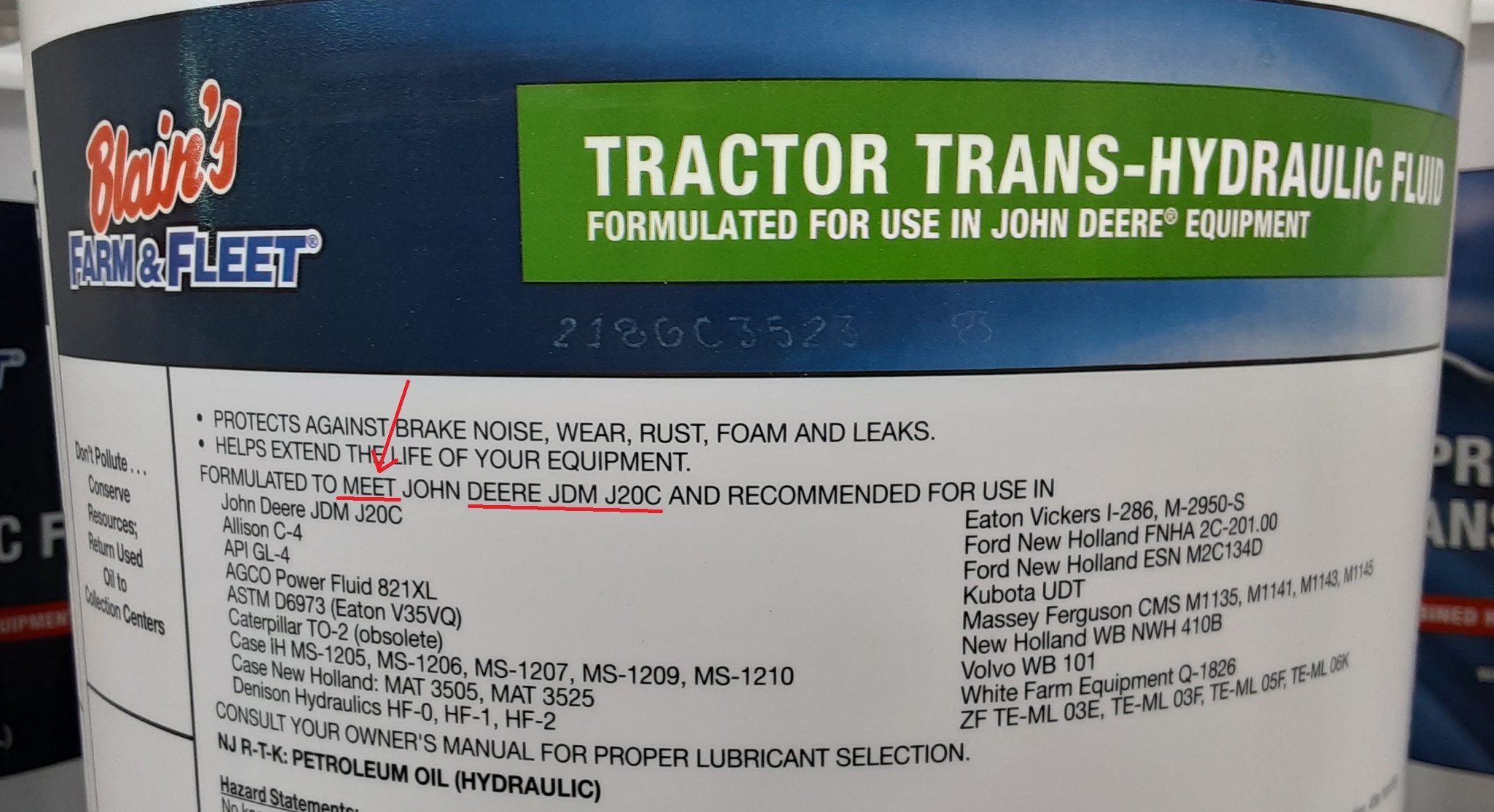

Only buy brands that STATE, MEETS J20C and never never never 'compatible' nor 'recommended'.
I guess there are several thousand of us that are in serious trouble that have been using other brands of J20C for the last 25yrs without problems.
   / YM 180D transmission fluid #13
I use Farm & Fleet.
