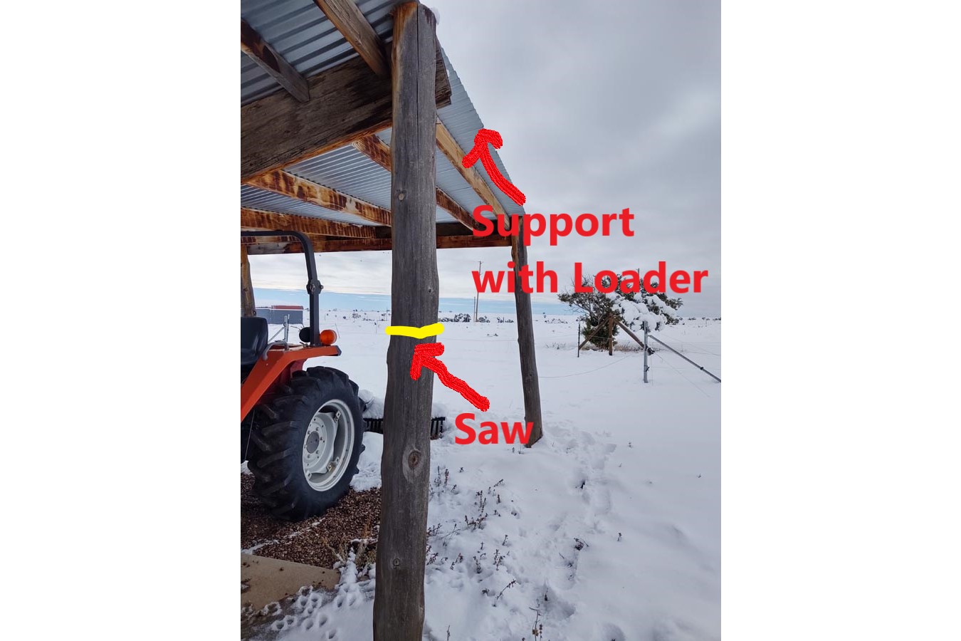

Keep it simple and safe.
Tie onto the bottom of the single center post and pull it out so the center of the roof will come down level or maybe even to the ground. This will help pull out or at least loosen a lot of the nails holding everything together.
Next tie onto the bottom of both end posts, pull them away from the shed so the end part of the roof comes down to ground level.
Take apart the roof that is on the ground and take as much of the tin on the other half as you can, hopefully you can get all the tin off.
Then just start pulling off the boards.
Adjust this process as needed after each step is done.

You probably won't be pulling the end posts out if they are cemented in the ground, unless they are already weakened. Stay safe

Yep, they're in concrete. Dang!

1. The Posts are in Concrete
2. You have a Sawzall to cut the posts off
  • I would use the tractor bucket to gently support the roof at the center post - Saw through the center post - Then Lower the bucket (and post back on itself)
  • Then chain bucket to end piece (around the back piece and "rafters) - Gently lift - Saw through both end posts - Then lower bucket
  • If it's still standing - hook a chain on to two end posts and slowly pull backwards.
Crude pictures follow:
