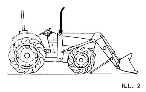

I just bought a yanmar loader from Aaron at Hoye to put on my YM336D. Everything worked as it should but it was missing the parking leg. I have made one out of a piece of 1 1/2 inch galvanized pipe and a floor flange. I need to know the length of the factory leg if anyone has 1575 or a 1500 loader. Thanks, Rick

We sent along a YFL1575 manual for it but it does not have any specs on the stand. Looks like it should just extend all the way to the tire though according to the drawing.

Thanks Winston & Aaron. The manual says to start with the bucket in the upright position,insert the leg, then lower the bucket to the ground which will raise the frame high enough to clear the wheels. I was sure someone would have one they could just pull out and measure. I'll have to be careful and not cut the pipe to short.
