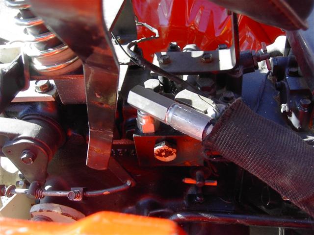

I'll start with a couple pics of the hydraulics. Easy enough as long as you have a manual handy. Remove the factory plugs from the top of the hydraulic block... insert one 1/4" headless pipe plug. Connect "out" to "in" on valve body. Connect "out" from valve body to hydraulic sump on left side of tranny. Connect "PBY" to "in" on valve block. This connects the loader in series, before the 3ph.

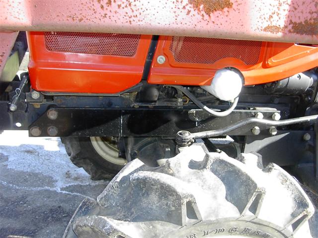

The loader came with long narrow steel plates, which effectively double the front frame section of the tractor. Something i did not see with any of the aftermarket loaders i was looking to purchase. Needed? Maybe not. Nice insurance to have? You betcha !

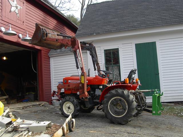

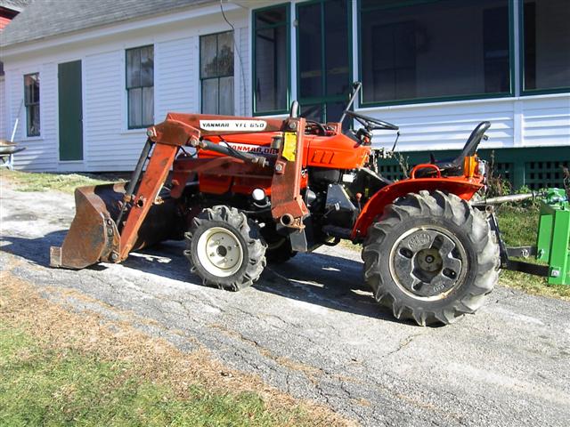

The actual install was easy. Everything lined up almost as though it were made for my tractor. Unfortunately.... it appears the loader had been sitting outside for the past fifteen years. My nice clean tractor looks fifteen years older just by the faded paint and surface rust. Perhaps this adds character ?? Anyway.... i'm hoping to have time to take it apart and give it some fresh paint this spring.

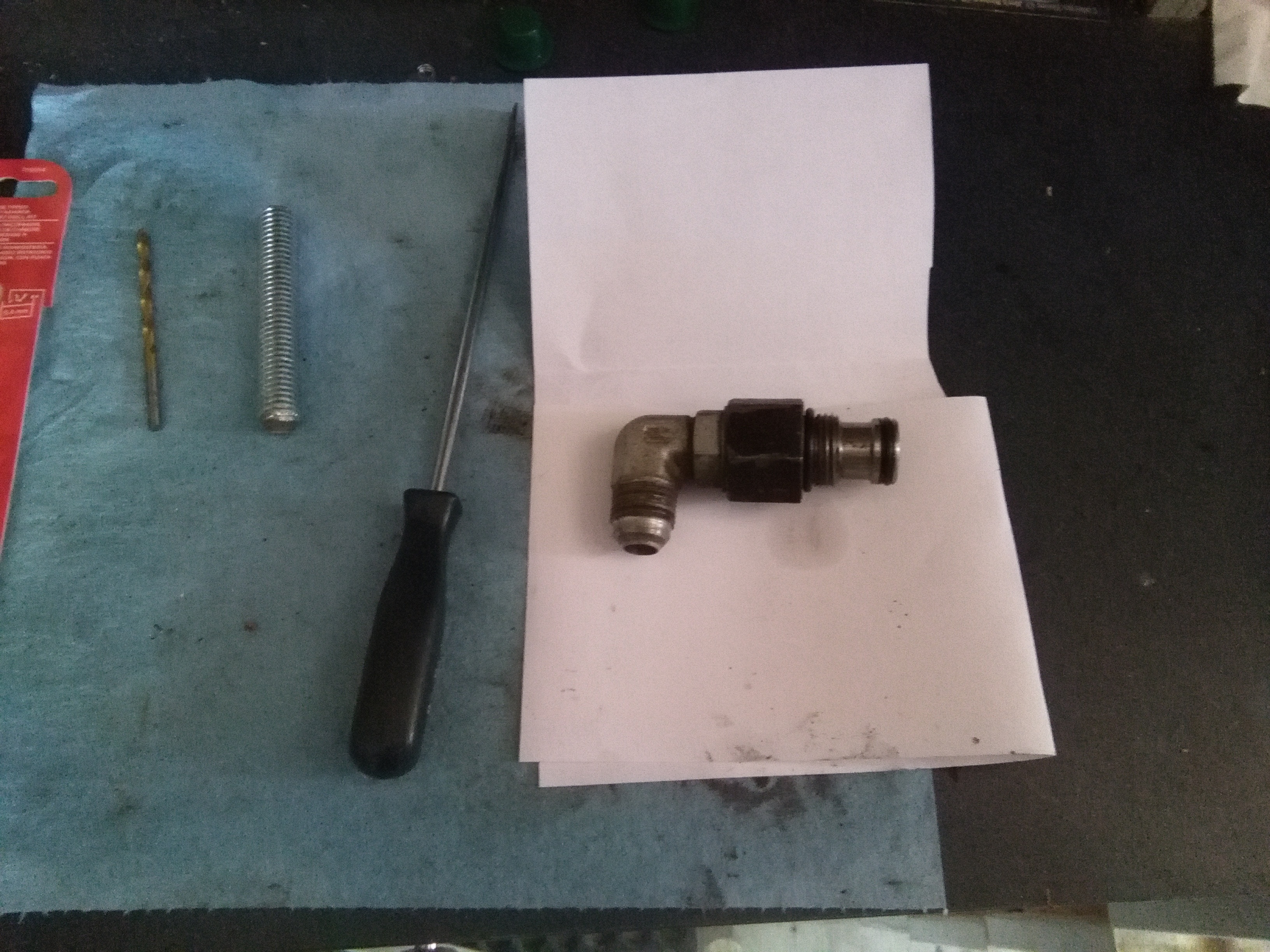

IMG_20170905_115308.jpgIMG_20170905_115308.jpgJust starting to complete plumbing connections for same loader . Which port does the allen head plug go in ( port In or out plug on block ) . I see where the PBY hose connects to the block . Please see attached pic and tell if this is the correct fitting that attaches to the PBY port on the control valve . When all the installations are completed does this still mean the hydraulic system continue operating in the center open position ?
thx
Don
