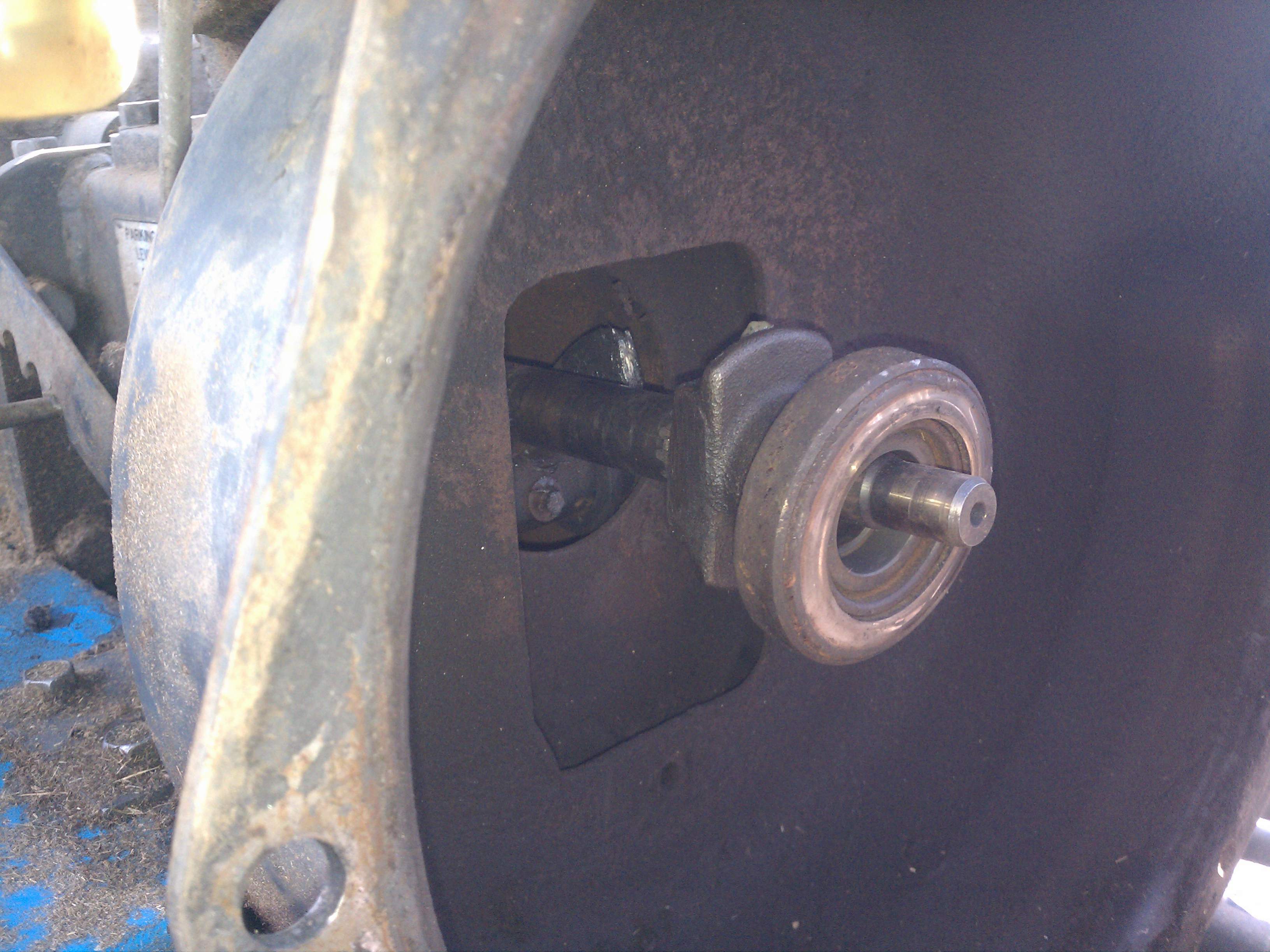

Got it split.
The hub with the ears that is pushed on by the shift fork... spun itself 90°, so the shift fork had nothing to push on :mad: :laughing:

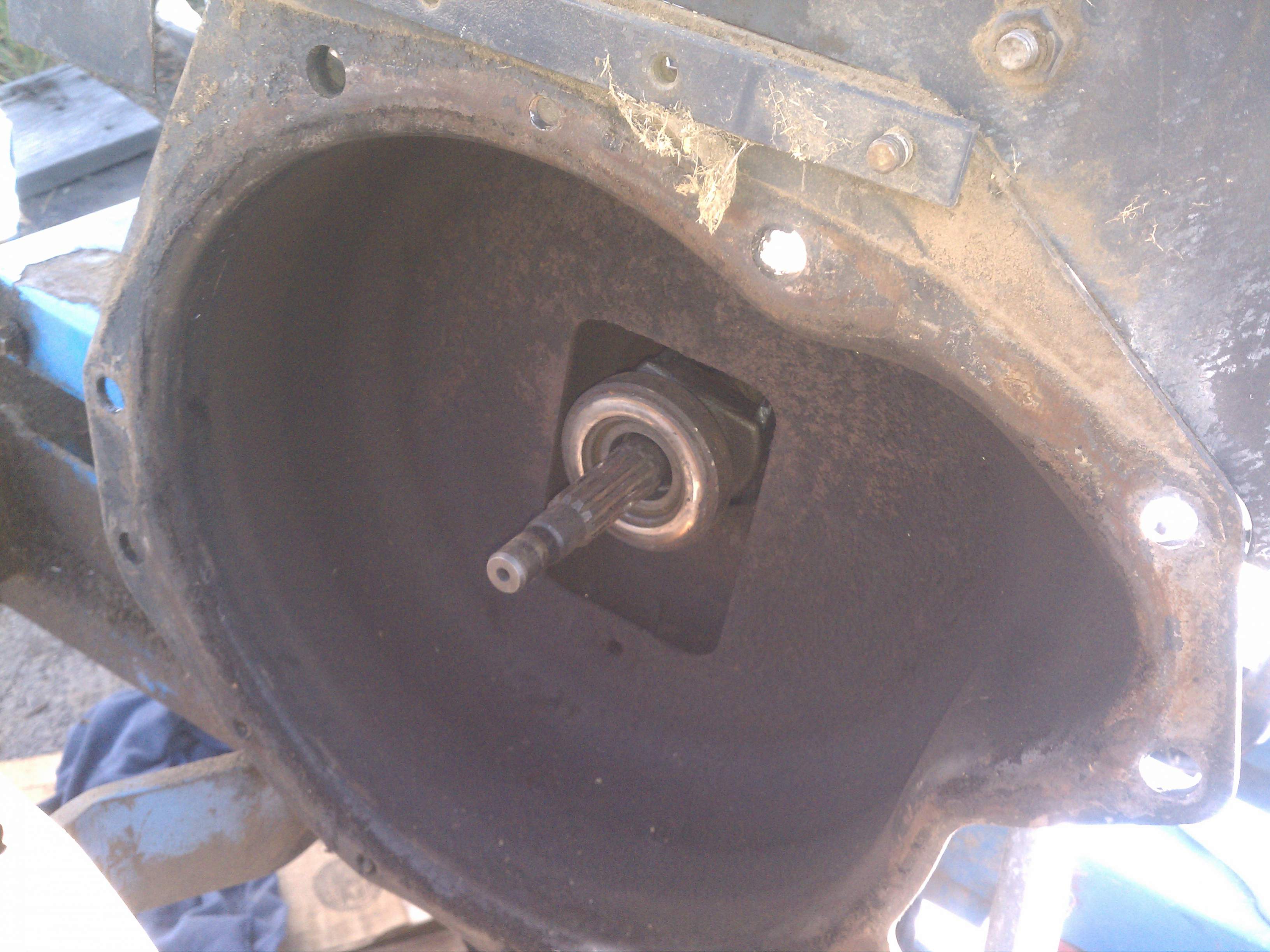

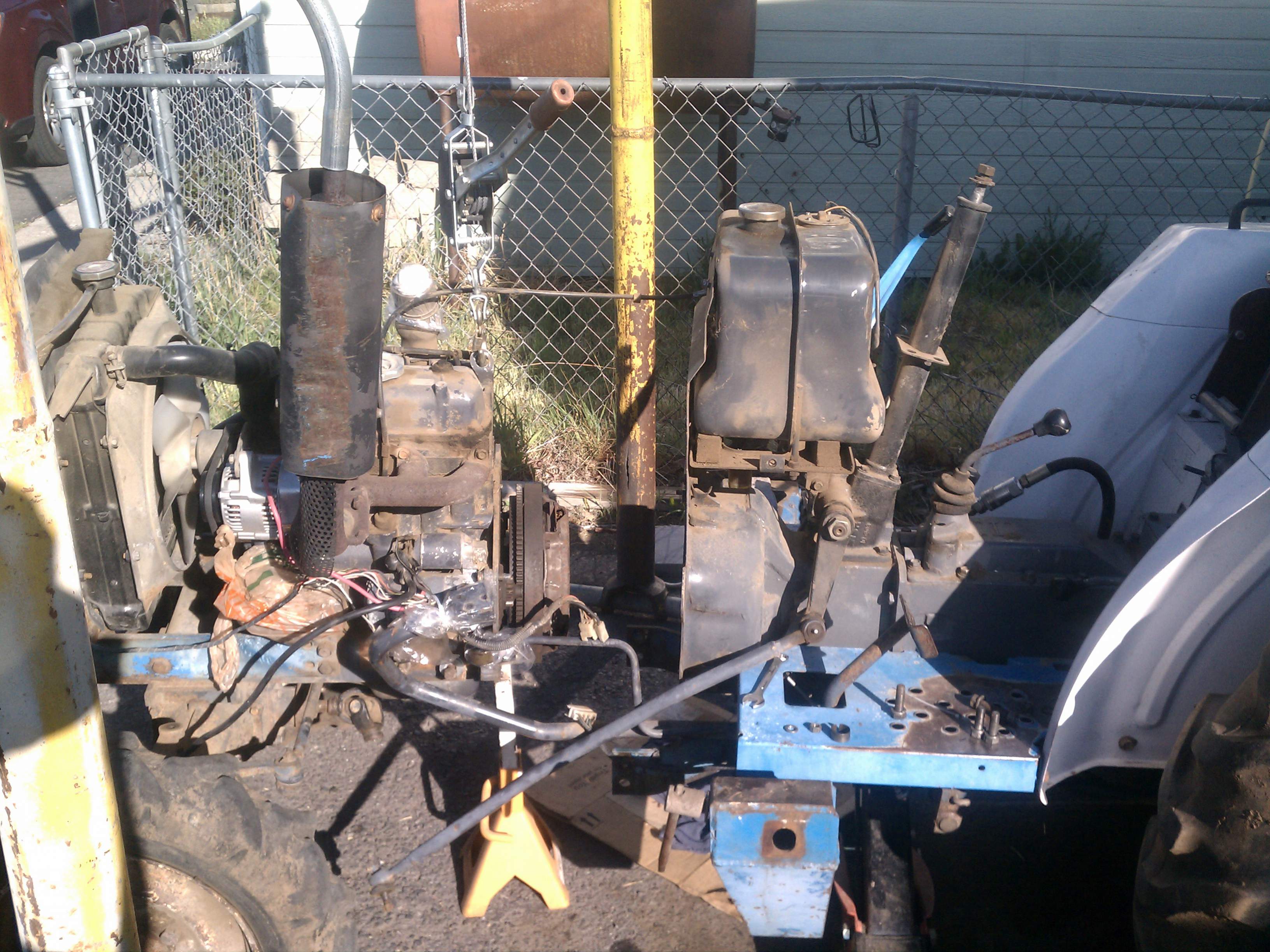

Ok, here's a couple pictures.
The hub spun 90° to it's proper orientation
The hub pulled out, and spun to the wrong orientation like I found it
A tractor split

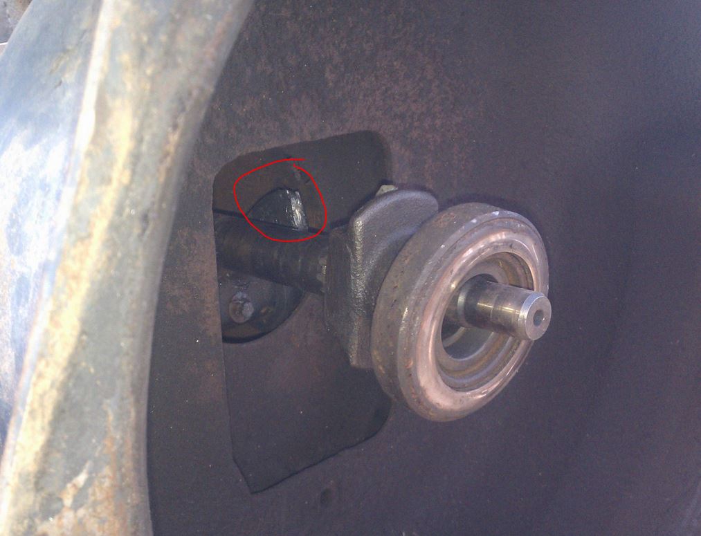

So what keeps it from happening again? Maybe it's just worn out. The piece I circled in the picture below looks work or broken. Hard to tell what it is.
/ Yet another stuck clutch (mt210D)
Yea, I'm really not sure what keeps it aligned, other than light pressure between the pressure plate and shift forks.
You circled one of the forks on the release shaft.
Edit: when the hub is slid back in place, it's square enough that it can't rotate. I can only see it rotating if the shift forks are full back, and the pressure plate is compressed. So, if the clutch rod breaks and everything bounces around for a split second... that just might happen.

D'oh! Like my pictures show, the throwout bearing carrier just spun 90ー, so the forks from the clutch pedal no longer moved it.
