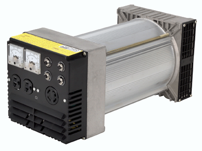

Back to the generator question. Been pondering getting a backup for some time. I've no objection to a PTO unit as far as the tractor itself is concerned, however seems a stand alone may be more convenient since I do not have a power source (spare tractor) to dedicate to it for extended periods, at least not now.
Was seriously pondering which way to go, PTO or small diesel, either way in the $1300 catagory when I came upon this hairbrain idea.
If I get a little 'Bota or some such for mowing, I find myself with a perfectly good Kohler Command Pro twin cylinder 25. Vertical shaft, cast iron sleeves, easy starting, strong running, 400 hrs, has never asked for anything but maintenance.
Harbor Freight has a belt drive 10,000/7200 watt belt driven generator head for $300. It would be relatively easy to fab up a frame mounting the engine and genny side by side with an idler pulley for tensioning. The engine has a fuel pump so the tank can be simple like a 3 gallon boat tank or something similar mounted low. I think the engine tachs at around 3700 so pullys would be one to one. The 25 should have plenty on power to spin the genny.
A thousand bucks would make a nice dent in a decent used BX. Is there anything obvious I'm missing in this fantasy?

10kw is close to 13 HP so you have all the HP required to make it work plus a good reserve.
Double belting would be a good idea but at least have a spare around.
Most ppl have a golf cart where we live, I am using it and a 36v inverter for back-up power :) but I too want a generator for longer runs.
/ Yet another generator quandary #3
Are you saying you already have the motor? and can you couple it to a genny head? That's what they are made for so don't see a problem.
The vert shaft may be something to deal with, not sure if the gen head is designed to run out of typical horizontal position.
Since you have more HP than needed, 2 hp/KW then you could gear down the motor a little. spin the motor slower for less wear and tear. the hard part is gonna be to spin that genny at 3600 rpm's consistently across all your load applications.
Good luck, JB.

Is the shaft drive for the genny head built for a side load.. IE.. a blet load.. or is it made to be coupled to a gearbox. if not meant for a side load.. the bearings will fail.
to get around that you coupld make your belt drive from the engine to a shaft supported by 2 pillow bearing blocks, then have that shft drive the head with no sid eload.
all depends on the head..

They list it as a belt drive unit so it should be designed for the side load.
It would not be too difficult to change the shaft orientation with a gearbox and mount the unit horizontal as intended, but if I start throwing money it kind of defeats the purpose.
Plenty of applications use a twisted belt drive design but I have no idea if this much power / short length could be made to work.

These generator head type units generally have good power charectoristics(sp?). They are WIDELY used for shore power applications in boats and 18-wheelers as hang-on models with a small 2-3 cylinder diesel. Many less expensive portable units use them as well. I wouldn't think twice about the quality of the power or using one as a remote power source.

Check with the manufacturer to see if it can be mounted vertically. Make a sliding bracket similar to how a front mount snowblower mounts and hang the generator off the front. Use a lever and rod to engage/disengage the belt by sliding the bracket forward or back (just like a snowblower).

That's an interesting concept. The mower drive pulley has an electric clutch. The mower drive belt is tensioned by a lever and spring assembly, removing the mower drive belt from the engine pulley is easy.
The hydro drive pulley is above the mower pulley so no issue there. Muffler is in the way but it's burned out and needs replacing. Hmm never had a lawn mower with a set of duals.:eek:
A little engineering on a quick mount with tensioner and this old girl might switch from grass to volts in under five minutes! :cool:
