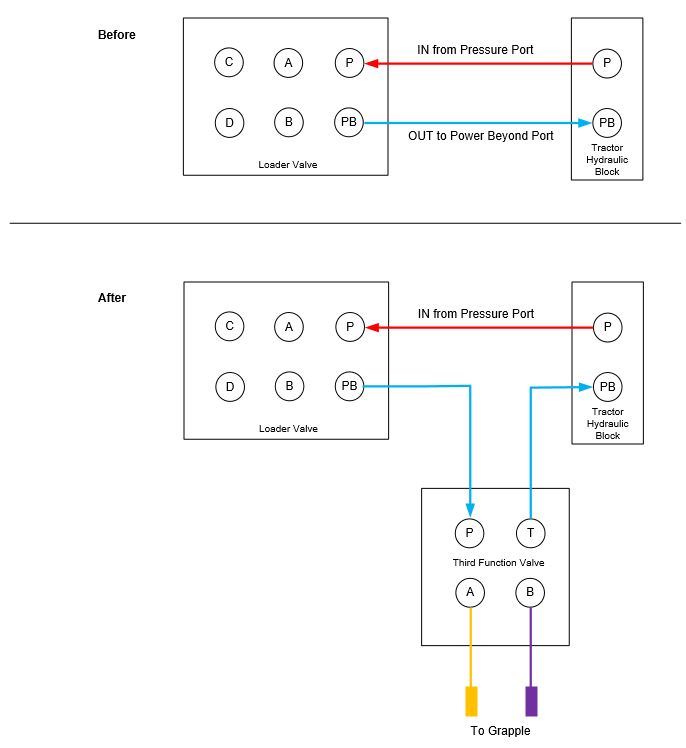

I've attached a drawing of how I think the plumbing goes. Seems fairly straightforward.

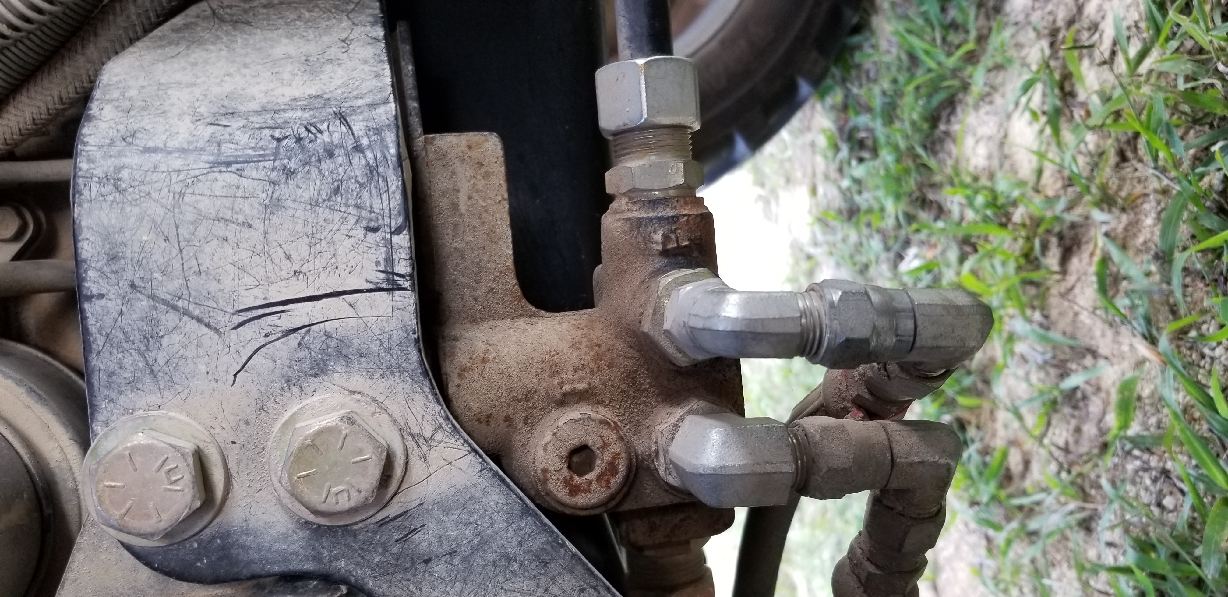

1. The Hydraulic Block on the 3316 has a Pressure port, Power Beyond port, and an unused Return port. For the Return port, the FEL manual states "this port is not used if you are only installing a loader to your tractor".
So, I can just ignore the Return port, right? (But I'm also curious when and how it would be used.)

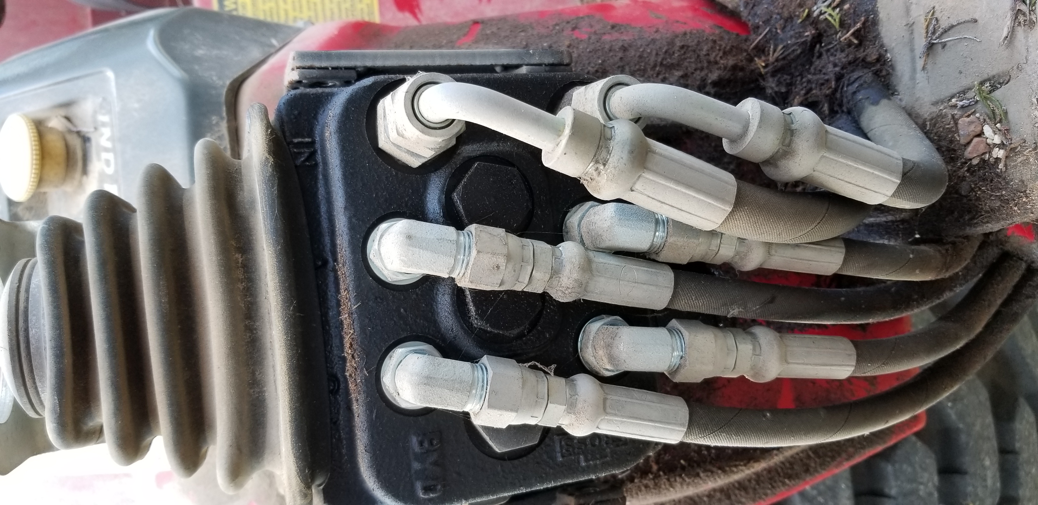

2. Some of the Loader Valve pics that I've seen in other threads have a "return to tank" port that is part of the puzzle. Not so on the ML111 FEL. Just In, Out, A, B, C, and D. Anything I'm missing here per my drawing?

I am not familiar with your system. However, if I were going to add a valve, I would make sure it had power beyond. Then take the hose that goes to the "In" port on the loader valve and feed the new valve first. Take the power beyond from the new valve to the "In" port on the loader valve. Next, go from the tank port on the new valve to the plugged tank port in your picture of the hydraulic block.
This way I would be certain not to create any issues with the flow of the loader valve.
Hopefully someone more familiar with your set up will give you better insight. Good luck! :)

What is the capacity of the loader? Your hydraulic diagram looks correct. Typically the loader is first after the pump, then other valves, then the 3pt because it dumps into the tank. I'm not sure the order makes a difference.

My concern is that there is not a power beyond on the loader valve. My thought is the line out is just return to tank. This is why I suggested putting new valve first. Of course I could be completely wrong. :confused3:

On the second picture, is possible to see a power beyond port marked as BYD. However can't quite see the port unless it is the one under the top left hose that looks like a plug.

Good point. I'll need to study on that some more.
I now understand that my drawing is incorrect. The ports on the loader valve are labelled IN and OUT, not P and PB.

Durr...I was looking for something labelled PB. I pretty sure that says BYD. I'll clean the grease off and double-check. This could be good news for me. Thanks.
   / Yet another 3rd function valve thread (Mahindra 3316 and ML111 FEL) #8
I see that now. However, I believe you would have to source a power beyond conversion plug for that port in order to power another valve.
If your new valve is power beyond ready, nothing has to be done to the loader valve. Just plumb it as I describe above.

That's great. I'll sketch it up and get back to you. Thanks again.
