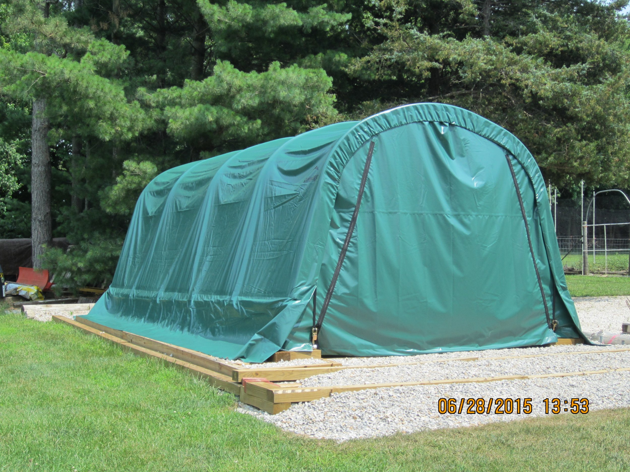

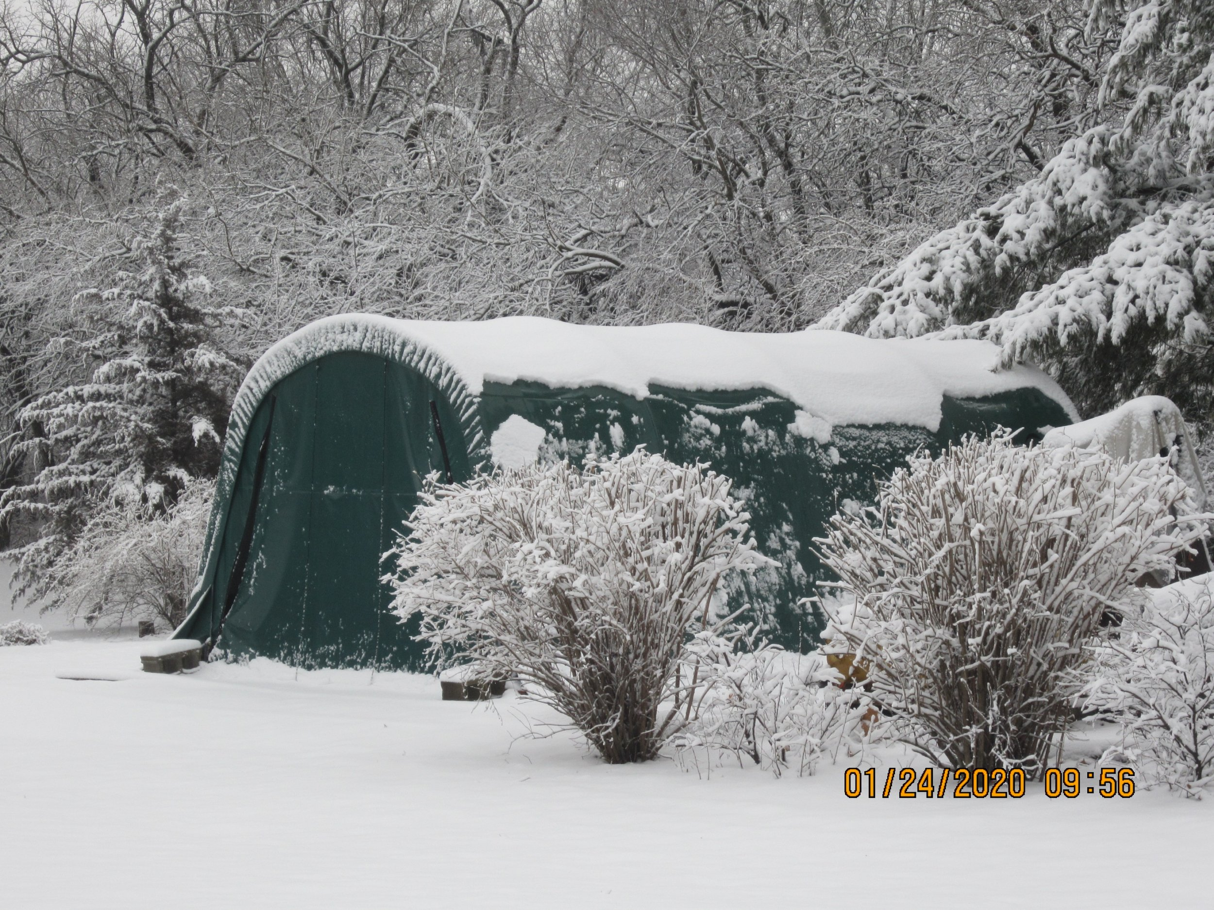

I have vehicles in two of these and both have lasted about 10 years....
We had one of that looked identical to that. Purchased at Costco. Lasted 2 or 3 years until the fabric got so brittle from the sun that it just started falling to pieces.
