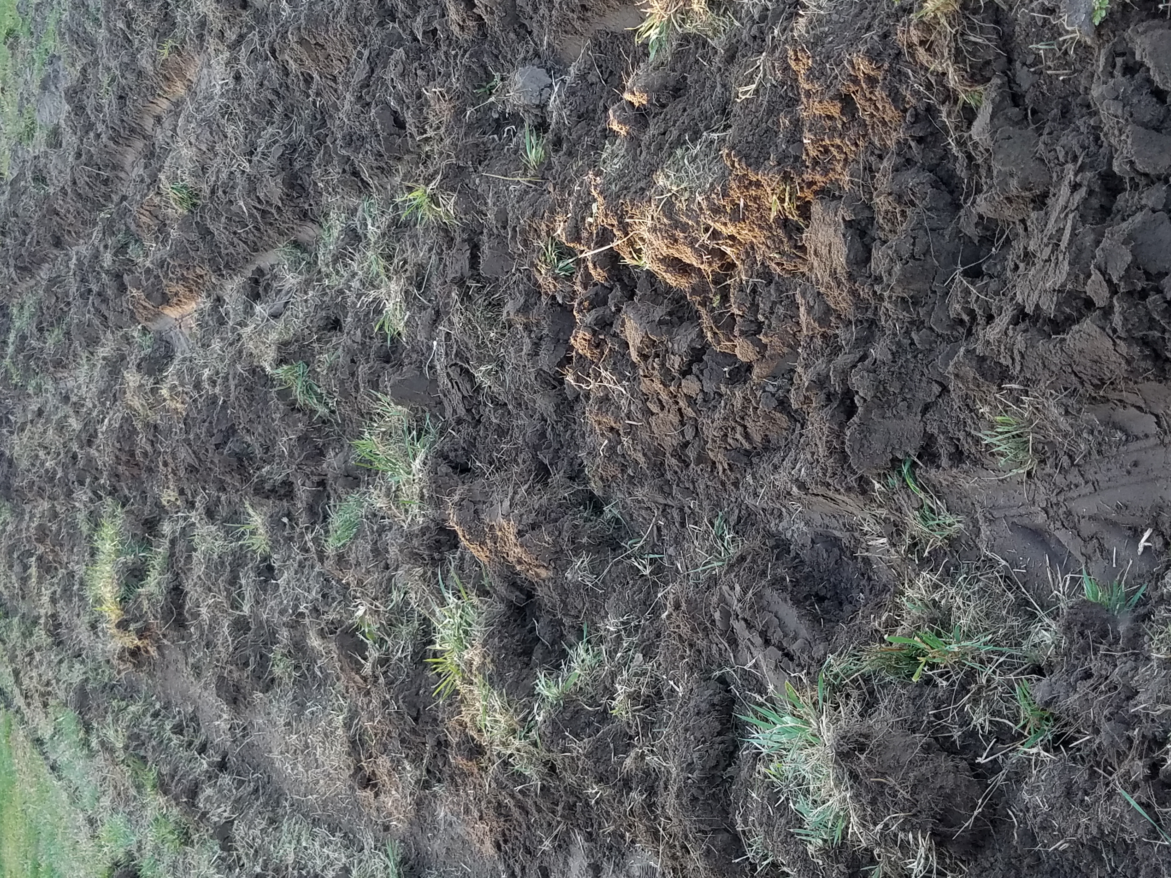

I wish I could get 2 furrows, so not gonna get it to the third one for a picture. I can occasionally get one furrow with a real uneven bottom, then I go back around and drop the wheels in there, and then absolutely nothing more times than not. Occasionally I can get it to go down some and then it either stays around 2 inches deep or it will dive to around 7 and pop both back out the ground. (This is without making any adjustments between the 2 extremes)
The plow seems to be in excellent condition, it was practically brand new when I got it. I do hear a pop sometimes coming from somewhere on the plow when I stop and pull it out the ground but can't trace it to where it comes from.
When I had the tractor on blocks, I had the plow completely unattached on the ground, and then adjusted the lift arms and top link to it to attach it. Is doing that going to make my measurements be that far off to work at all?

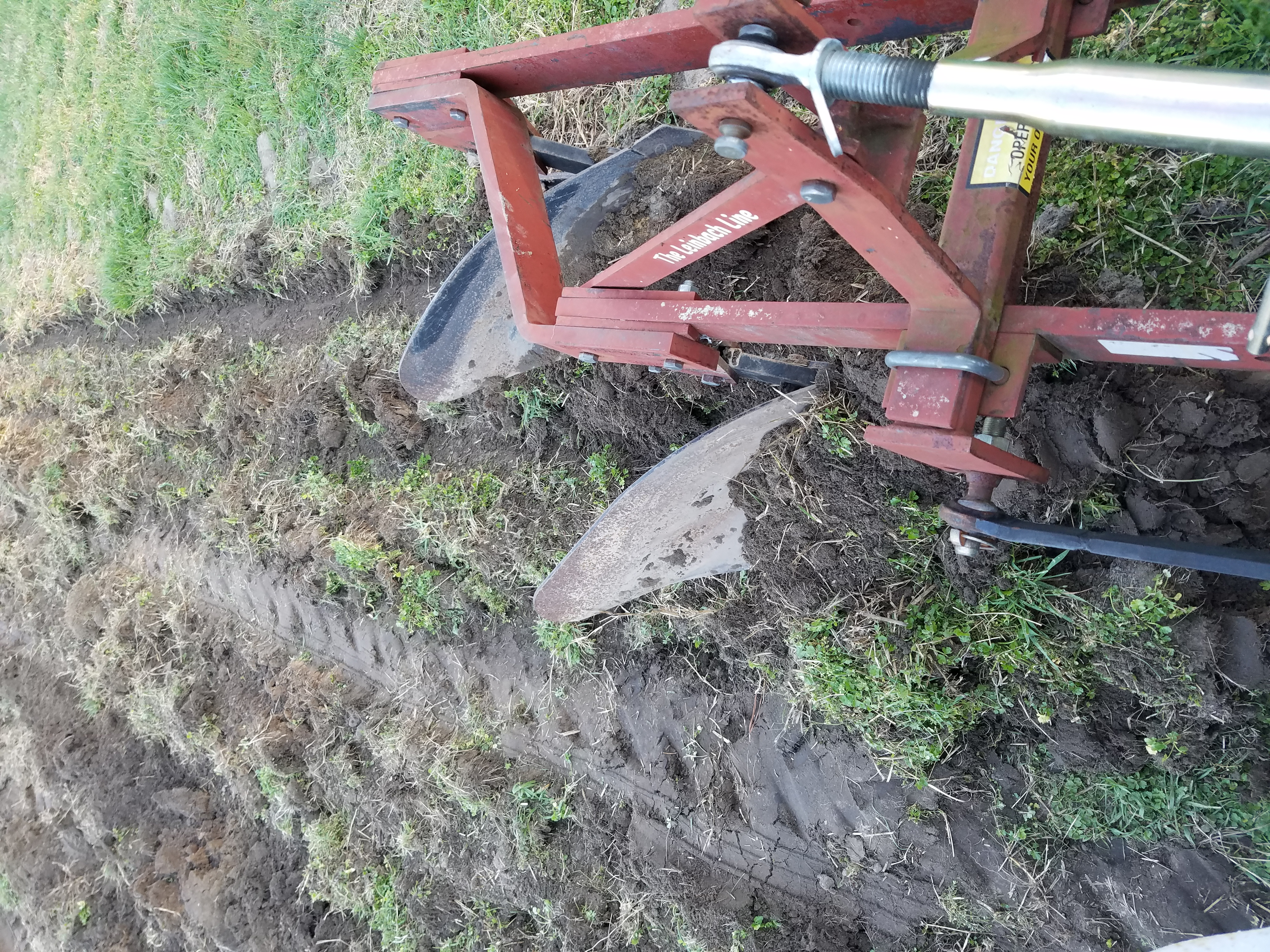

Here are some pictures. First one is with the plow in the air, second on the ground. Of the 2 pictures showing the quality of the cut, the one with me off the tractor makes the ground look alot better than it really is. The one taken from the tractor does it justice to show how horrible it really is. I'll add too that it still is pulling to left all the way, but my chains stopping it from going further, but the front plow is staying in correct position with where the furrow wall should be.
While your right wheel is in the furrow, Lower your right tractor leveling crank until the plow drawbar is parallel with the ground. Then post a picture from the side view. Ken Sweet

How old is that plow and what make is it. The first thing I noticed in your picture is your point look like they are wore very heavy. I have a Ford 16 inch and my points are much longer in front of the mold board. To me it looks like you need to adjust the top link and the right side looks like it is trying to cut to shallow

The pictures I posted in post 6 is of virgin ground that a year prior was untouched for 8 years. Only 3 bushhoggings over the course of a year.
I ran about 400' of tile in that acre and a half. There my trenches were, was bladed, and disc'd to smooth before plowing. Everywhere there was a trench, the plow only cut 3-4" depth. Not the 7-8" that I was getting elsewhere.
So had I done the whole area, I'd expect a plowing depth of 4" rather than the 7" I got. So I am glad you weren't around to advise I do that.
And yes, discing will make the plow "pull" easier, because it's gonna struggle to maintain depth.

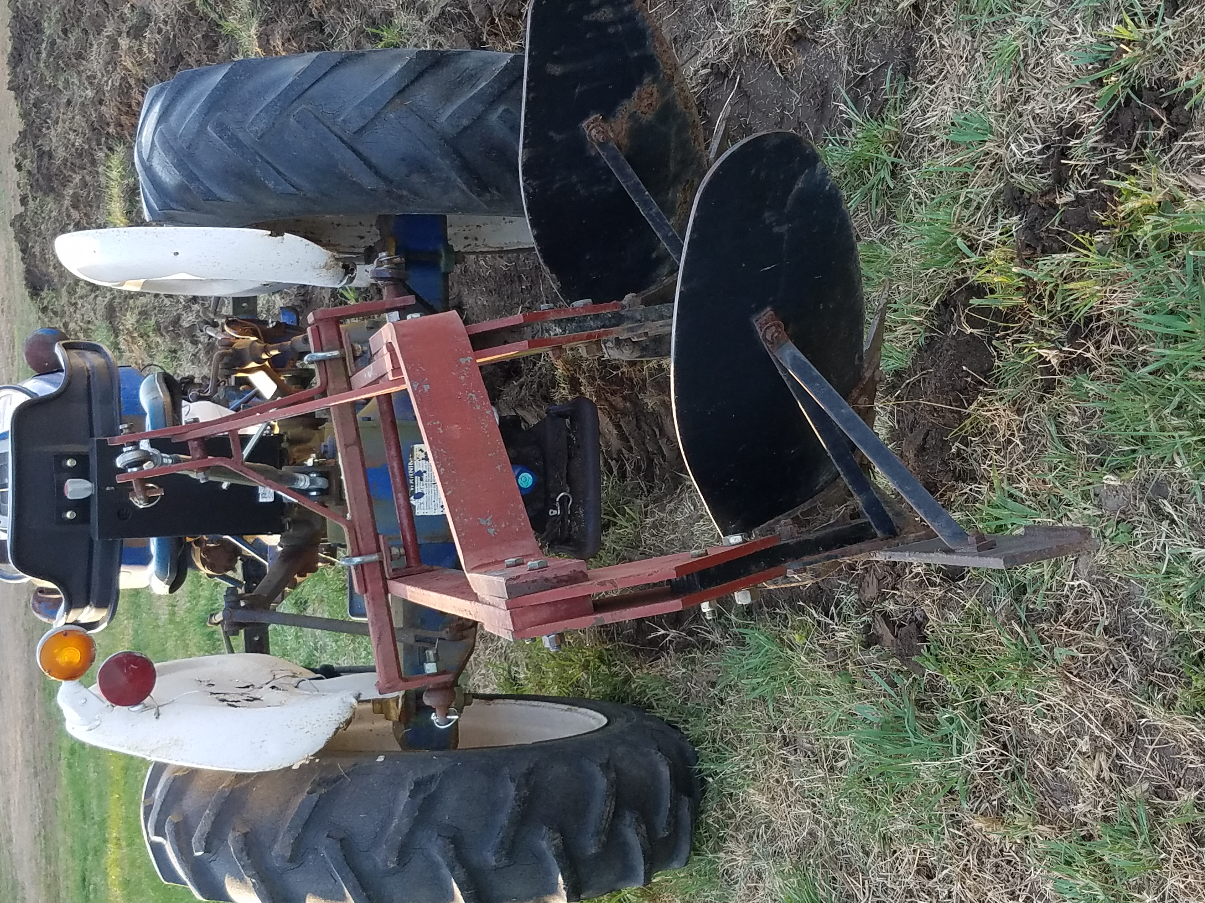

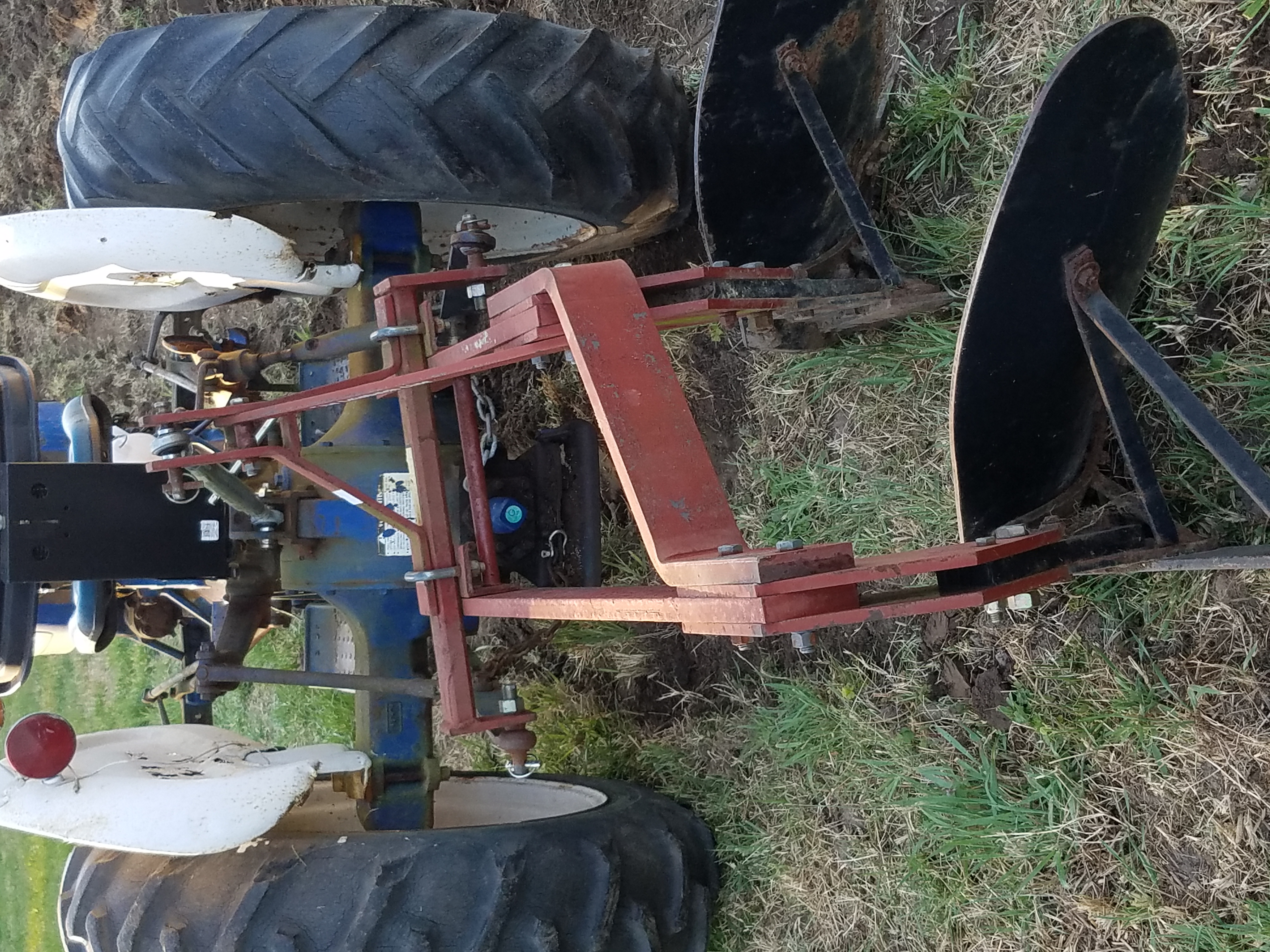

If you look at the one picture of the plow while facing the rear of the trac the right hand side looks to be to high and it looks like your plow is swing to the right. Try turning the furrow side adjustor deeper so the plow levels out. The sod in our picture should plow under nicely. The only time I would run a disk over any ground to be plowed is when it had tall grass. I plow some 2 years ago that was a cow pasture and had not been plowed in who know how long. Move your draft control lever up and see if the plow moves up. With the draft control of the plow should dig to China

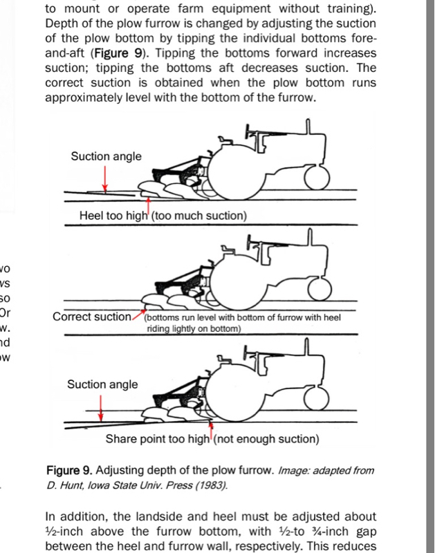

It looks to me that it's mainly a depth issue. 14 inches? If so I'd be going 6 to 6.5 inches deep, then adjusting the plough to be level when it was in to depth with a bubble level.
The sideways adjustment will be mainly (but not all) to do with setting the front furrow width when properly set up, so with a little bit of LH steering.. it will be same width as the other when you're in the furrow. I think it's about 3 inches deep from your pictures.. you really shouldn't be able to see any much of the boards.
