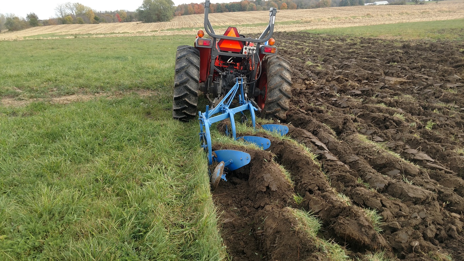

As some may remember, I played **** last year trying to get my Double bottom setup on my Ford 2000 and pretty much ended up having to wing it in the long run to have a decent seed bed. Well, this is the 2nd year I've had it now and can't get it set up for the life of me and am getting nowhere and I can't figure out if it's me or the equipment.
When trying to set it up tonight on concrete for the first pass (with both plows level), I noticed after I picked it up and set it back down to verify it's alignment, it was slightly different than I thought I had set it up.
I then noticed that my leveling arm has a little bit of play when lifting up on it before the lift arm "engages" and begins to lift at the same rate. (This is being done with no attachment attached at this point) Is this normal for that to be the case or do I have an issue? If it is an issue, could that be why I can't set this thing up to save my life?

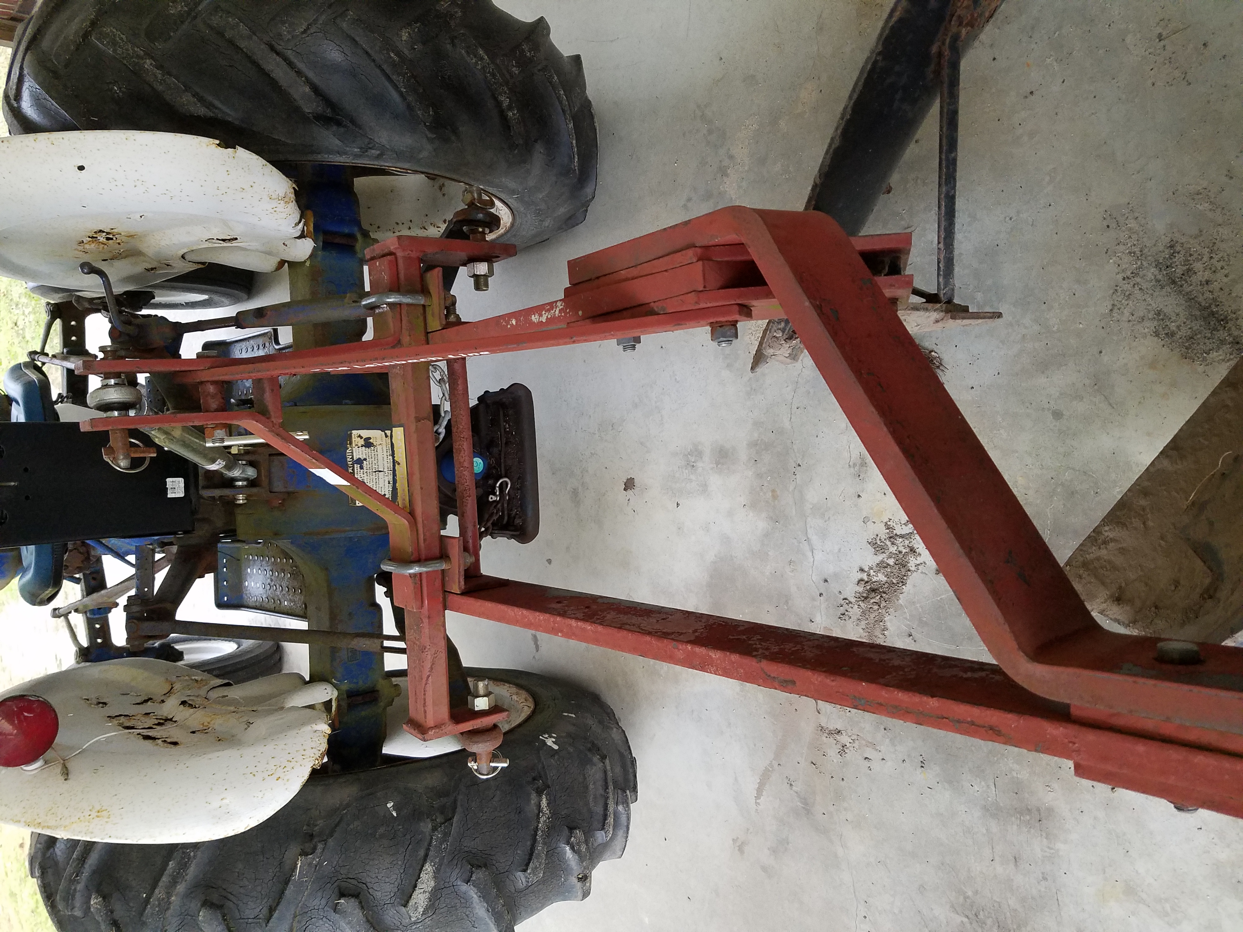

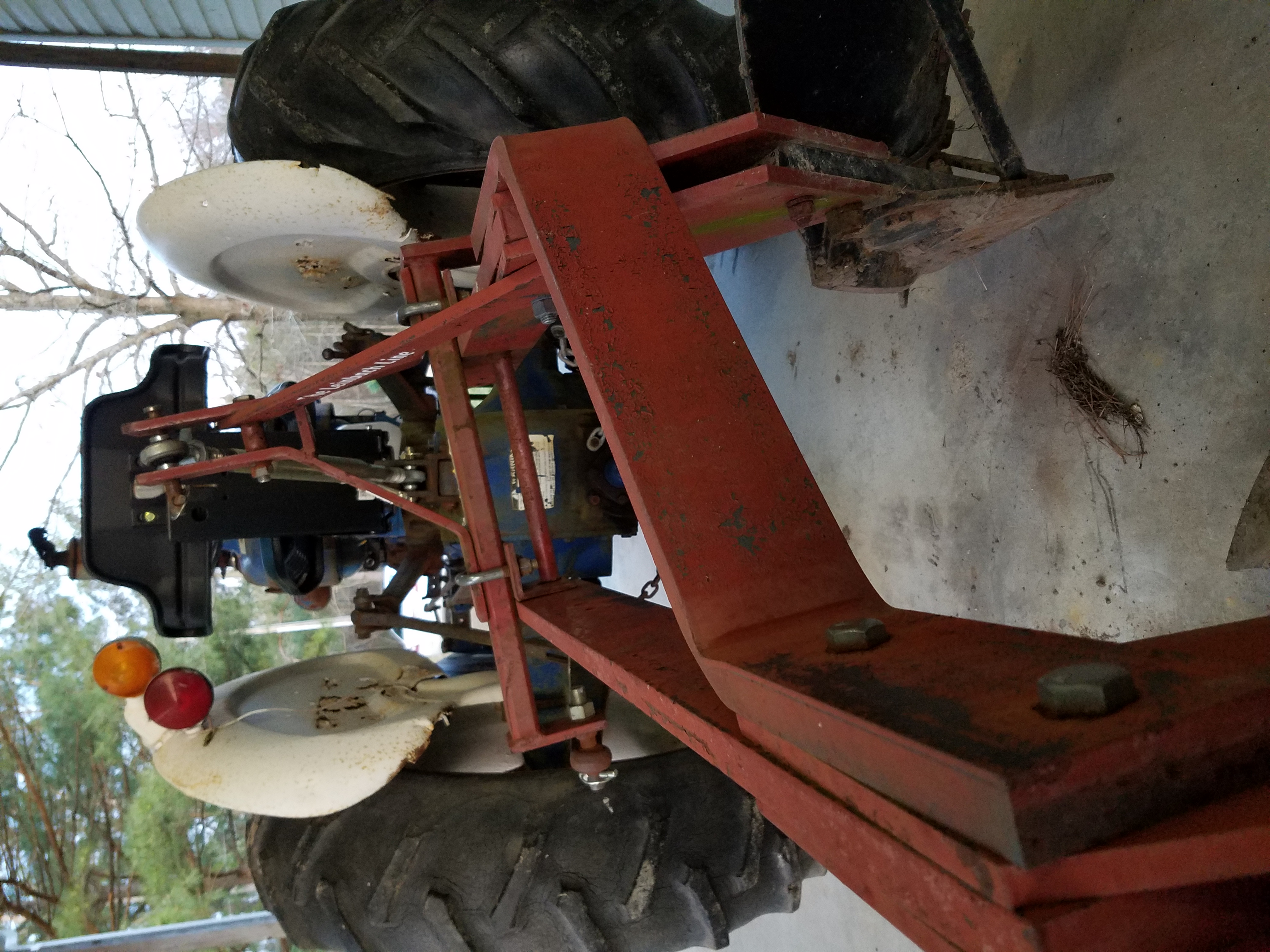

I was looks over your posts from last year and happen to notice something , may just be the photo angle , but it appears the right lift pin is mounted farther forward than the left. It also appears to have extra holes that the pin can be mounted in for adjustability , if so I'd try moving the pin back so it's in line with the left pin, see if that helps your sideways pull.
I would also think the adjustable center three point arm should be more in line with the plow frame. Check that the plow frame is square lengthwise to the cross member.
In the attachment note the difference in the cross member. It can be rotated for adjustment.

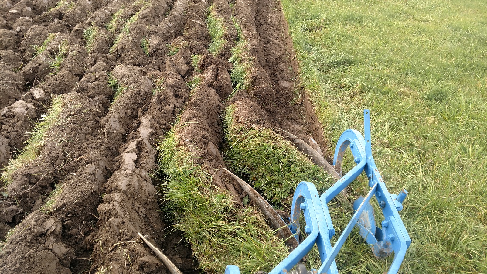

As now, I don't have any issue with it pulling to the left and it appears to be perfectly in line with the tractor with the right pin in the center position. The issue that I've been having is getting both plows to go down to the depth that they should be along with both plows doing equal work.
I reset up my plow on concrete with the left side of the tractor on blocks and compared the new measurements to what I still had written from last year, and it's pretty much the same measurements that I started with this year. Theyre Double 14's, so to my understanding they should be running at about 7 inches. With the blocks I had available, I could get it to 6.5 inches. Both shares sit flat to the ground with the landslide perpendicular to the ground, so all appears to be good there. Don't know where I'm going wrong, it seems like I'm doing everything right.

An issue I have with the plow set up is the alinement of the plow in the photo in response # 4 above. With the lower 3 pt arms allowed to shift a large amount, left of right, it is naturally going to shift to the left and has done so in the photo. Your first bottom should be turning the first 14" from the furrow wheel but has shifted to the left and is trying to turn the first 20" or so. That shift has effectively lengthened the right lower arm of the 3 pt and shortened the left lower arm. The top link is shortened and brought the back of the plow up. I believe you need to stabilize the 3 pt arms to a position similar to your later photos to maintain that 14" cut by the first bottom. I'm not sure if the proper way to do that is by additional stabilizer arms or if it can be done with the chains to the hitch. Some of that side shift torque or draft can be alleviated by a tail furrow wheel per LD1's example, but he also has lower arm stabilizers which hold the correct alinement. Its been 50 years since I ran a full 3 pt 3 bottom plow and that was on a J. I. Case with non-swaying lower arms and you had to add a little left turn to counteract side draft on it. Hope this helps.

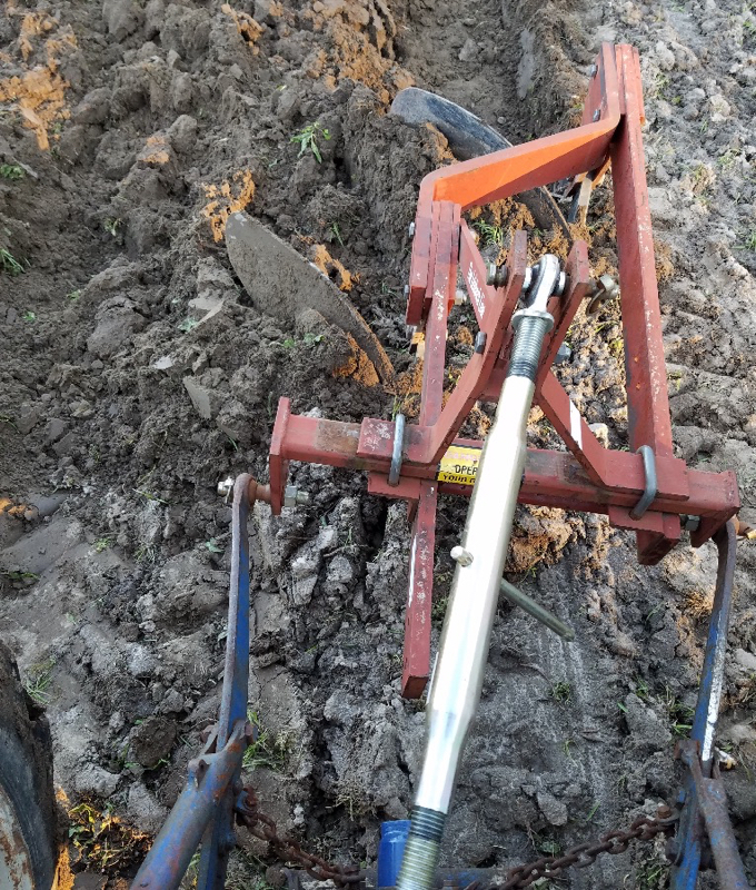

The attachment seems to be missing.
This time it worked. To the OP; your problems may be in the cross member attachment to the lift arm. In the photo you can see how rotating the cross member would change alignment. Your plow seems fixed which may not be the position for your plow & tractor. .?

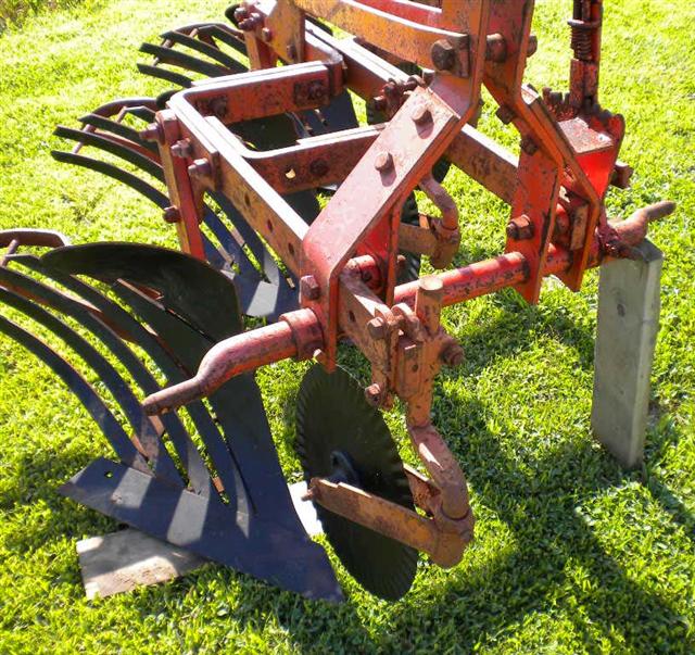

Not to hijack,
Never seen a plow with slotted (finned) moldboards before? Whats the purpose?

Egon, you are correct. Most newer plows do not have the rotating crossbar and cannot be fine tuned like the older plows. With a plow like the op has, you can never get it set perfect, however, you can turn ground with them. Ken Sweet

My cross bar can't be rotated, but it can be adjusted side to side and also has 3 holes to fine tune the alignment with. I currently have the pin set to the center hole.
