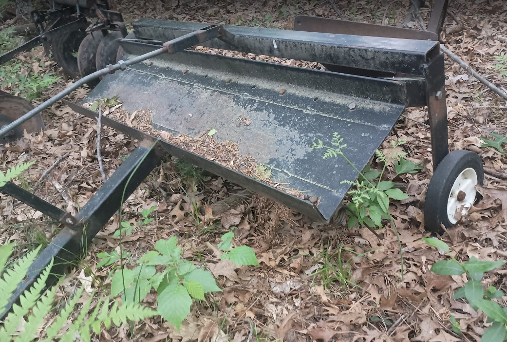

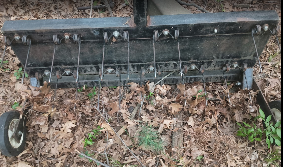

I made my own dethatcher many years ago to pull behind my lawn tractor. I used baler/siderake tines bolted top a u-channel I welded up. It is heavier than the homeowner styles that are for sale. I hate raking, so I use this on my wooded lawn. It does pretty well collecting the sticks and debris (a few slip through, but not many. Here it is.
I think your pine straw work will work better if stiffened up with a horizontal board(s). Otherwise this
