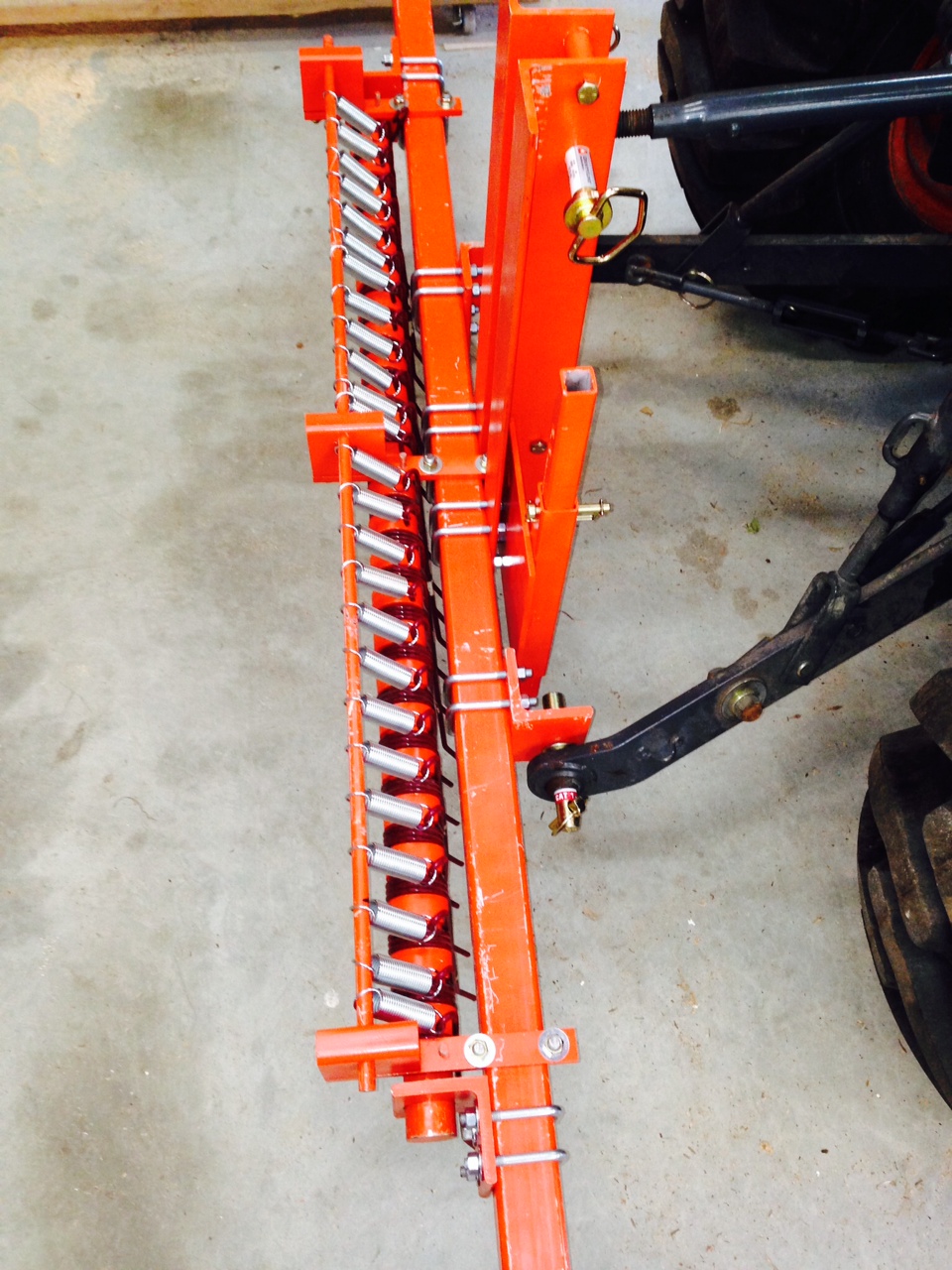

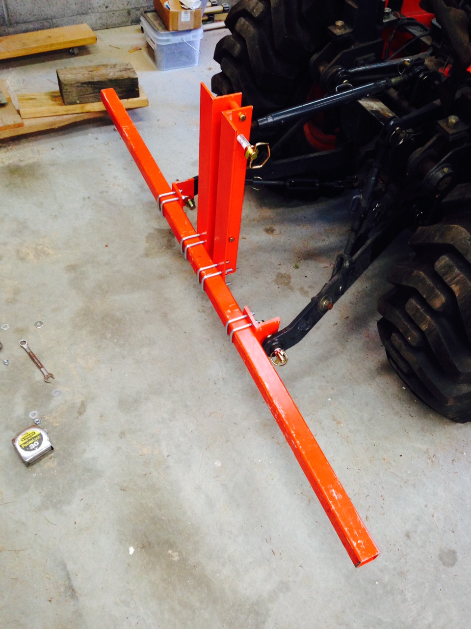

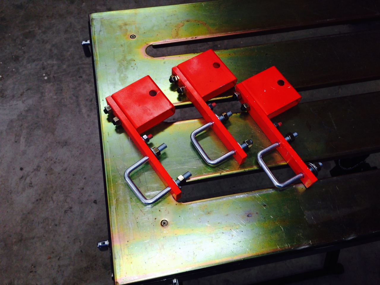

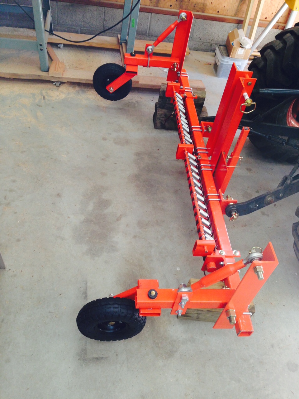

I've been looking at rakes for a while. Didn't find one with the features I want so built it.
1. Tool bar assembled to three point hitch. It can be offset either side for raking close to a fence.
2. Tool stand installed for easier hookup.

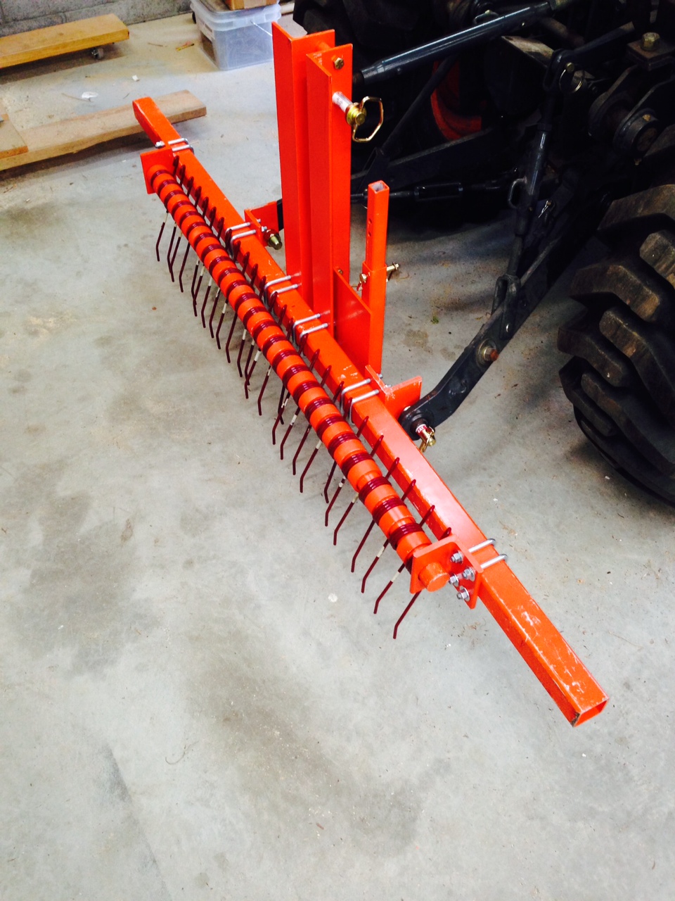

3. Rake teeth assembled on rake bar and attached to tool bar. It is 48" wide for use between trees and bushes.

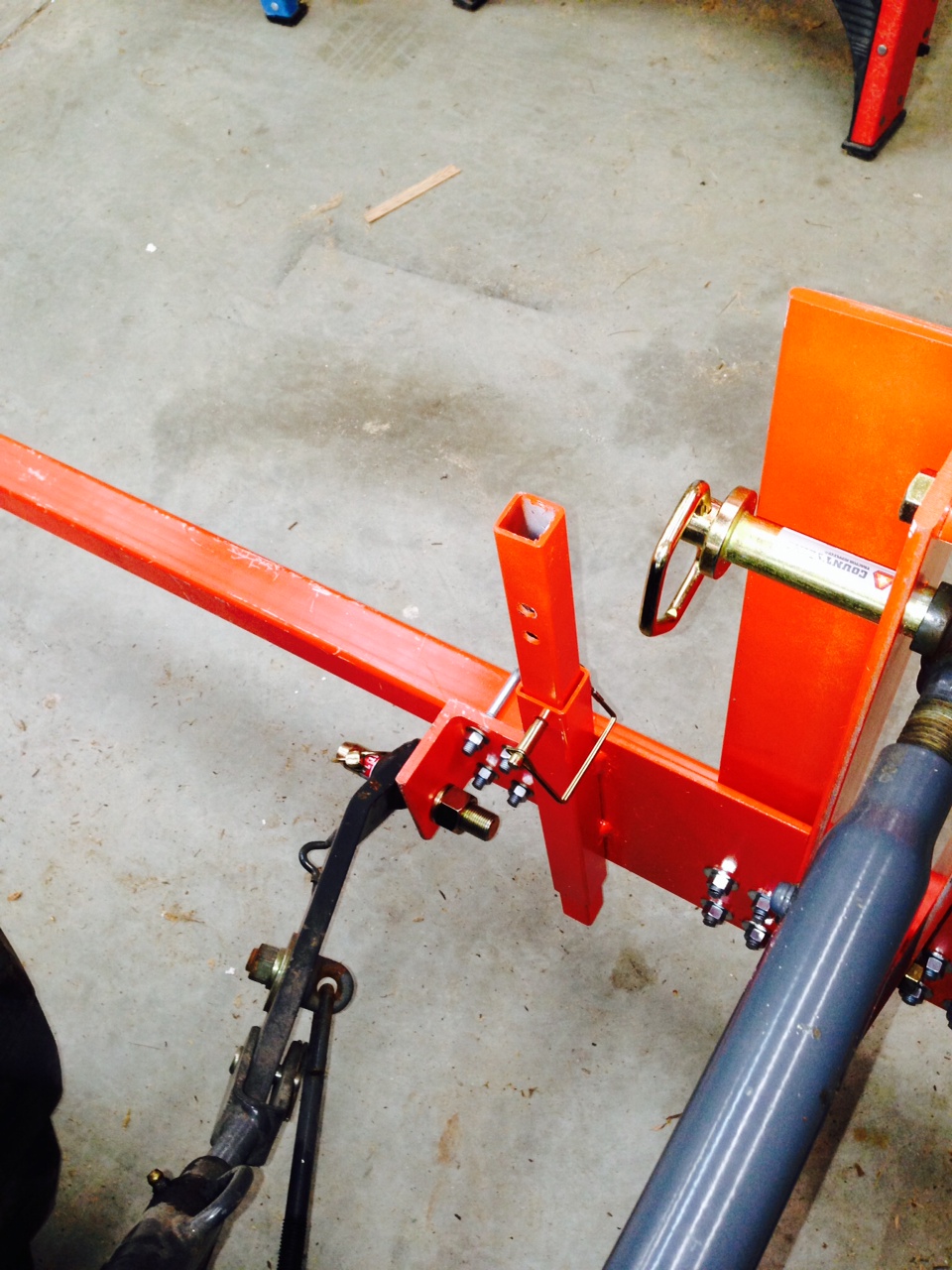

4. Brackets for mounting secondary spring assembly.
5. Secondary spring assembly attached to rake. The 26 individual springs allow the bottom of each rake tooth to move 3" side to side and 4" front to back. This allows the rake to follow uneven ground. When the small springs reach the limit of their travel, the stronger spring built into the rake tooth takes over.

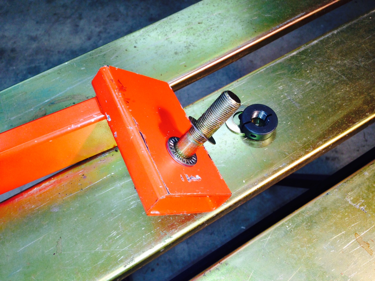

6. The gage wheel uses needle thrust bearings at the caster pivot point and a threaded collar, which can be adjusted just right and locked in place.

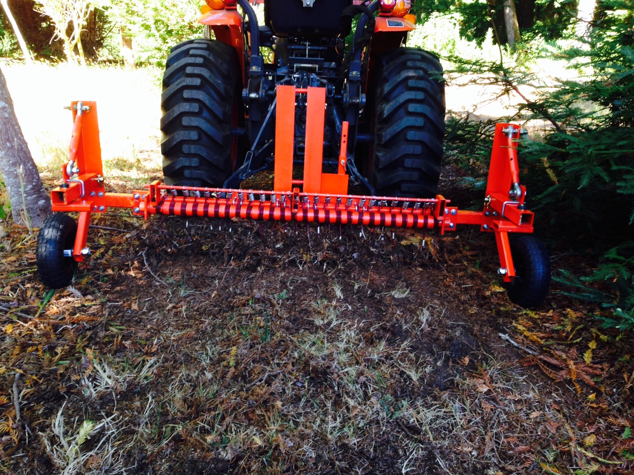

7. Gage wheels assembled to rake. They attach with pins for quick removal when operating without gage wheels. They are adjustable so rake action can vary from mild to aggressive.
8. Rake in action. It works as planned.

The adjuster links are store bought. I was in TSC buying the draw pins and still puzzling how best to make the adjusters. Right on the rack next to the pins were these little top links. A bit pricey at $30 but an easy and good solution to my problem.
/ Yard Rake Home Made #7
Ah, they are short top links for a compact tractor?
Nice solution :)

Work Of Art! You might as well file the police report now, because your design has been stolen by now. One question. With the rake bar clamped to the tool bar, could the rake be swapped for other tools to utilize your gauge wheel system? This could be the start of a multi function tool with any number of mutations.
#11
Yes you are right. That is one reason I built it that way. Next yard chore is reseeding so am thinking how to cheaply and simply make a verticutter to be assembled to the tool bar in place of the rake.

I took another look at you build. It looks like it all bolted together. No welding. Any reason for that?
I do see in one photo you have a part on a welding table.
#13
There are three things welded.
Gage wheel caster frame - 1x2 wheel carrier cut at a 45 and welded to short length of 1x3.
Lower tabs for gage wheel height adjuster - the pix show these with u-bolts, I was experimenting with best location. They are now welded to the 2x2 locating arms.
Tool stand - 1 1/4 tubing welded to 1/4 inch plate.
Those three things had to be welded. The rest is take-apart. Either for maintenance, or because I might want to reconfigure into a different tool, or because I wasn't sure it would work and wanted to be able to re-do easily if need be.
