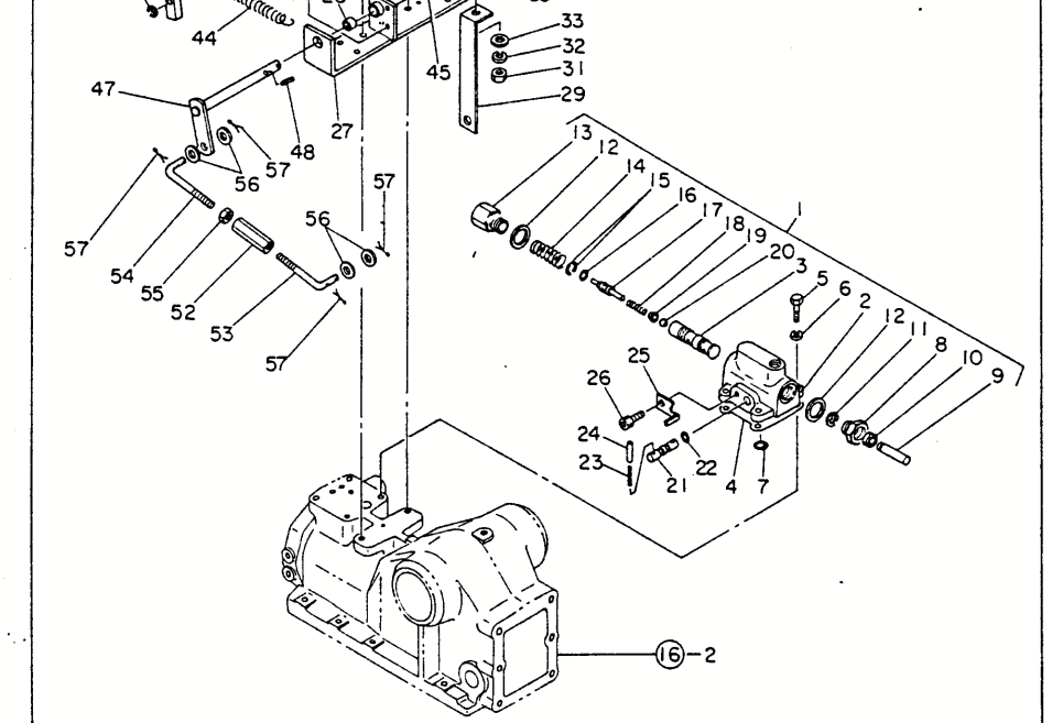

To me, disconnected means "removed". So, as the pipe is clearly there, open on one side and loosely plugged with a rag, what is on the other end of that pipe? The hydraulic reservoir?
All the best,
Peter
Both ends of the pipe is disconnected. It just stays there, because its hard to remove/take it out.
   / Yanmar YM3000 3 Point Hydraulic #12
May be correct, but I have never seen the spring hooked on the air breather before.
   / Yanmar YM3000 3 Point Hydraulic #13

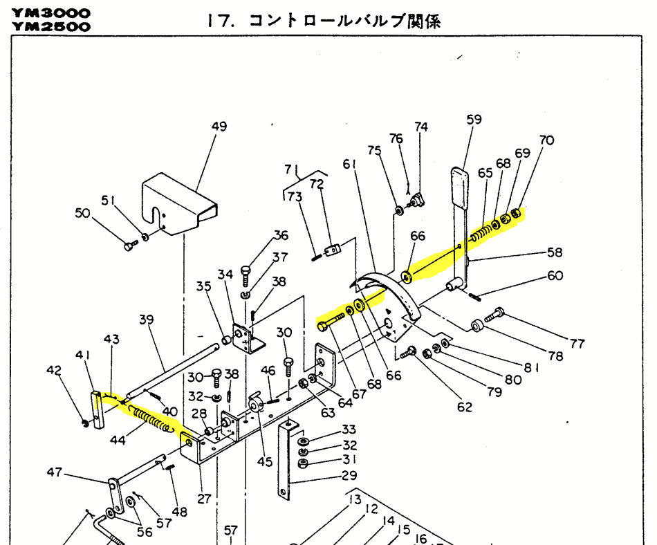

From the parts manual section 17,
#14
Interesting, in my case part 41 is welded to 39 could be the problem?
