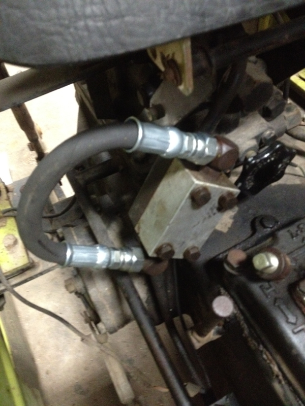

New to this tractor thing, the father-in-law just gave us a Yanmar YM240D. The tractor runs good but the hydraulics don't work and one of the metal hydraulic lines on the YFL-240 loader is broken completely in half.
1. do I need to replace the hydraulic pump?
2. Can the loader lines be bought new or will it have to be rebuilt/repaired?

One of my hard lines was replaced by a piece of flex hose at that location. It works fine and this obviously is an easier fix. Estimate $25 to have a short hose made up for you.
Troubleshooting: loosen the fitting at the hydraulic pump output (smaller line) and see if anything comes out. (Caution - can be high pressure, dangerous, stand clear!) More likely it is what we just saw described in another thread here, a problem back at the control valve and/or 3-point lift piston.
About the only thing that kills these pumps is deadheading it, running against a closed quick-disconnect etc where there is no pressure relief valve in the circuit. And that isn't likely unless somebody modified something.

Welcome I was the one bout a month ago with a 240d w/ what I thought was a bad pump. Make sure that under the seat the pressure line block has a jumper hose connected when the loader is not hooked up. I will send you a picture of what I had to do to get my 3 pt working.

   / Yanmar YM240D
Thank you! I do still have the loader on the tractor, but maybe I could try something like this for the interim until I get the line on the loader fixed..
