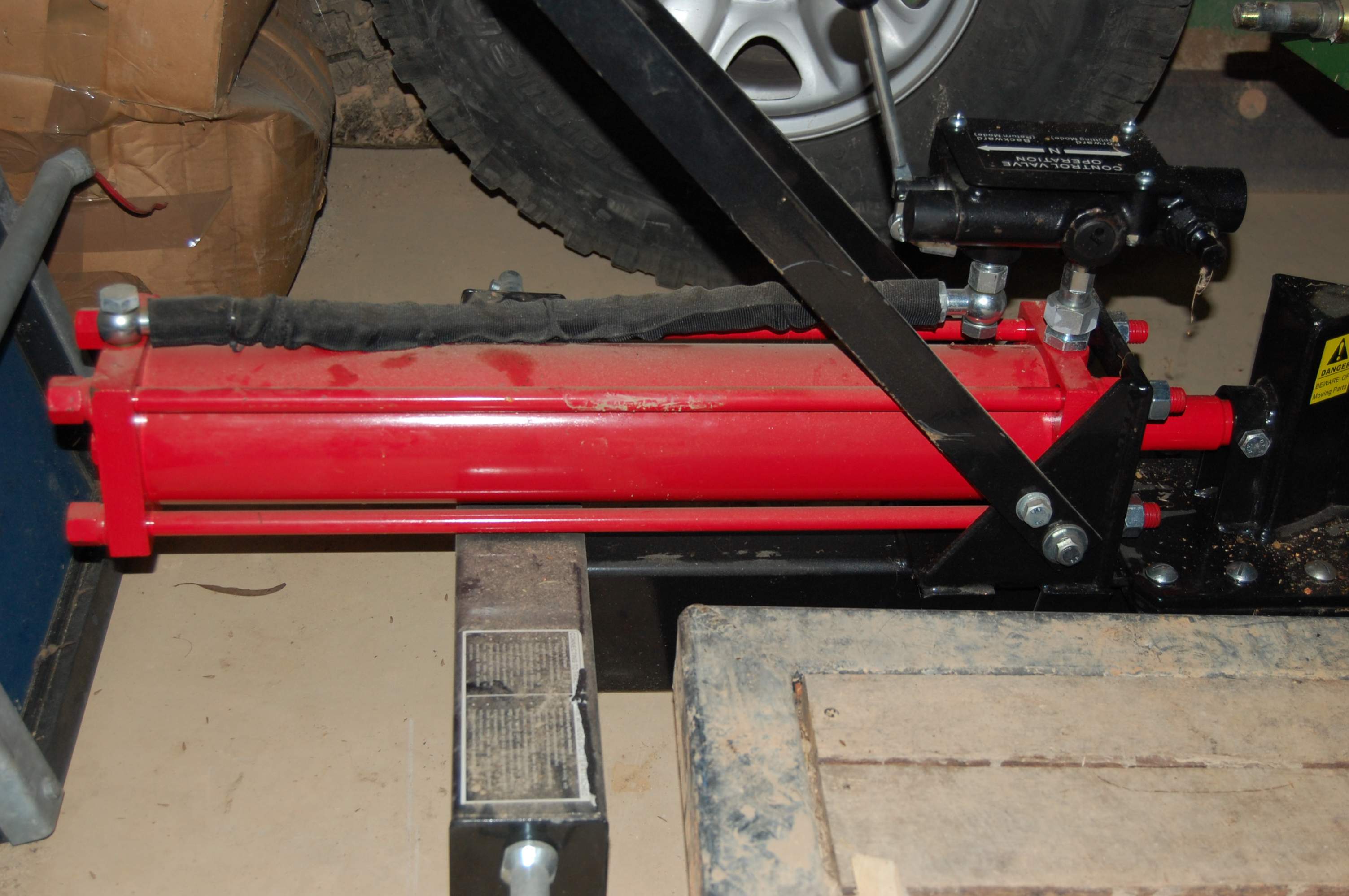

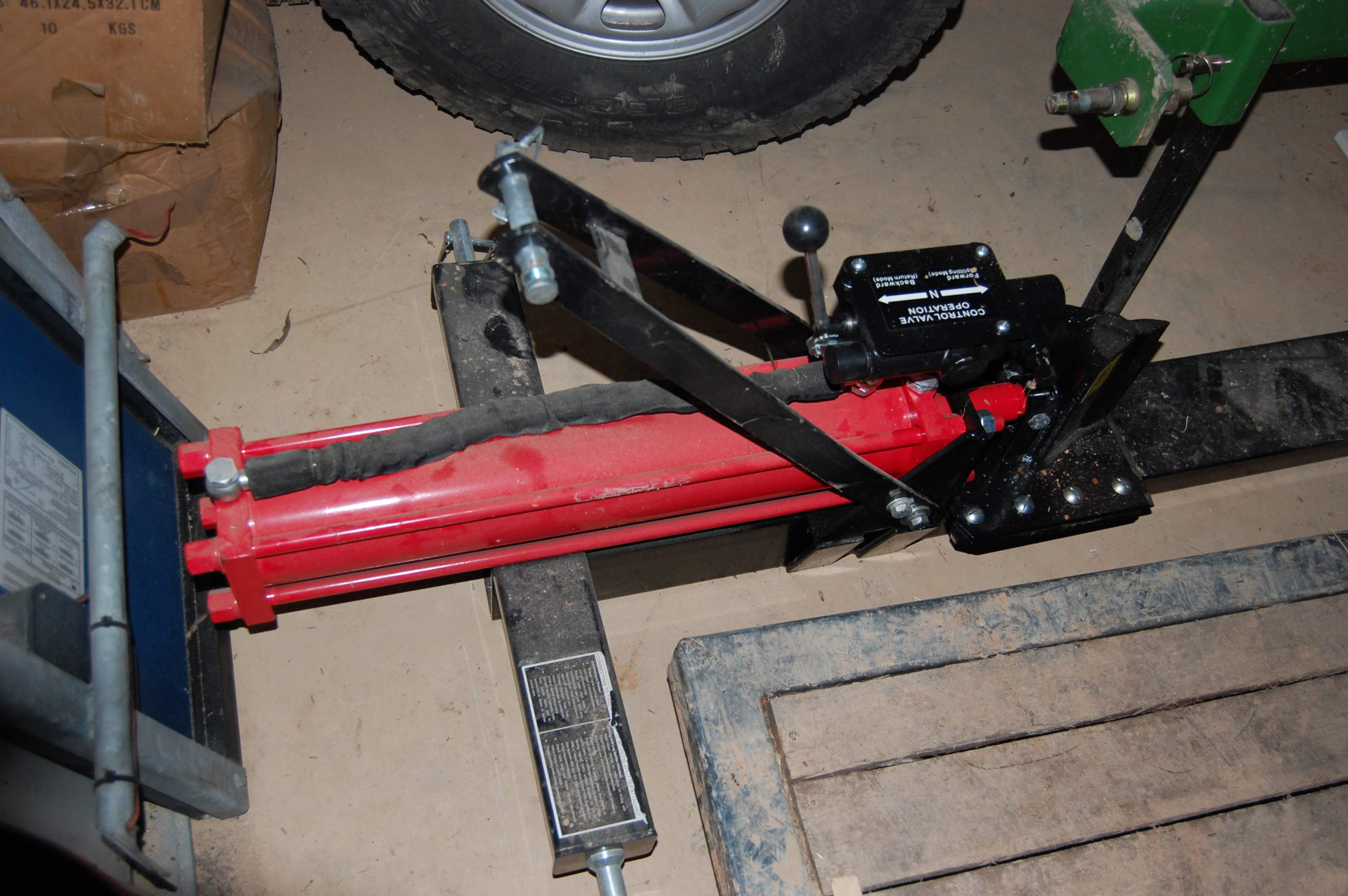

i have a 14 ton splitter, have had for more than 12 months but still have not plumbed it up so i cant tell you yet how well it works. :cool:

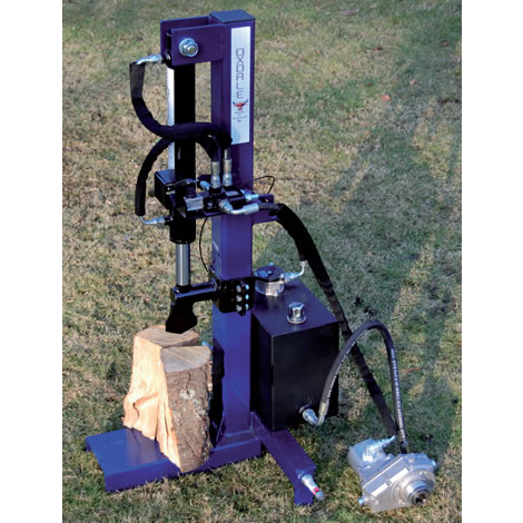

i wanted one and think i posted on attachments the pic of one i found. one they said the price was to high for it, which i really wasent asking but it looked pretty normal sized for a splitter, and they said the same i have about 2.5gpm and it would take something like 30 to 45 seconds to cycle the thing at operating speed! and most folks high idle when using a splitter, which u cant do.

I think pressure is going to be more important than volume in priority these tractor pumps are about 2200-2500 max psi. JJ can give you more info than me on specifics but I converted my 5hp 3000 psi 2 stage splitter to tractor hydraulics last year.
A pto pump will be the way to go imho and you will need a reservoir or use the one thats on the splitter now.
Granted it works and does what I intended but it is slow and the power is down quite a bit from the little gas engine that used to run it. hth
