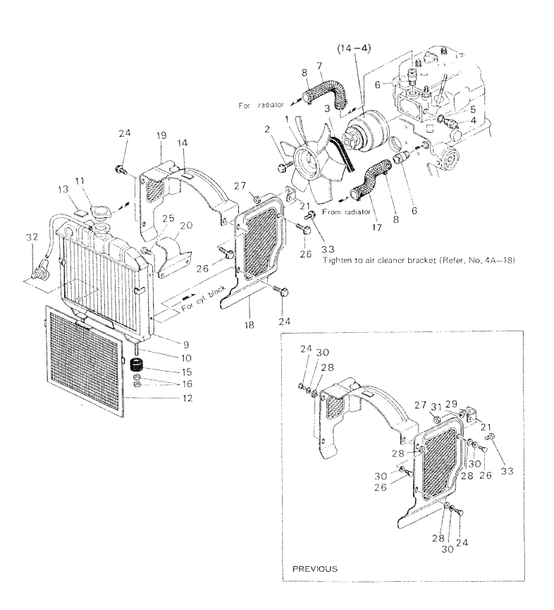

In the process of putting my old YM135 back together, I've put together a list of parts. Some of this info is scattered around on the Internet, but some of it is info that I had to figure out on my own. I figured that putting all of this together in one place could help someone else.
Part NameOriginal Yanmar Part #New Part #Notes
Cooling Water Joint (radiator hose connector)124160-4948084736Available at O'Reilly, Advance, and NAPA

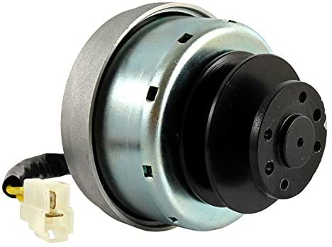

Alternator (external rectifier - for 4-wire rectifier/regulator)124660-7799110941NWAI brand
Regulator (replaces 4-wire design)121520-77710CH15589Search for a regulator for a YM220 or a Deere 650. Also used on Kubota and Grasshopper.

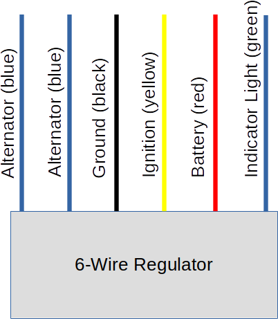

My YM135 was missing its alternator when I bought it. The YM135/YM155 came with either a 3-wire regulator or a 4-wire regulator. Both types had two wires coming out of the alternator. The difference between the two is that the 3-wire setup had the rectifier (diodes) built onto the back of the alternator, while the 4-wire setup had the rectifier (diodes) built into the regulator.
Rather than trying to source a (rare and expensive) "3-wire" alternator, I decided to convert my tractor over to a "4-wire" alternator. I picked up a brand-new alternator on Amazon for $73. Also, I made the decision to go with a 6-wire regulator - because they are plentiful and cheap. To make this work, I ran two new wires from the regulator to the alternator. These wires connect the two leads coming out of the alternator to the blue leads on the regulator (polarity doesn't matter on these). I also ran three new wires from the regulator to the starter (battery), ignition switch, and ground. This setup requires a good ground! I didn't use the indicator light wire on the regulator.
The 6-wire regulator bolts right up under the dash, using the original holes. If you want to use the 6-way plug on the regulator, search Ebay for a Kawasaki or Honda regulator pigtail.
This converts the YM135/YM155 over to the same system that the Deere 650 uses.
