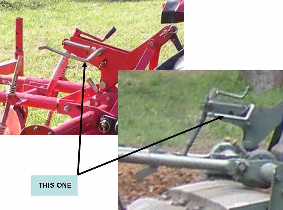

Mickey_FX, The only lever turbopiper can be refering to is the one that releases the whole guage wheel frame. You discussed it earlier in the thread. None of the pictures or diagrams of the special top links that I've seen show any levers that can be actuated by the operator, so I assume that's what he is asking about. I just thought you did a better job of describing it than I could do, plus you had pics.
Yes, this is the lever I was referring to.
http://www.tractorbynet.com/forums/attachment.php?attachmentid=100372&stc=1&d=1208226375
I'm still playing around with the tiller and the soil is getting a real workout. :)

On my tiller the top crank controls the tiller depth and the side lever frees up the whole wheel assy so it floats on the ground but does not control depth.
On the special top link, it only controls the "rotation" of the tiller as it is lifted and insures the tiller doesn't hit the rear tires.

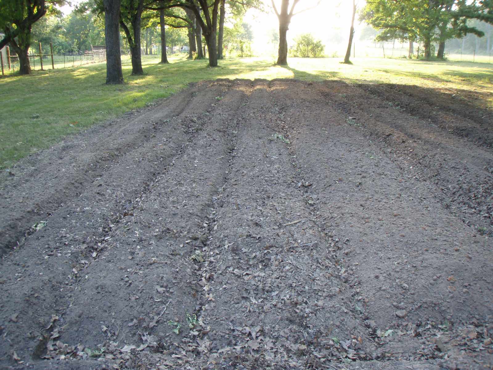

I was playi... experimenting last weekend with the row widths and I overlapped each tilled row by half, creating two+ foot wide rows instead of one 4-5 foot wide row, and the last row was the full width of the tiller. Has anyone ever done this? Is there an advantage to doing it this way? The wife liked it and mentioned it would be easier to water with the narrower rows.
This is our first garden of this size as you can tell... it's about 50x25, maybe a little too big, we'll see.
This is what I was talking about with overlapping the rows. Is this a weird way of doing this? Does anyone have a picture of their garden to share?
Ted
http://www.tractorbynet.com/forums/attachment.php?attachmentid=100419&stc=1&d=1208305727
