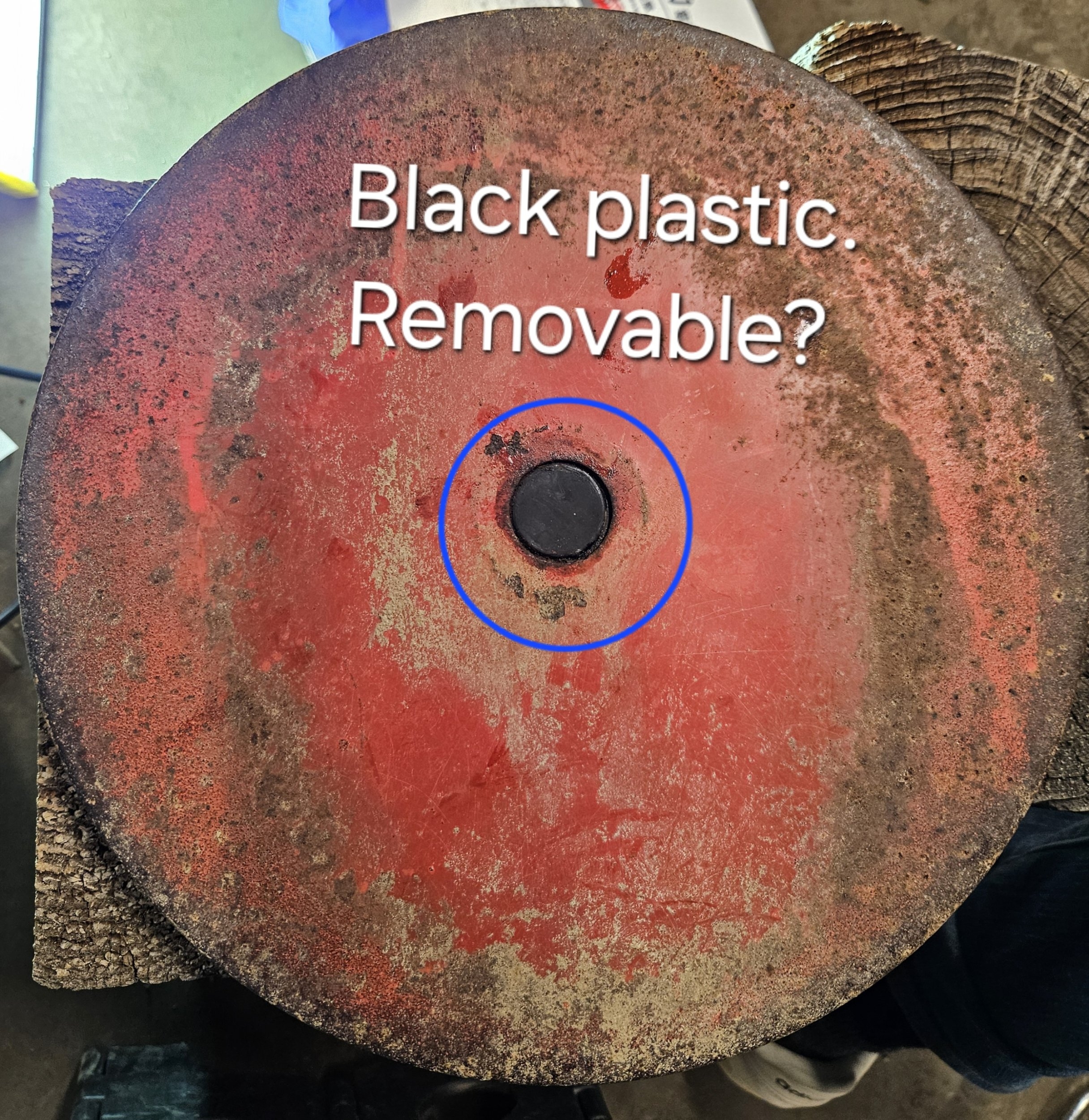

I have an F15D Forte with a RSA1201 auto tiller on it.
Currently, I'm in the process of changing my rear axle seal.
While in the process I thought I'd address my gauge wheel that isn't turning.

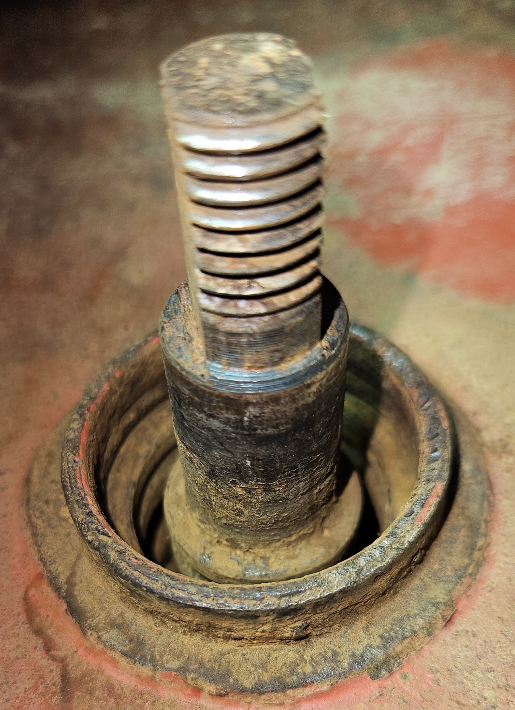

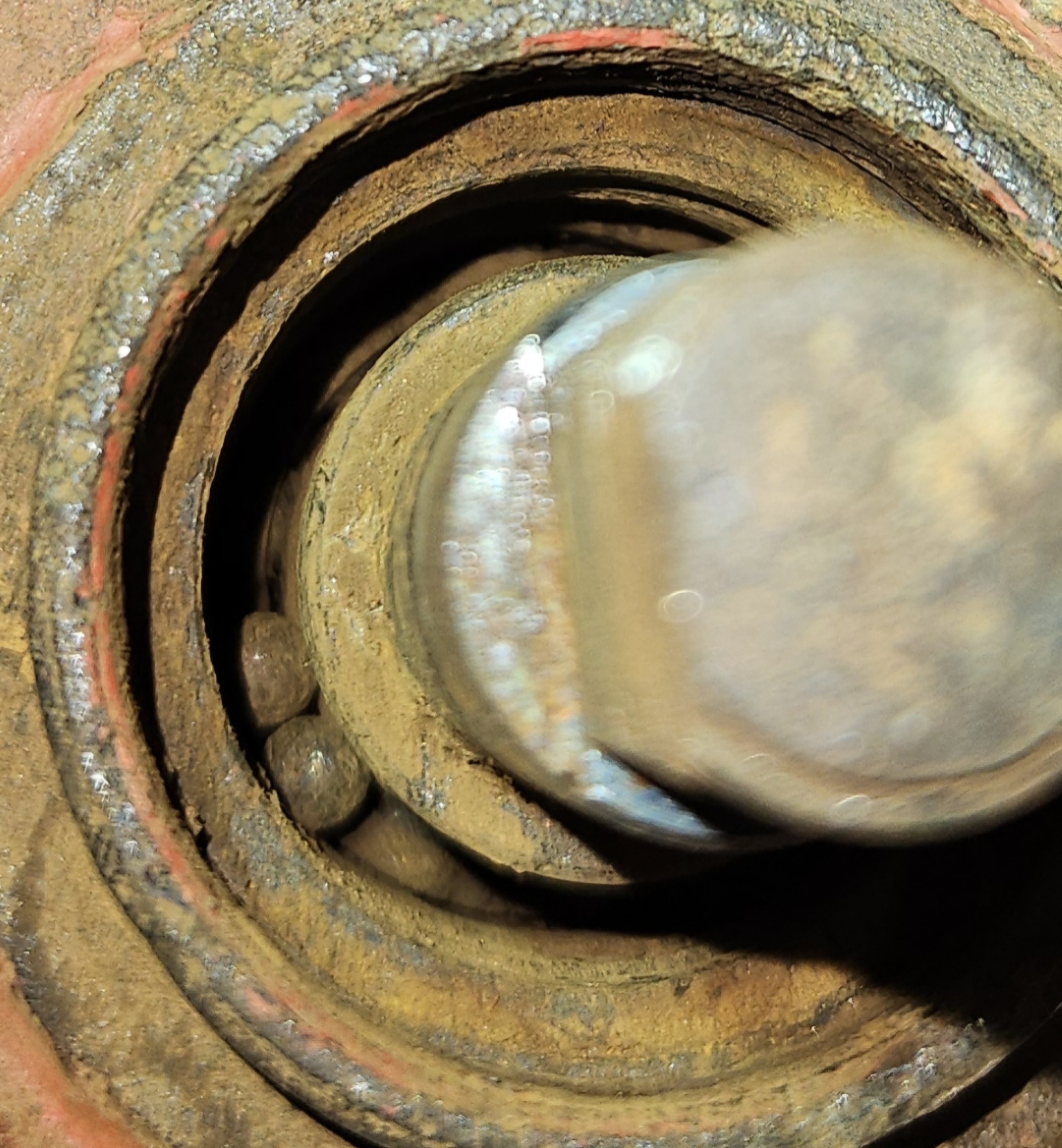

I started the disassembly process but I'm currently stuck at this point as the shaft won't come out. I'm assuming there is a clip behind the black plastic part but I wanted to check with others before I attempt remove it.
Has anyone changed their gauge wheel bearings before? From my research, I know these gauge wheels don't seem overly popular but I've used them to help with my lines and depth and they have worked well for me so I'd like to continue to use them.

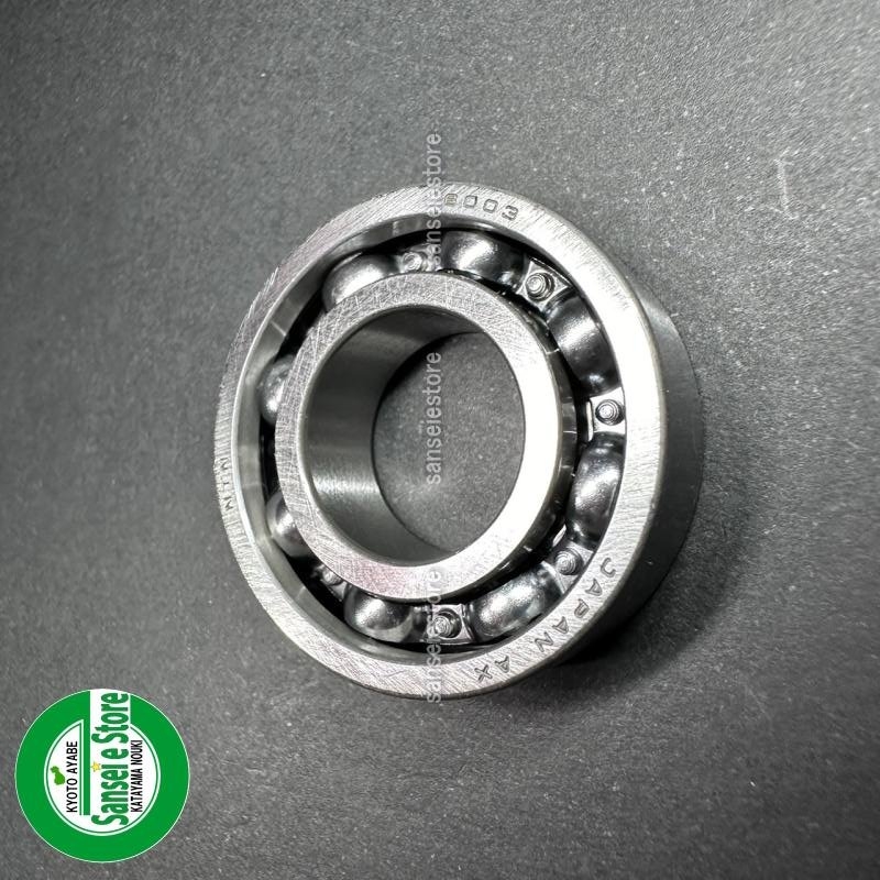

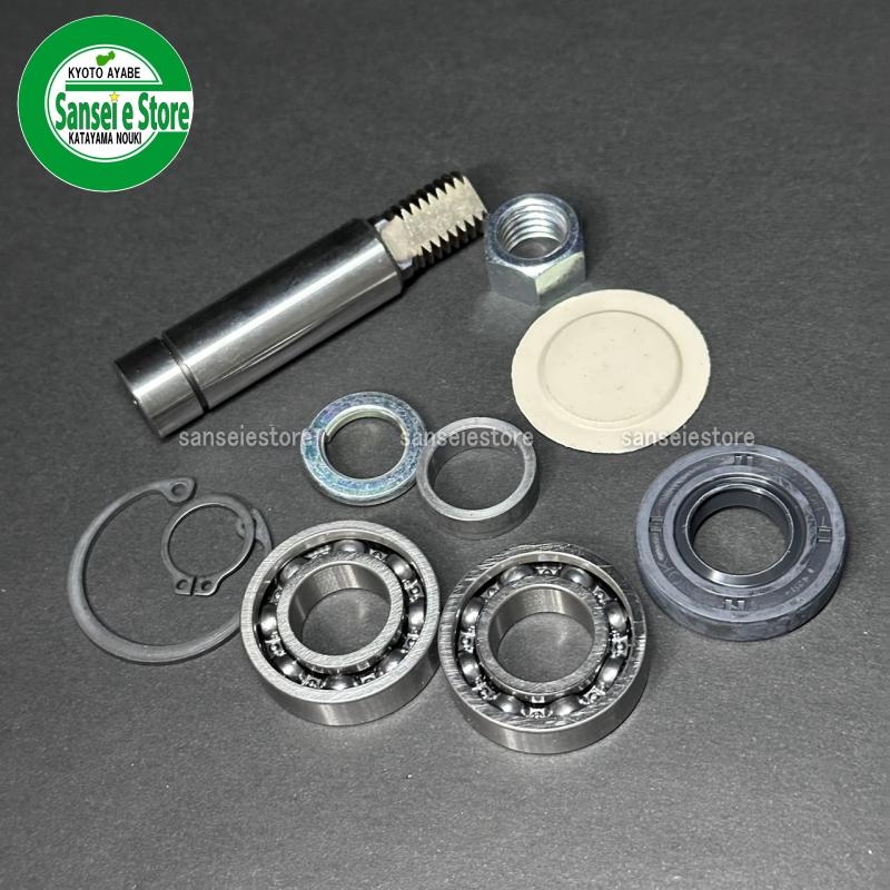

In case others are interested, this appears to be a very similar shaft set up to give you an idea of what the internals should look like. I know mine is different as the C-clip's groove on this one is towards the end. Mine is towards the threads. But I think nearly the rest of it is similar. This set is ~$85 USD, which is the same cost as a used set of gauge wheels, so I won't be buying this set. I have found the necessary bearings (6003, but I ordered 6003-2RS) based on the measurements the website offered. Today I will be messing around with the tiller a bit trying to get this shaft out. Will post updates if I'm successful.

I have a picture on my phone that I'll try to upload but I am a bit concerned with the NJ-4514 bearing compared to the original bearing. The new bearing has a smaller ball bearing. Curious if they'll hold up. But for now it is working.
