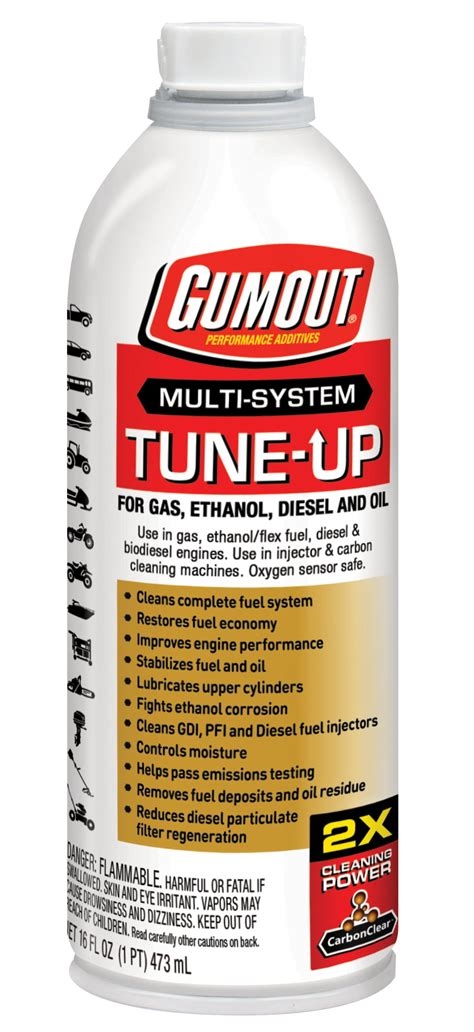

The reason why I use Seafoam and/or Gumout Tune-Up. Whatever one is on sale at the time. The Gumout works a tad better overall. Diesel can have microbe build up in the fuel system. Even the metal fuel lines that can clog easily.

+1 on a SeaFoam treatment. You can fill the fuel filter with it, run the engine briefly to get the SeaFoam into the injectors, and stop the engine to let it soak for a while (e.g. a day). I add the rest of the can to the fuel tank.

@kmartshopper if you are going to go brush hog for awhile, I would add a can of SeaFoam to the tank now. It can't hurt, and may help.

Some folks are suggesting seafoam. that sounds great.. however thats not my problem.. the lines are clean. the tank is clean. So what happens is, the tractor will start to lose full power .. say about 1/2 then continue to drop in power. Ill lean over and loosen the fuel banjo bolt to the mechanical fuel pump.. ill shake the loose but still attached bolt, some fuel is spilling out but the tractor goes back to 100% power. if i tighten it,,, it will loose power as before. if i leave it semi loose, spittiing out fuel , it will stay at full power.
