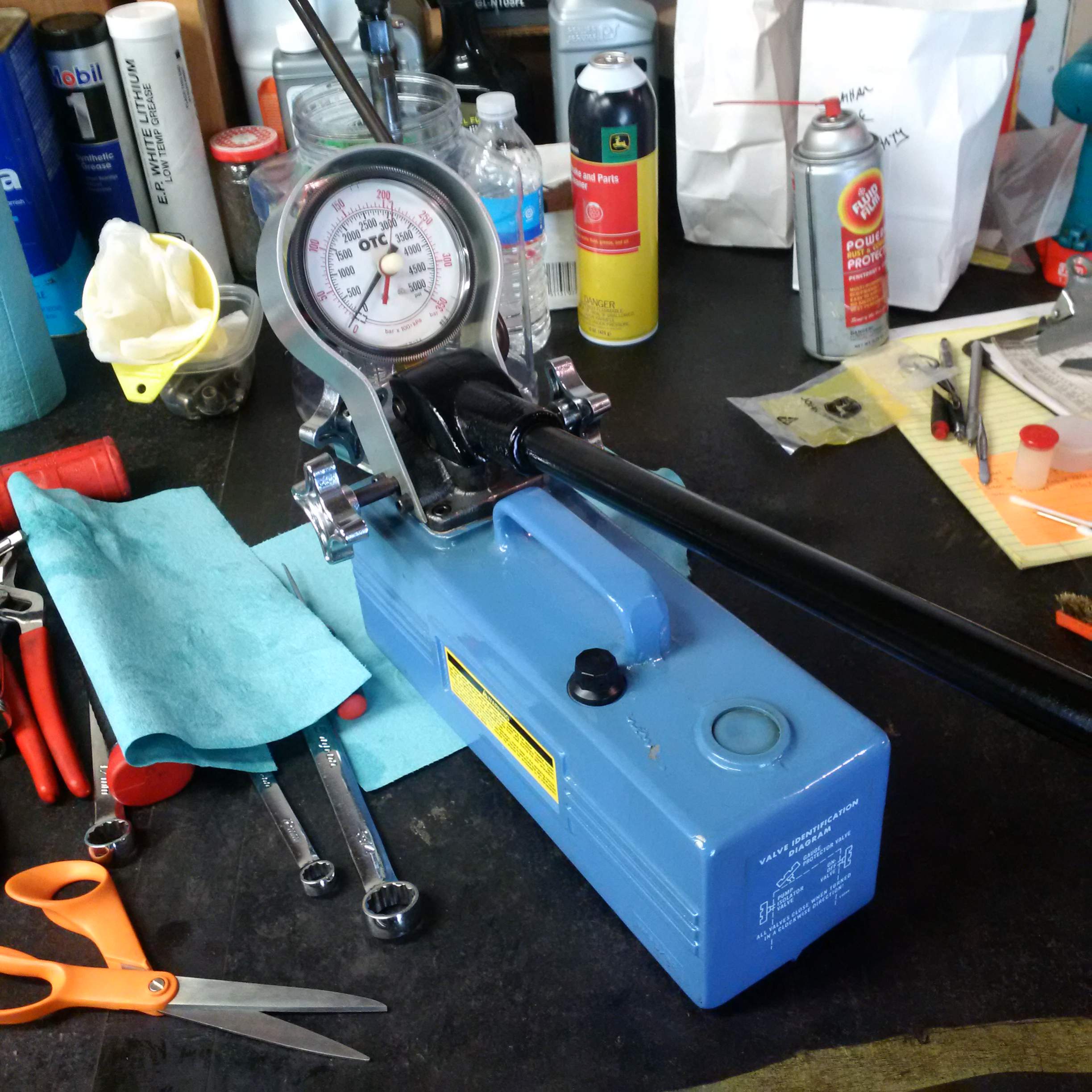

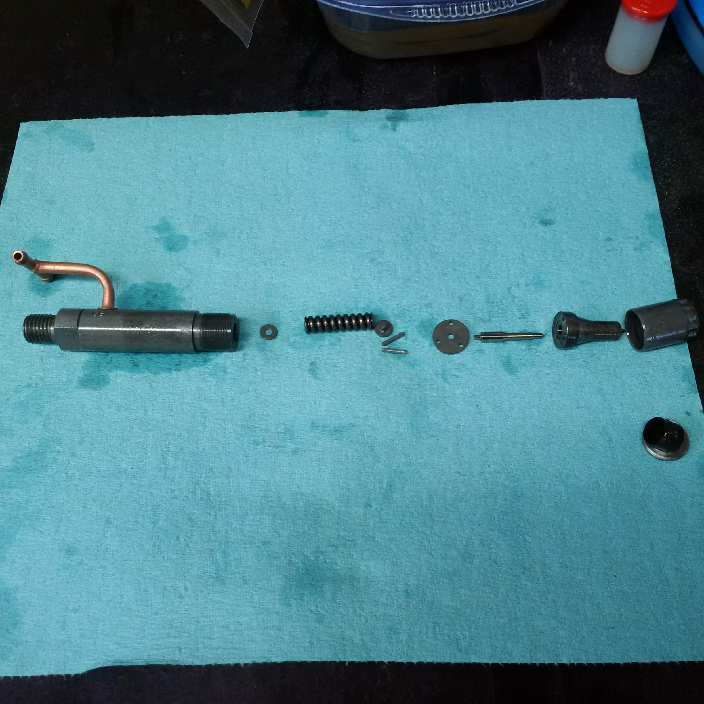

I am rebuilding my injection nozzles from my JD 4400. Thought I would share some pictures. IMG_20150520_182450.jpg

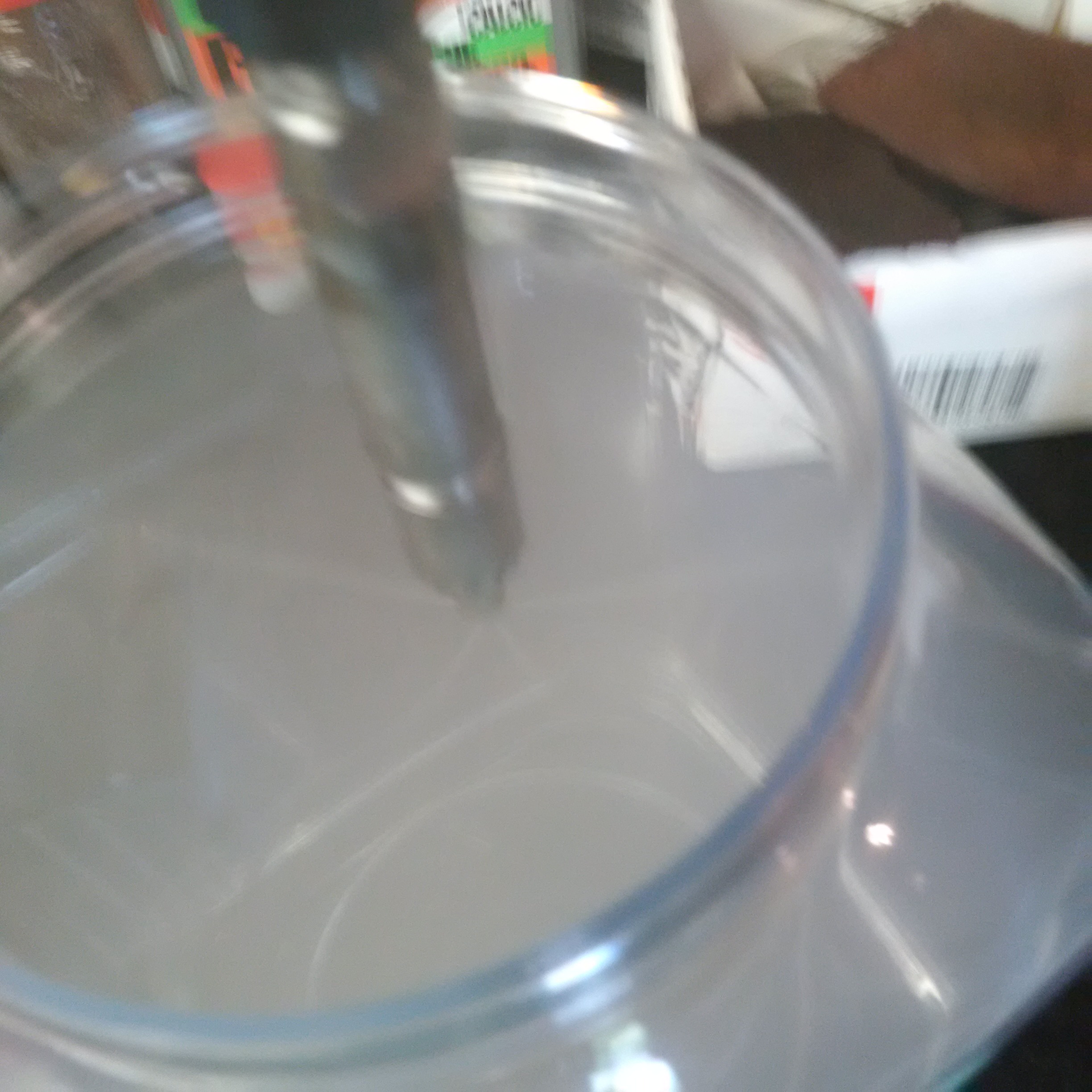

The pic showing the spray pattern look close there are actually 5 spray jets. most other yanmar nozzles only have four. I beleave this was done to meet newer emission standards at the time 2001.

Interesting, but maybe you would share a bit more about what you are doing and how/why. I don't see a pic showing a spray pattern, but do see pics with various arrangements of the nozzle (in parts as well as hooked to an apparatus). Other than that, no idea but am interested.

To clarify I am replacing the injector tips on my current injectors, Setting the pop off pressure and check for chatter and spray pattern. I refer to this as rebuilding the injector.
The first photo in the attachment box shows the spray pattern- very difficult to get the timing right with the flash and when the injector pops to get a clear photo of the spray pattern
