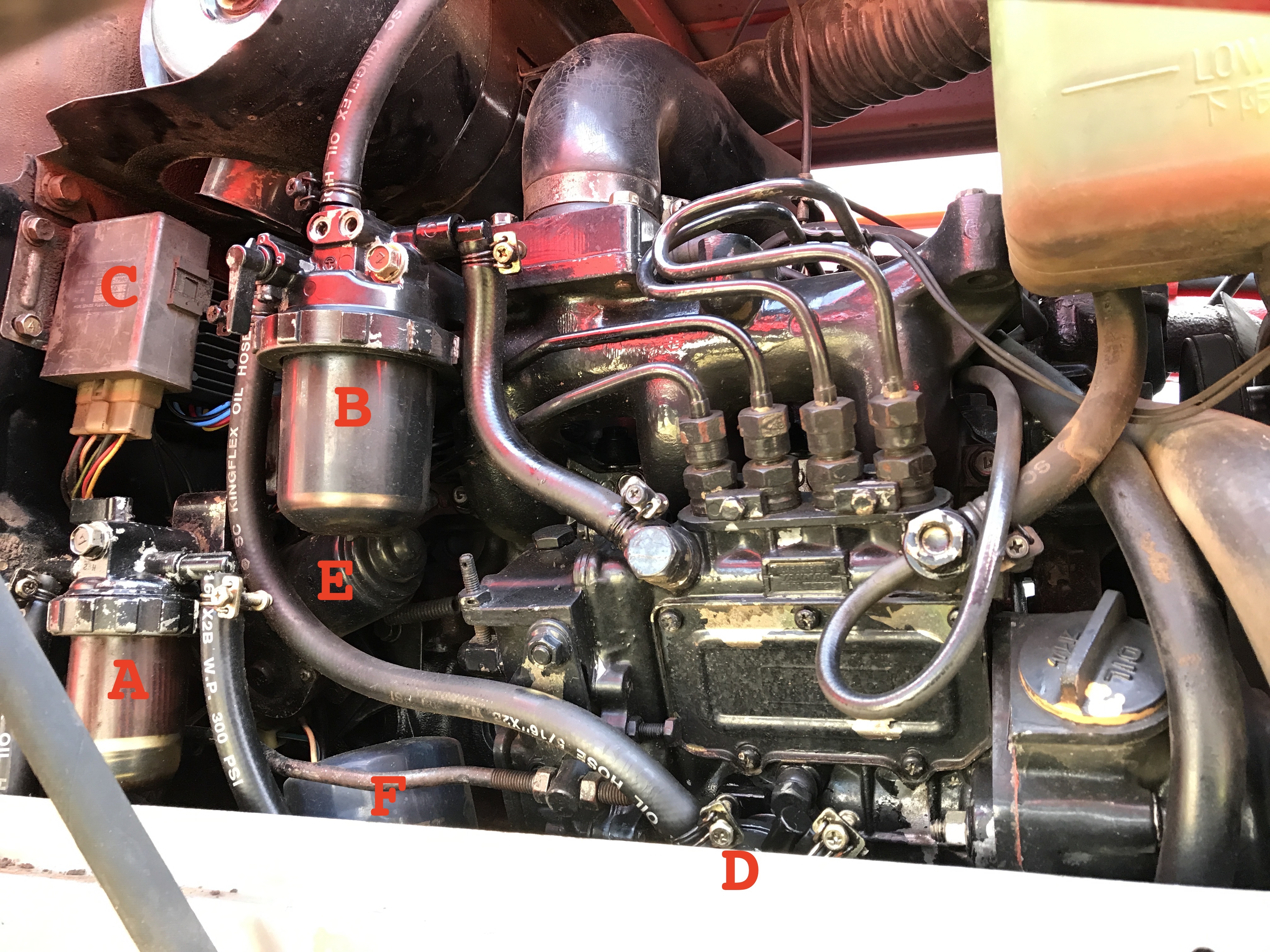

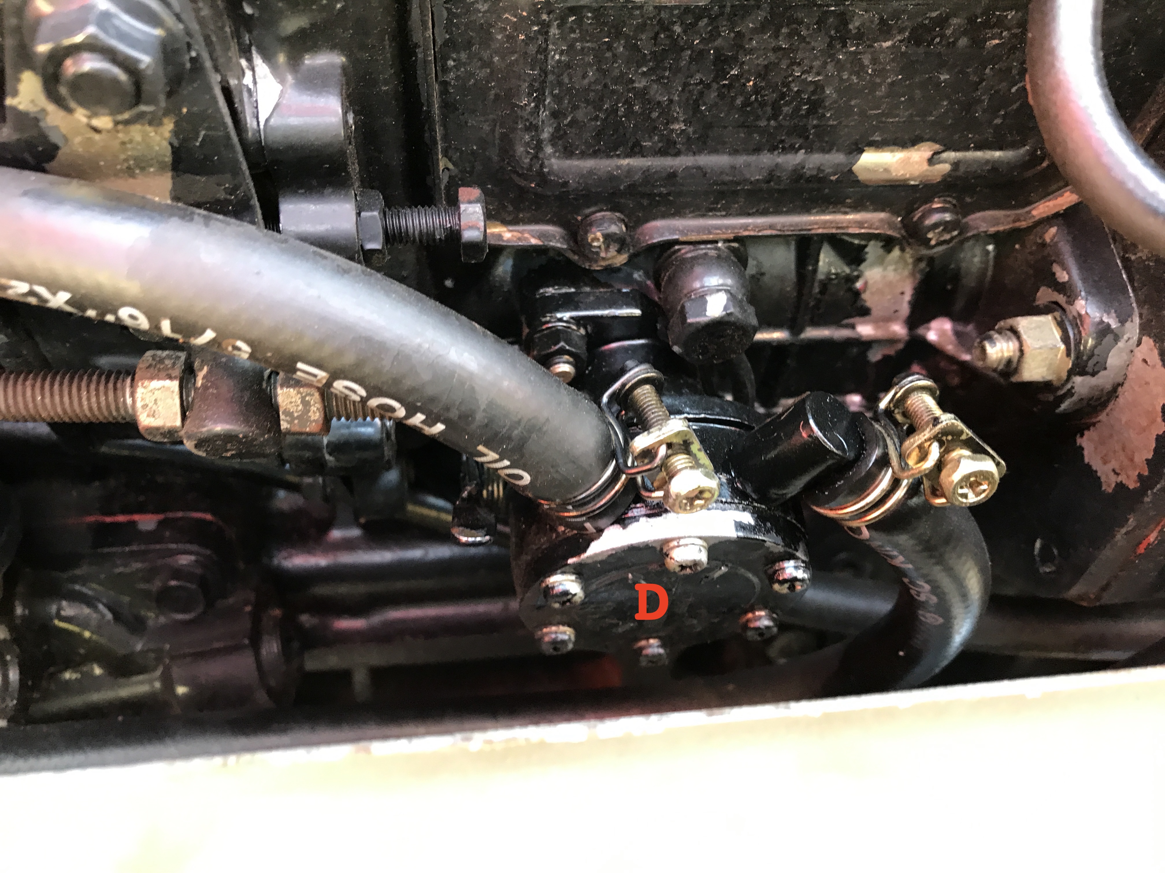

Please help me identify these parts.
A - Primary Fuel Filter?
B - Secondary Fuel Filter?
C -
D - priming pump or something?
E -
F - Oil Filter?
1 -
2 - low coolant?
3 - oil pressure?
4 -

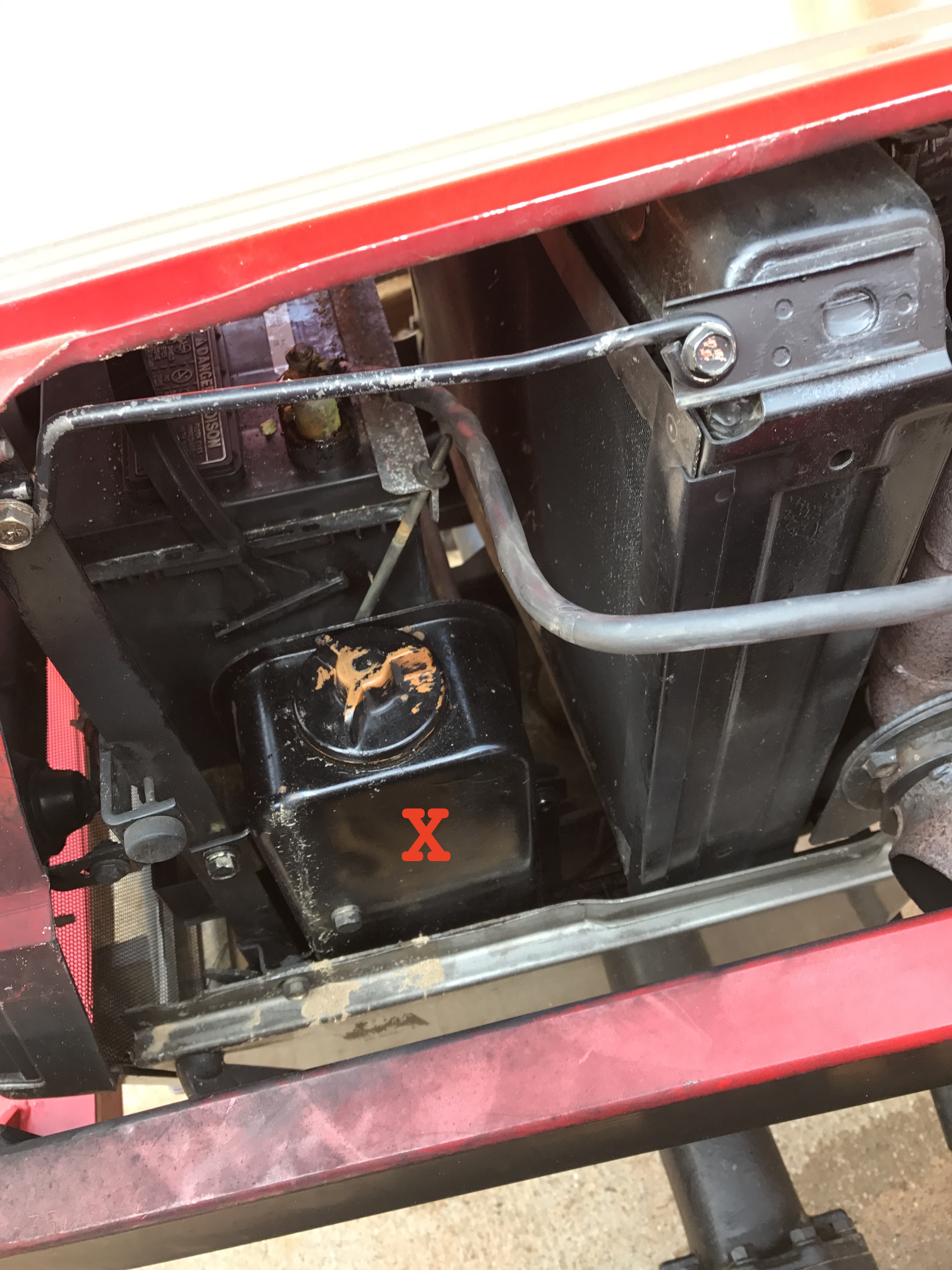

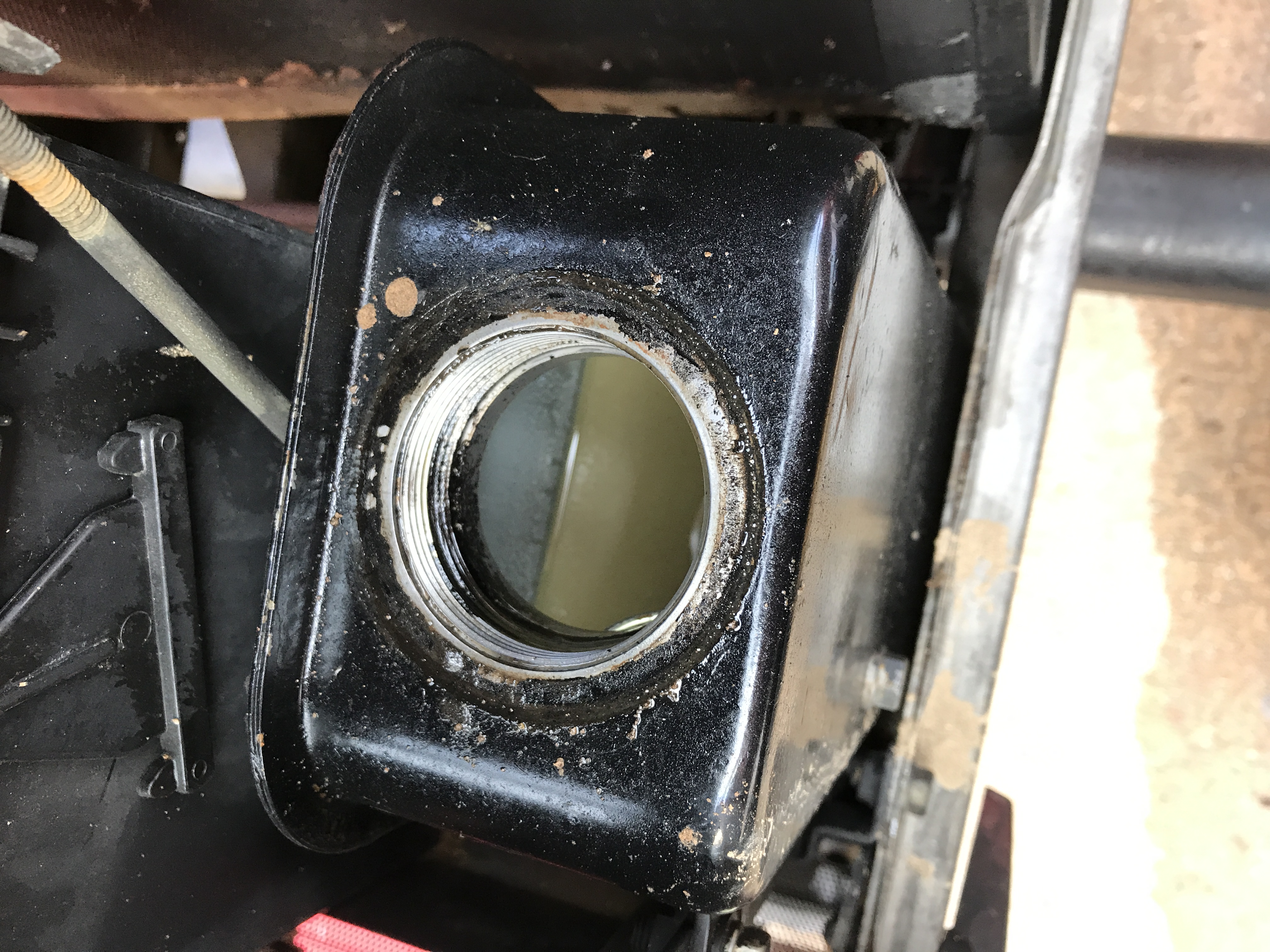

X - hydraulic fluid reservoir? Is it supposed to be cloudy?

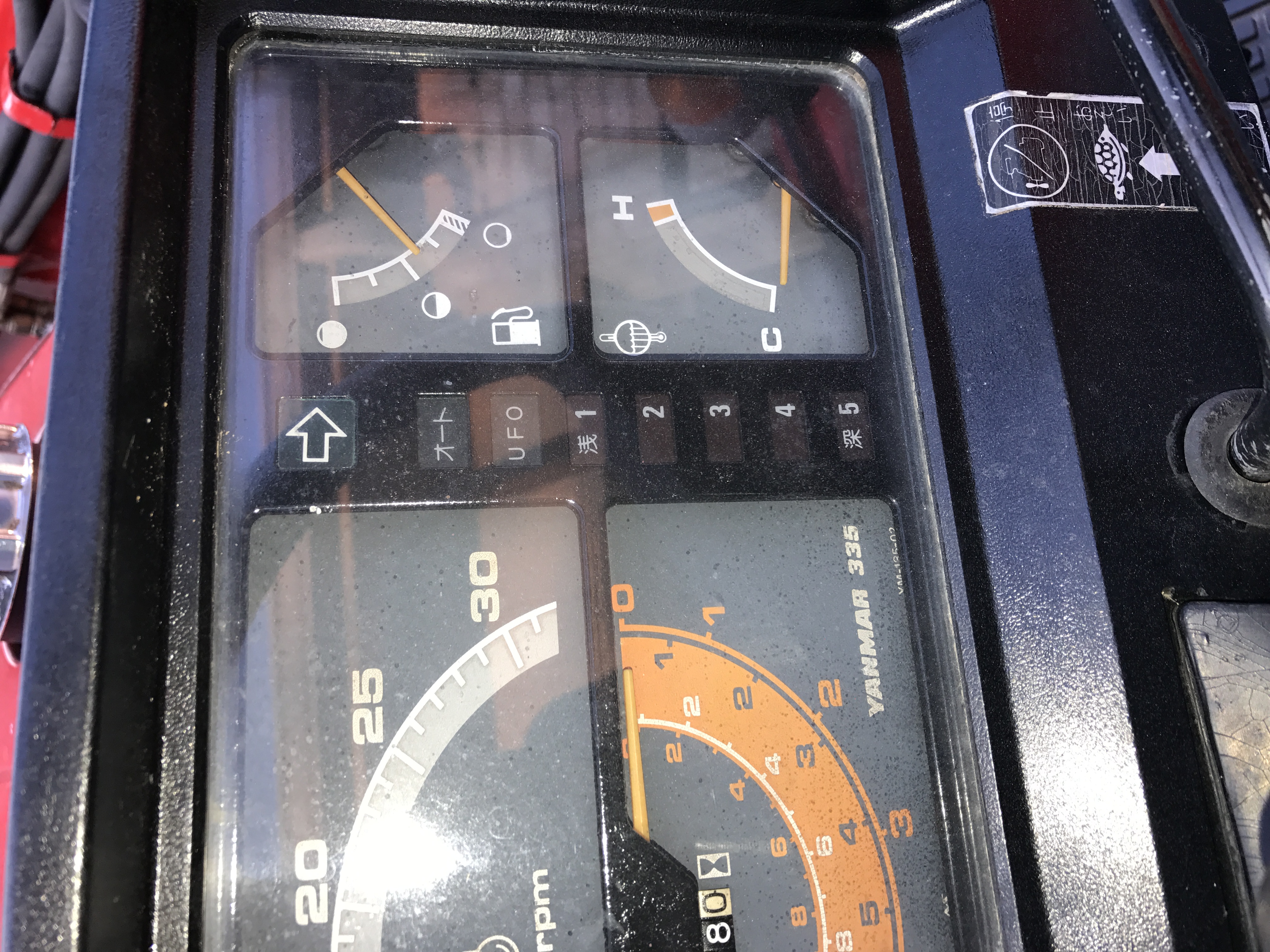

What are all the symbols next to fuel gauge, UFO, 1-5, and some misc japanese above UFO?
Also what is the button next to the light switch? On mine when I push it the low water level light comes on.

A. Called a water separator, should have a screen in it.
B. fuel filter
D. Fuel pump
E. Called engine stop or "motor assy stop"
2. low coolant in overflow bottle
3. oil pressure
Don't know about 1 and 4. Just wondering if 4 could indicate pto engaged?
X. Power steering reservoir and should not be cloudy.
Don't know about the button you pushed but would think you have a horn button. Is it in another location? Can you find a horn on the tractor?

Thank you! I will go change the power steering fluid asap. What type of fluid should go in there? From what I have read some say ref ATF fluid, others say hydraulic fluid. Thoughts?

I would just use the same transmission/hydraulic fluid in the the power steering. Just my opinion, doesn't make it correct.
Fluid & Oil Types
Transmission sump supply's all hydraulics except power steering. Same sump for rear differential.

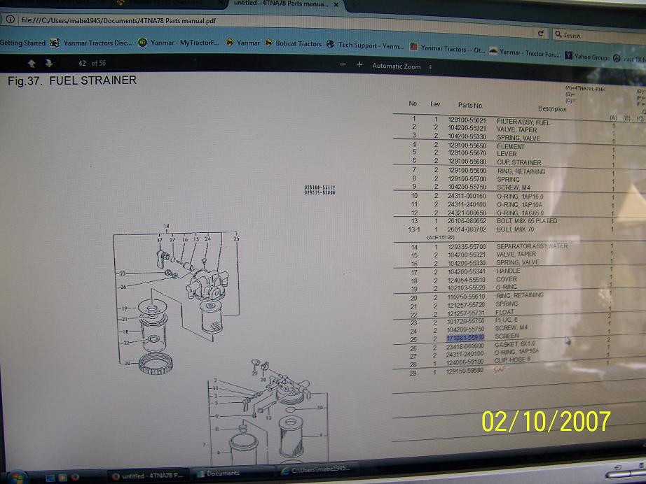

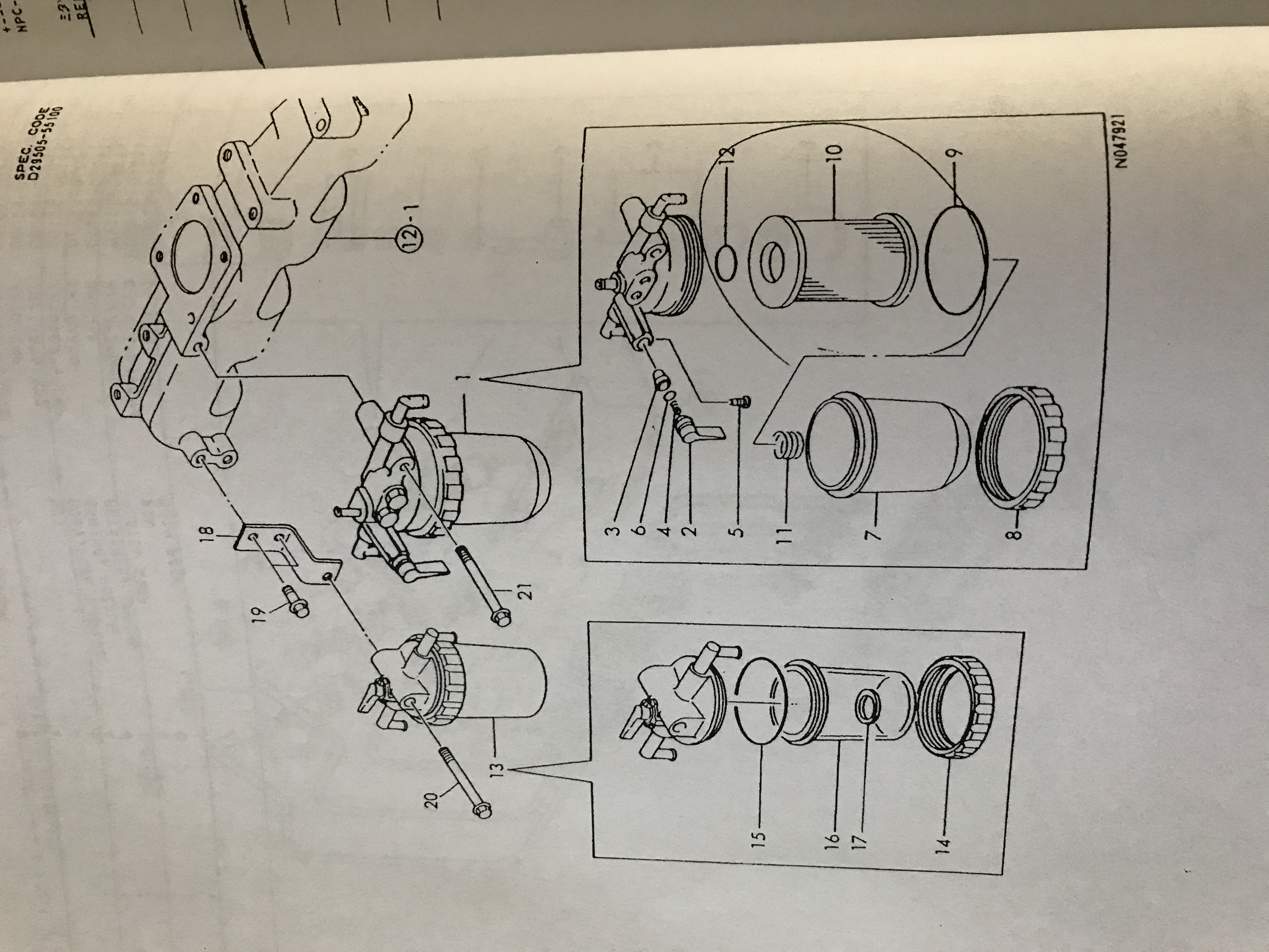

There is a filter inside the water separator and a spring. However, the parts manual does not show there is supposed to be a filter in there. And the top of the housing is not flat, there is no where for the filter to seat to, so basically its just floating around in the fuel doing nothing. The manual does list a "float".
Should I remove the filter and just leave the cup empty? Or try to locate a filter of some sort?

1 might be park brake (my YM14 has this and it flashes when on) and 4 looks turbo related, possibly max boost?
