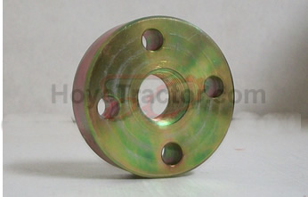

I already mentioned you have the fittings. The collar Hoye mentions is already on the line and there is a banjo on (my guess is) the return to sump is there also if you got bolts with it to attach those 2 fittings you are almost here. An example return to sump could be right on top of your transmission that a longer banjo bolt could be used but that's a guess as well. I would cut the lines as a last resort that is a lousy way of doing it. This pic is the collar btw. Also I would be using a straight fitting rather than a banjo as a return but it would get you going just would not flow as much as a straight thru fitting. fwtw

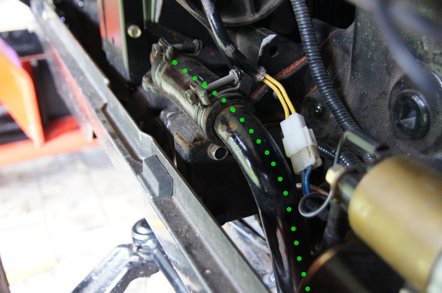

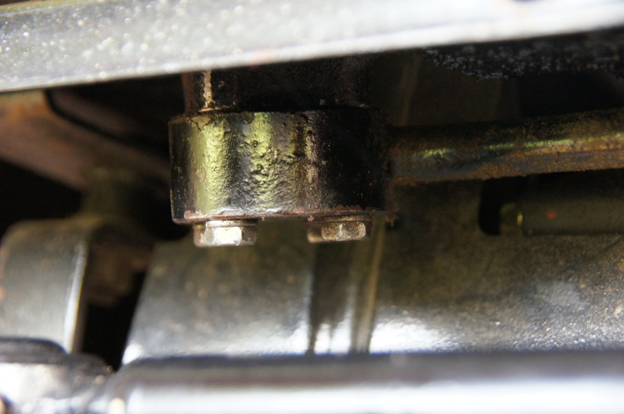

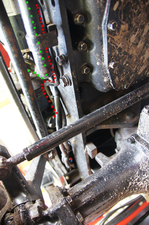

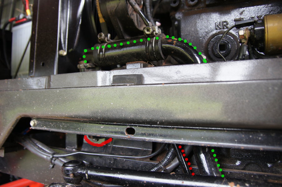

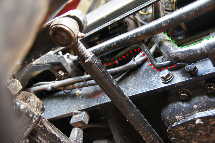

It is now difficult to photograph the HP pump but I've taken several to show the path of the HP line in red and the supply/inlet line in green.
The supply comes in at the top. The HP out is via a banjo fitting with four retaining bolts at the bottom of the pump.
Under the HP pump would be the place to use the HoyeTractor attachment but how do you bend the HP pipe to get it out of the way - short of unbolting it and trying to remove it?
There doesn't seem to be any break in the HP line between the pump and the rear. It wends its way around, under and over until it comes up and is attached by a banjo fitting with a central bolt. This is on the front of the assembly, under the cover beneath the seat.
I've attached a pic (last one mainly red in colour) of the face of the underseat arrangement. You can see "C" the HP line coming to a banjo, "A" the spindle for the 3PL control (rate of descent and lock) as well as "B" the hexagonal extension that protrudes through the cover plate.
