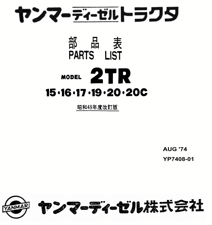

I am kind of curious if anyone would know which 3 cylinder yanmar engine(s) could be swapped in place of the 2TR13A. I think it would be fun to find one of these old diesel engines and slowly rebuild myself and maybe add a small turbo on and have on hand and maybe swap in place of current engine. Thanks
From the 2TR family engine manual, the 2TR13 is not able to interchange with anything. It is, its own unique engine.
Most of these can interchange,
15-16-17-19-20-20C
and the 22-27 can only interchange amongst each other.
