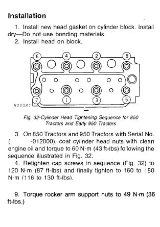

I'm replacing the head gasket. Can anyone help me with these torque specs and rockers?
   / Yanmar 3T80J cylinder head torque specs? #2
I can tell you what it is on a 3T80U-N. Stages of 29, 58, 72-79 ft lbs. Cylinder head assist bolts 22 ft lbs. Rocker arm support nuts 40 ft lbs.
The 3T80J is found in the John Deere machines. I know, I once had a JD850. I have virtually the SAME engine now in my YM2610, closer if it's a YM2500.
On the Yanmar Tractor Owners Group site, link in my sig next to the flag, there is a TM1192 Service Manual you can get for FREE. It should have those specs you are looking for. Bet it's about the same as Winston listed.
The 3T80 engine comes in a few variants. Just depends on where & what air cleaner is used, if the thermostart is a manual fill or hosed to the diesel tank, early models no cylinder sleeves like the later variants and what exhaust pipe is used. Not much more really.

What machine do you have that has this engine. I see the John Deere manual referenced never mentions Yanmar model numbers.

Please may I have the Torque specs for rebuilding a Yanmar 3t80-uj on a Deere 750 from 1982.
We are rebuilding it.
