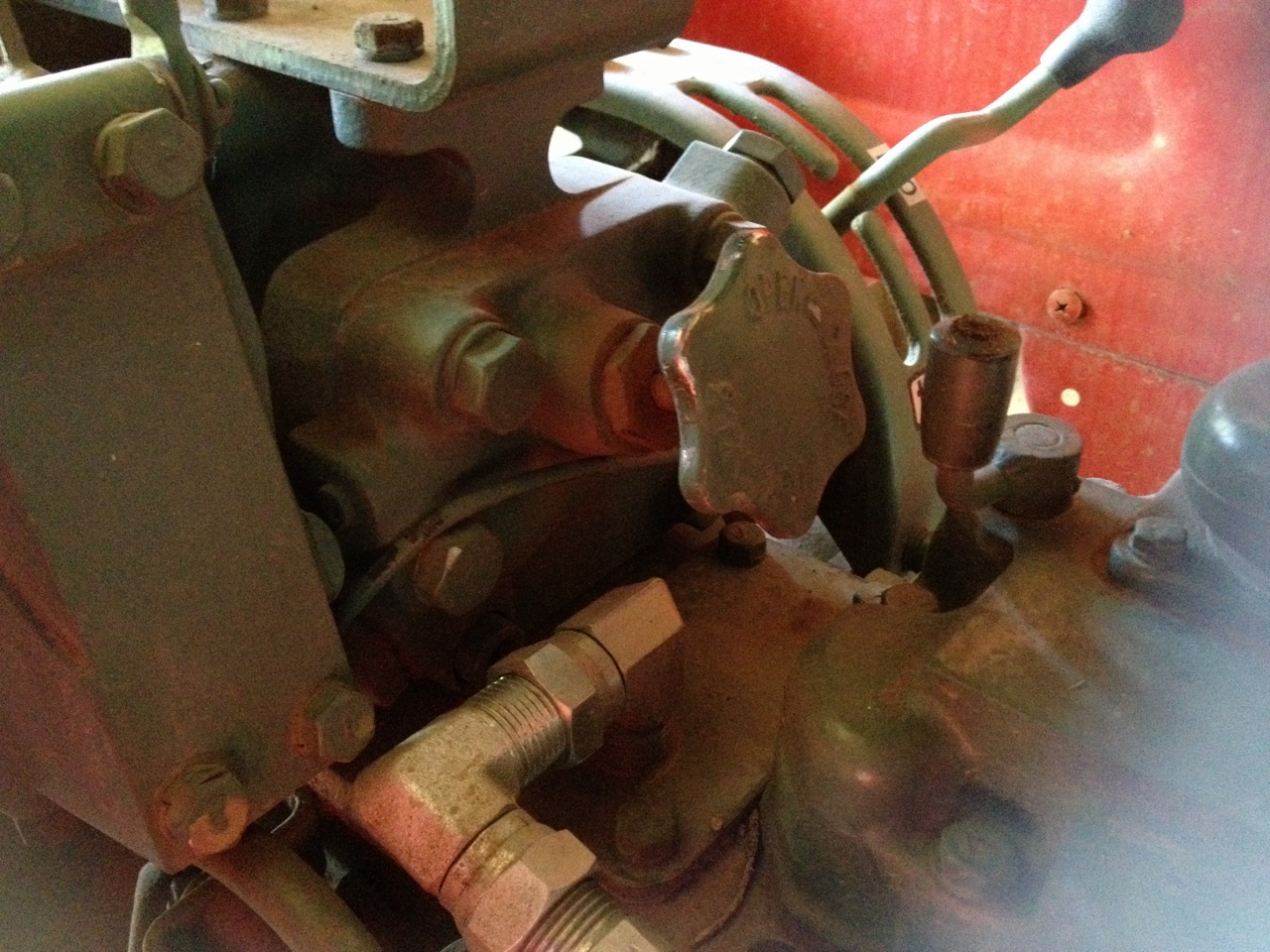

Here ya go I found a pic of the draft clutch lever in my attachments and the lever is down to work with the 3pt draft control so yours is wrong now and may be why it isn't working?. I will dig around or take some more tonite for ya. You even may find some pics in a thread I started about remote hydraulics I put on mine last year or year before.

I went and looked thru that one just now and I was thinking I had better pictures of the 3pt block with what the 2 lines were in and out? Loosing my memory isn't a new thing haha. The ones that are in the OP pics. I can take more tonite so I can say which one is in and which is out.
Here we go I found it. The H is actually an I for in I was sideways when I wrote it or something haha. The O is pressure I is return.

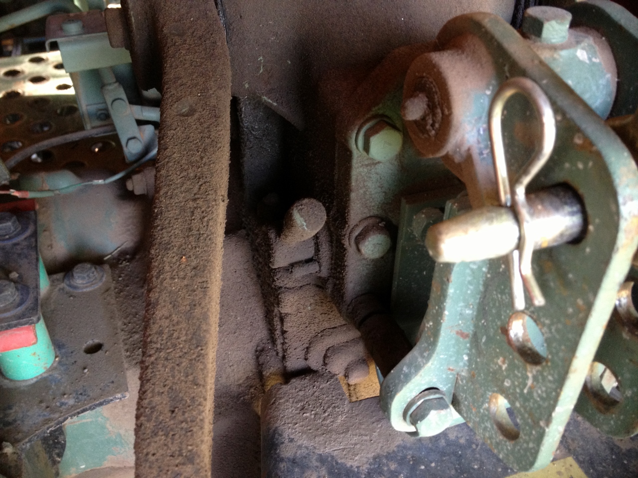

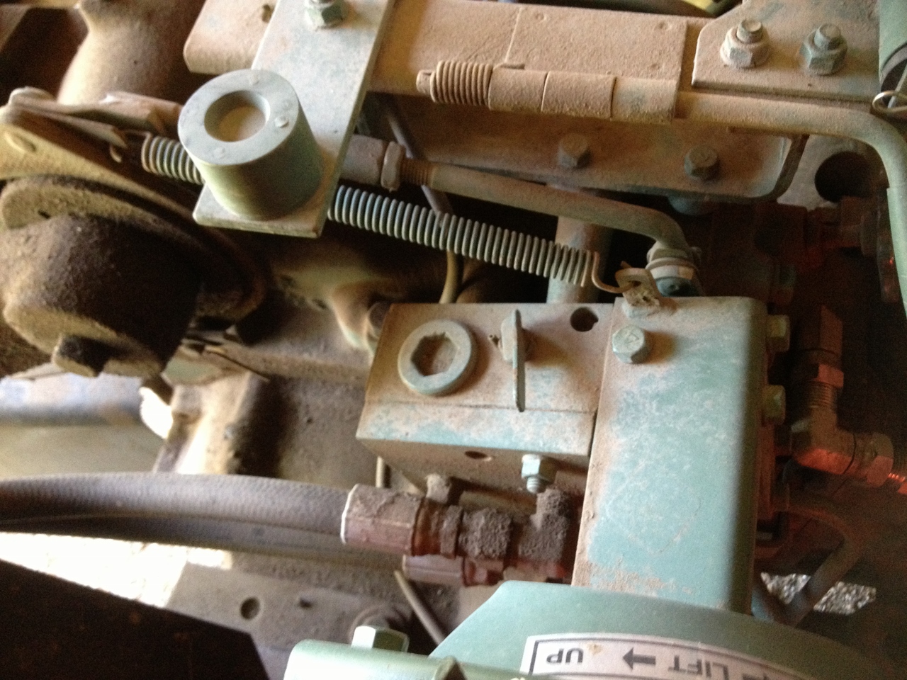

Ok here is the pics of mine and my 3 pt works fine with all these levers and so on where they are in the pics. The lever on the lower left of the rock shaft housing is supposed to do something but I cant find the description right now? Suffice it to say if yours is up like mine in the pic it should work. hth :thumbsup:
edit: Like I mentioned the lever on the rt side rock shaft on yours shows its up that is for auto draft and will not work with the draft control lever it will not work that is the first thing I would do is flip it down!

Ok that's where we had to start. The next thing I wonder about is whether the hp line back to the 3 pt block is dumping into a return? Reason I even say this is your p/s is working and it is feed by a separate port on the pressure regulator/diverter block.
The hp feed to the 3 pt is the steel line going back from that block so if its been opened there could be a routing issue. A person needs to follow the flow to determine that the pics dont show how the hoses and lines are. hth

Just for fun with the tractor idling why don't you "slowly" crack the banjo fitting under the control valve (shown in your first picture) just to assure you are getting flow to the 3 point control valve? Might be a little messy but with no load I don't thing anything dangerous. Just an idea.
