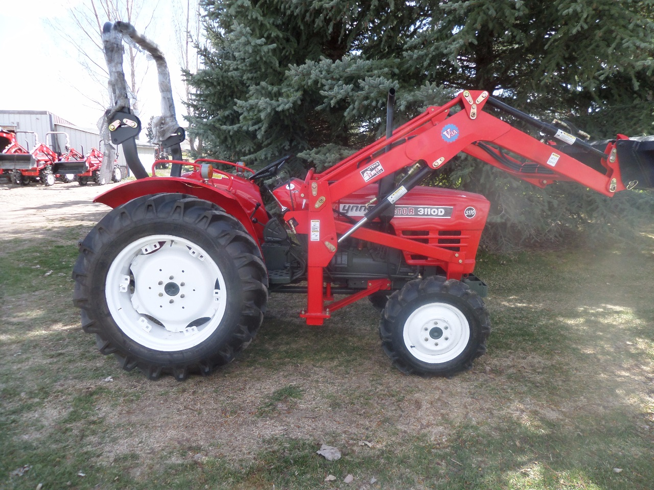

Mine has the ROPS and PTO shield on it as well as the loader frame. Here is a picture of it before I took the bubble wrap off the ROPS.
