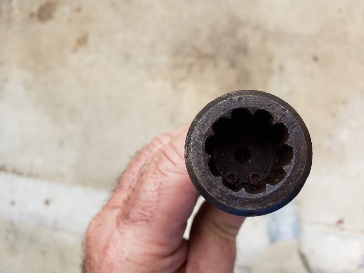

Here is the clutch shaft with the "expert" repair by the PREVIOUS OWNER.
Here is the inside of the spline coupler end that was welded onto the clutch shaft. The is a ring clip in there. I cleaned this out as best I could for viewing purposes.

That welded coupler and the consequential damage are ugly!!!
Was this a VN 'rebuilt'?
My first guess is this was never the right coupler seeing how one side of the coupler chewed the spline off the transmission input and the 'rebuilder' welded the other side.

I think the tractor passed through Vietnam on its way here. I bought this YM2010d and two other YM1500d's in a package deal, where I kept the 2010 and sold the other two. I think I have about $2800 in the tractor. I complain, but I have put more than 400 hours on this tractor since I bought it. This has been my first major repair. I am inclined to agree that the coupler was a mis-match in the previous repair, because it looks to have less damage and may have started out with a different width/shape on the splines than the shaft did. I hadn't really thought about that until you mentioned it, but I bet you're right. I plan to do a little more tractor surgery this weekend to make the power shift pump more accessible, so more to come.

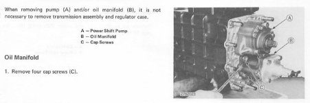

A question for the folks that have had experience with the Yanmar power shift pump...Do you have to remove the oil manifold (the thing with the cross bar) first before removing the power shift pump? Below is a picture of the transmission for a Yanmar 276 (basically the same) and it appears it can be removed without removing the manifold, but I'd like some independent confirmation if there is any to be had.
