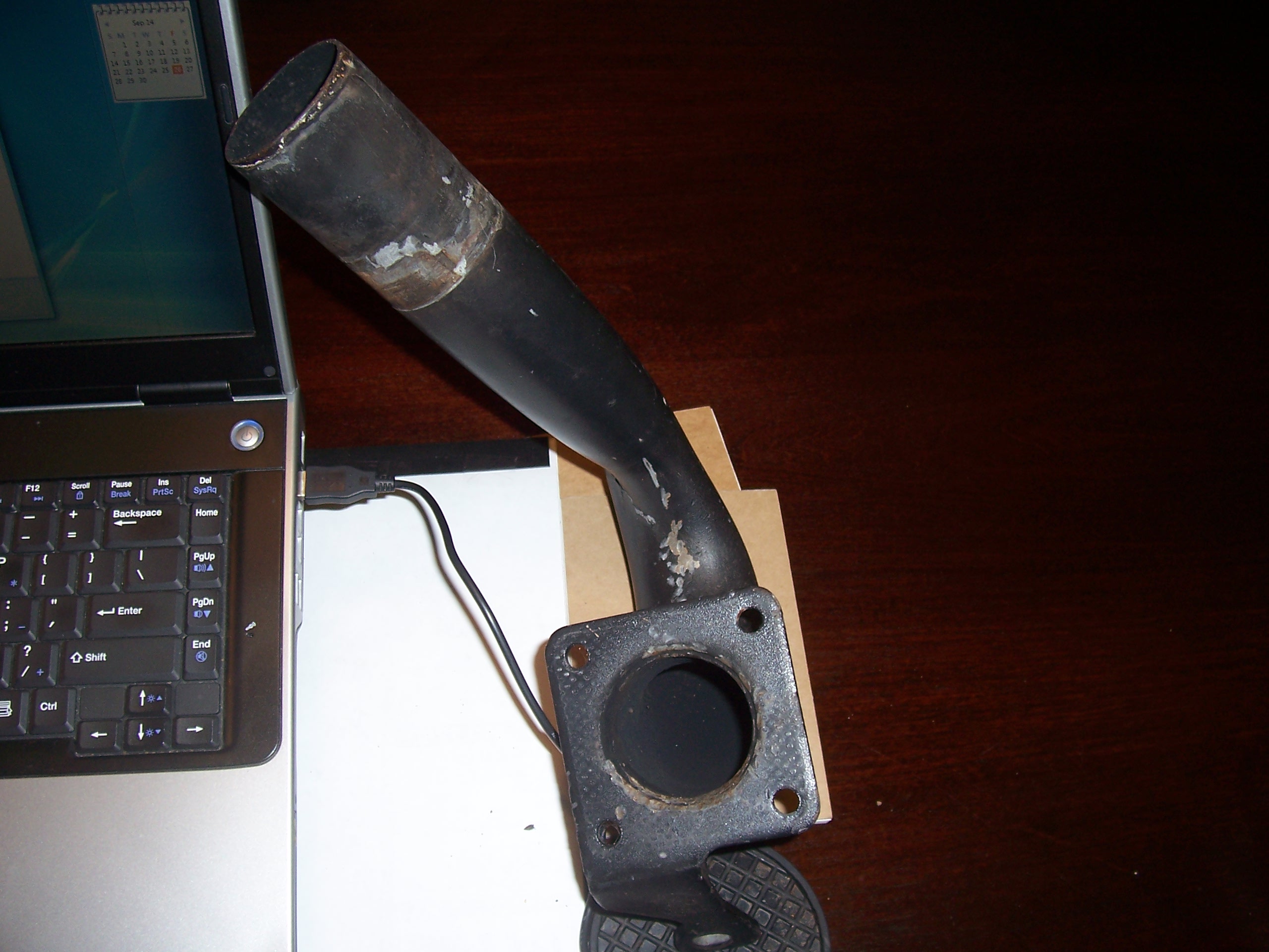

That Exhaust/Muffler Cap sure doesn't look like it's opening very much. May want to remove it or keep it open.Now that I look at it closer the smoke coming out were the Muffler connects kinda seems to point to a clogged up Exhaust!!
