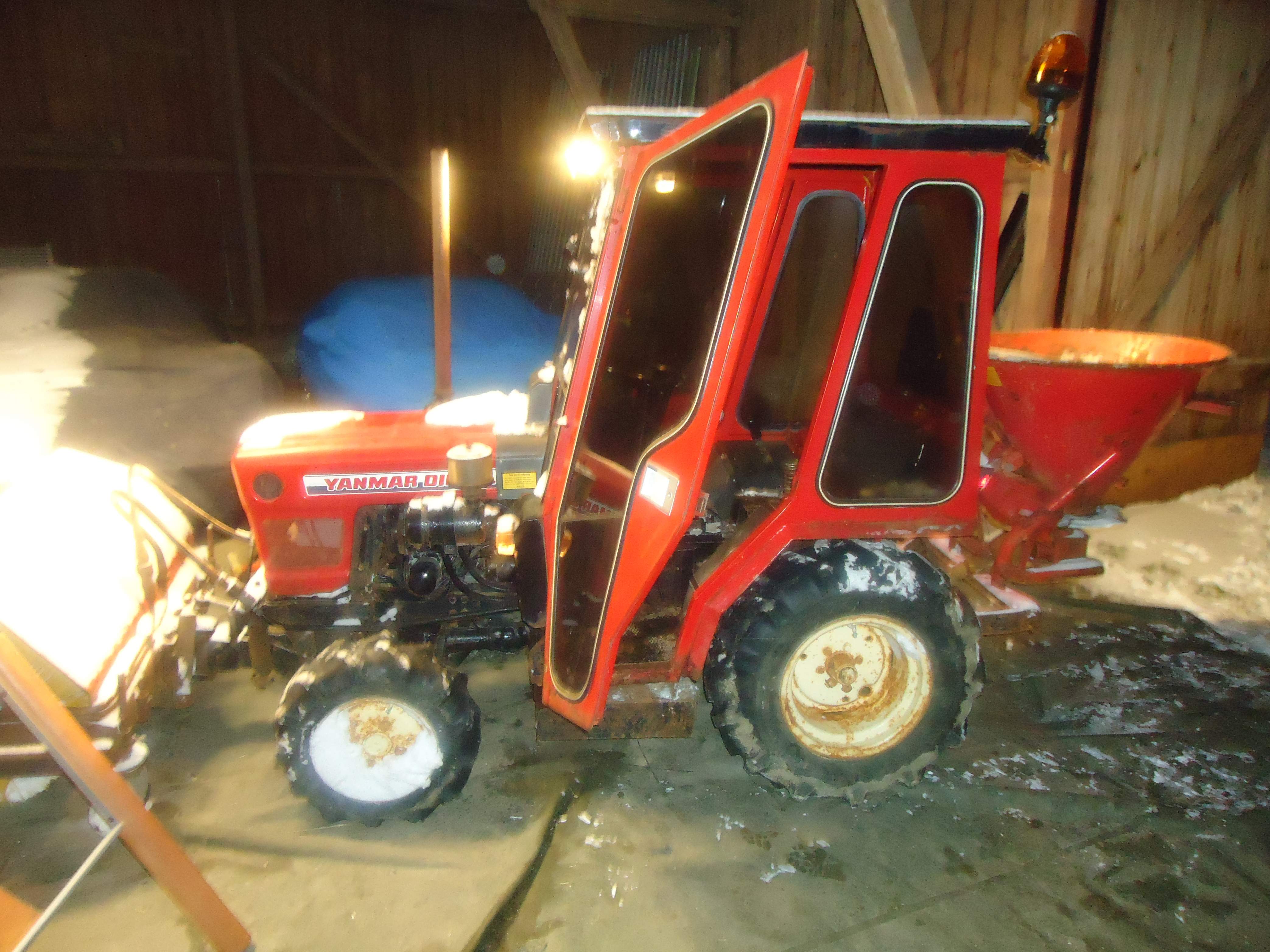

I know I have to fix fault before I fit new pump that is why I am trying to find oil pressure release valve on hydraulic system have checked couplings on hoses they seem to all ok
/ yanmar 186d trans #22
Do you have a front end loader? Are the couplings on your hoses the quick connect kind? I have sent you a pm.
/ yanmar 186d trans #24
yes has front loader couplings seem ok checked for any blockage in hoes end all seem ok is there a pressure release valve in valve block on transmission were high pressure pipe comes from pump to top of transmission housing there has to be one some where in transmission or a filter screen
/ yanmar 186d trans #25
I think the relief valve is in the transmission, but sometimes a loader is plumbed in series before the transmission - so the pump isn't facing a relief valve before it gets to the loader controls.
/ yanmar 186d trans #26
has front loader hoses and couplings seem ok hoses go from loader to block on left hand side of transmission were the high pressure pipe comes from hydraulic pump loader worked ok also lower links if there is a pressure release valve or filter screen were is it ;its location on transmission thank you for your help
/ yanmar 186d trans #27
The relief valve is shown on Figure 53 in your parts manual. It is reference numbers 4,5,6,8,9,11,12,13.
Your hydraulic suction screen is shown on Figure 39, reference #30. Should have nothing to do with your pump splitting.
