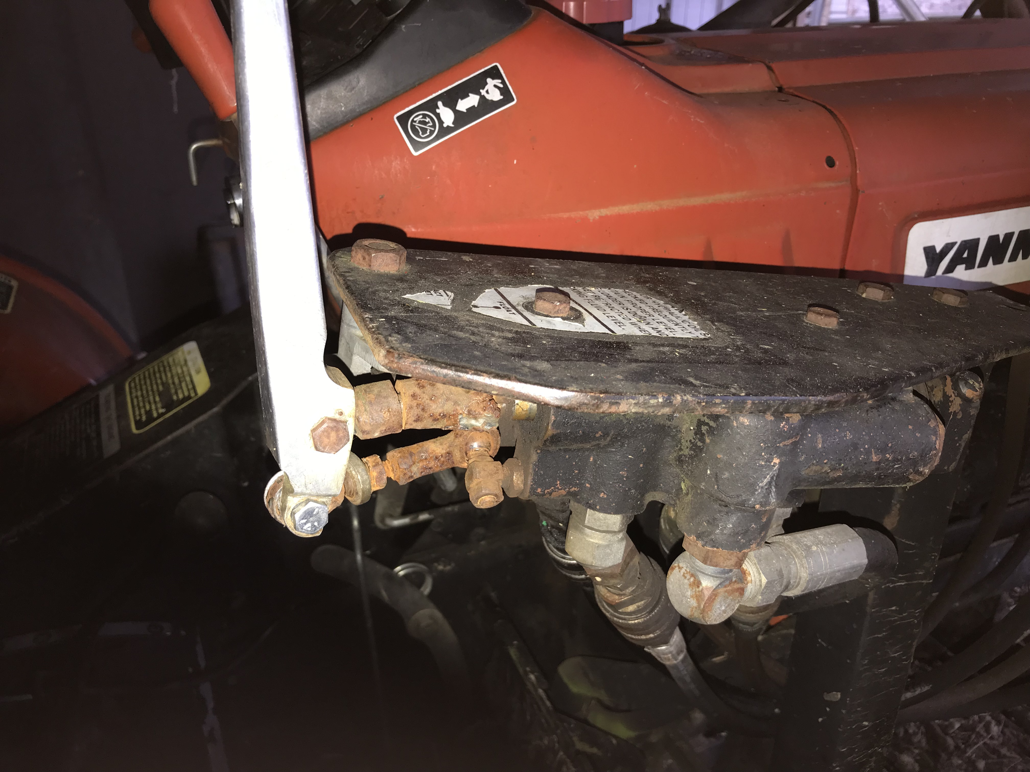

Can someone post a picture of the loader handle and linkage as mine looks homemade.

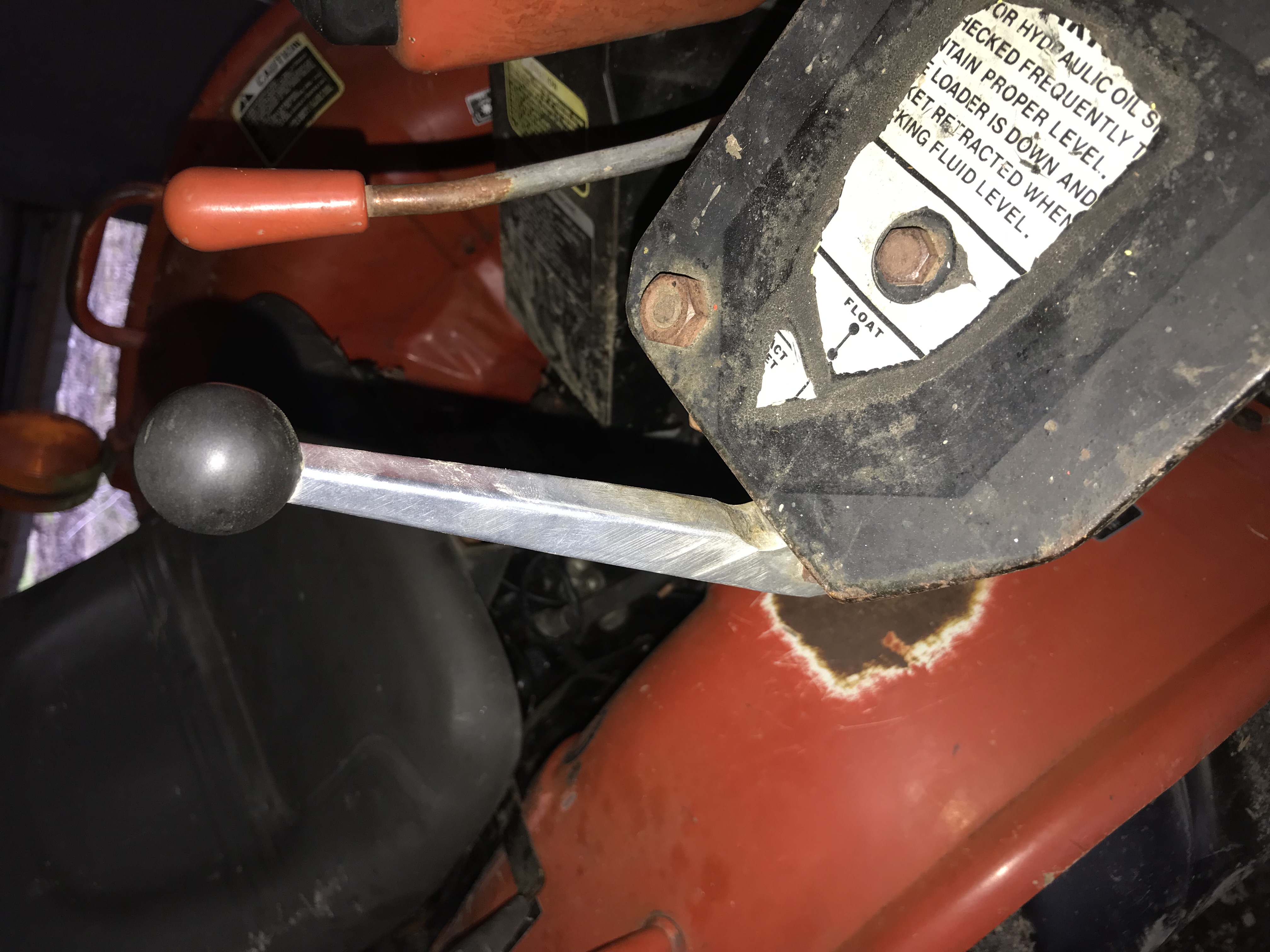

   / Yanmar 186D loader hydraulic filter #15
No that's the real thing. My YM186D has the same monkey-motion linkage. Not as corroded but not clean metal, either. Your cast aluminum (?) handle looks more professional than what I have. I'm home right now but as I recall, the handle on mine is just sheet metal bent to similar shape.
Edit: I found a 2014 photo, where I replaced the loader's quick-connects. This enlargement shows the linkage like yours - and the cheap but satisfactory handle.

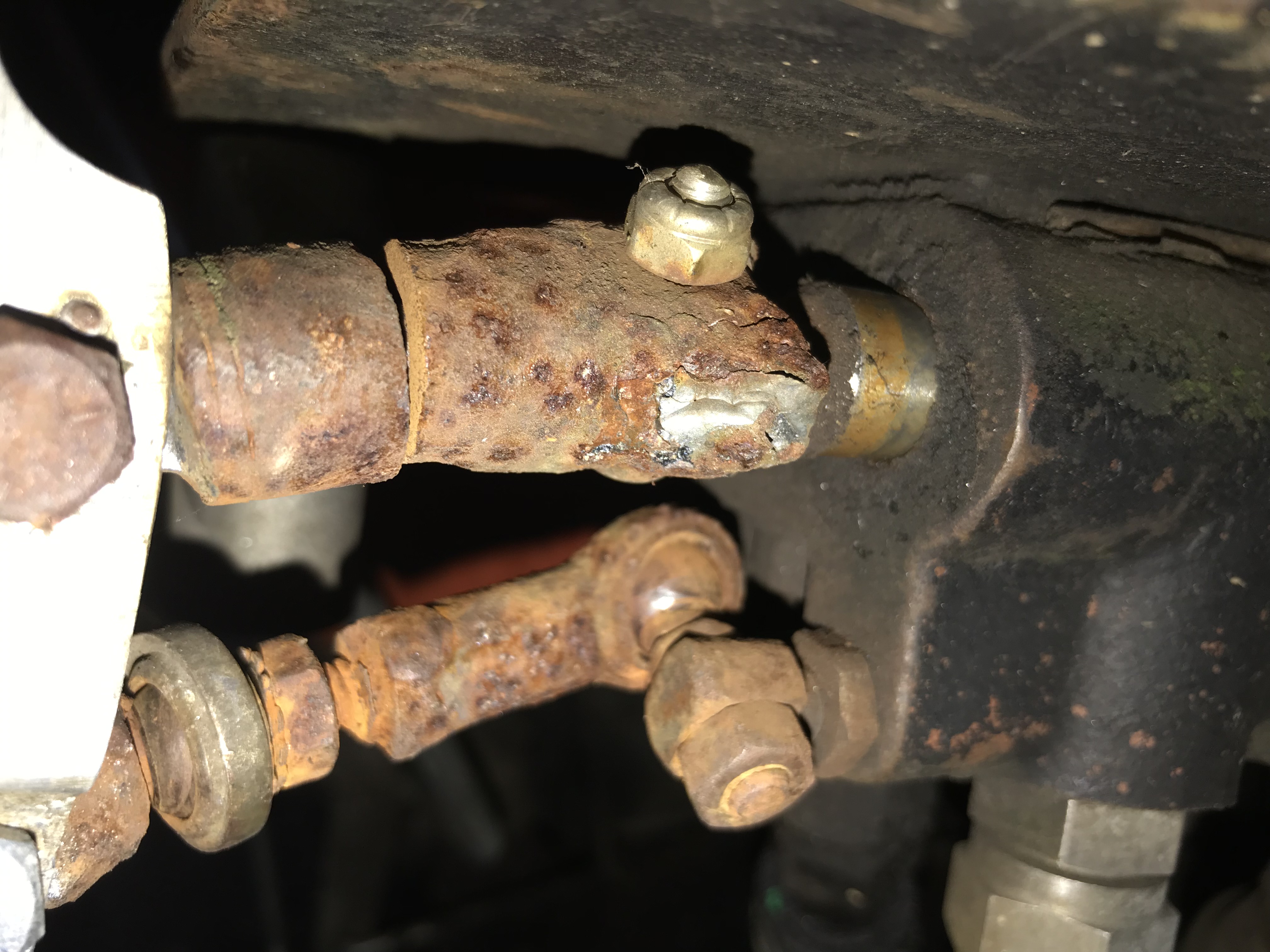

Too bad such a good tractor loader has such a janky handle...
   / Yanmar 186D loader hydraulic filter #17
I agree with California, that looks really corroded. I don't know how easy it would be to repair that or look for a different valve.
#18
Anyone have a parts book for the loader that they can share? Or know the brand of the loader valve?
I would like to repair instead of replace...really need the swivel piece as that is quite worn.
