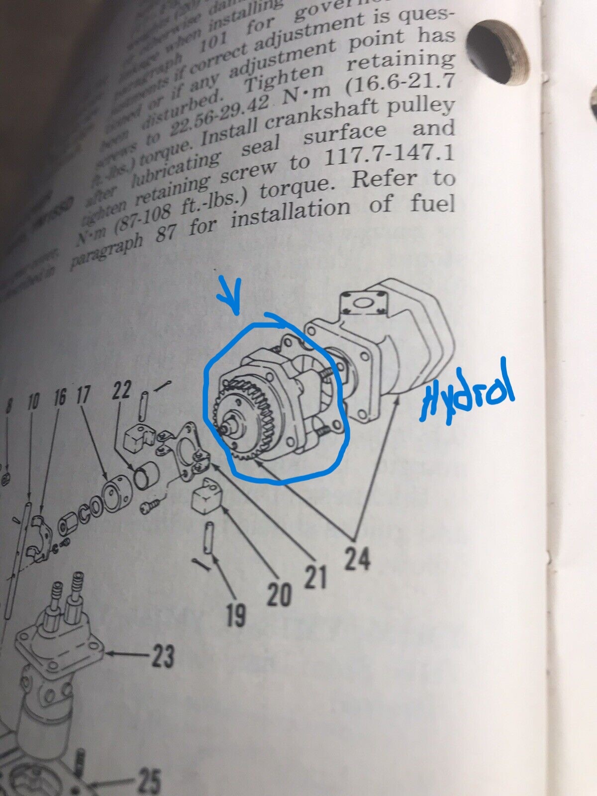

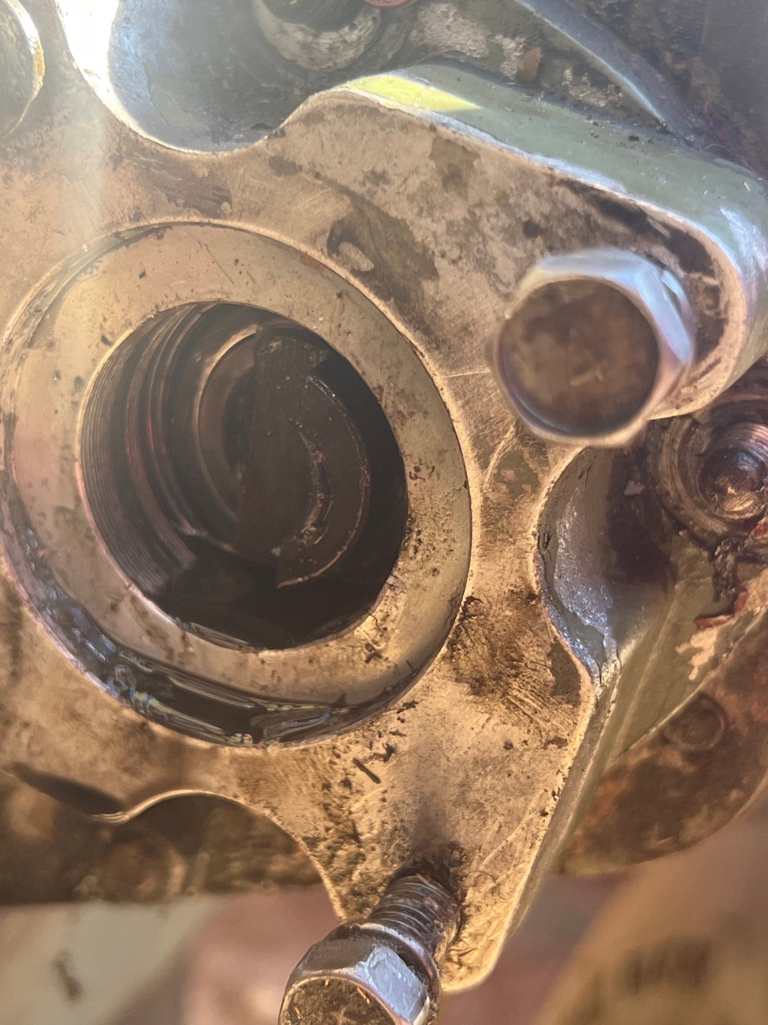

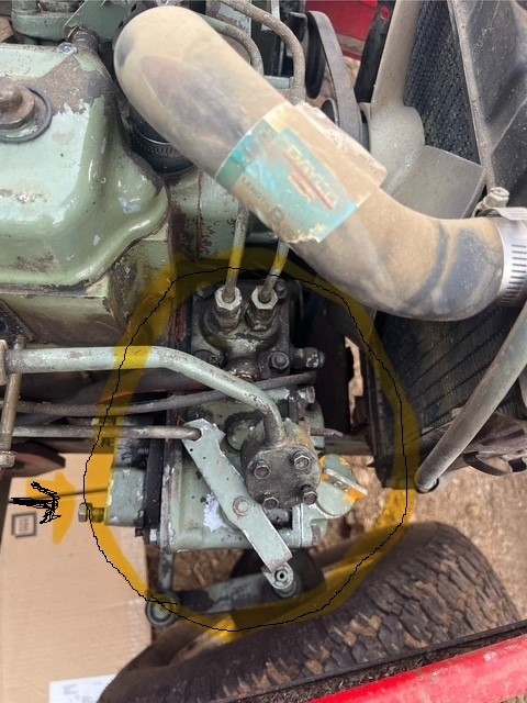

Yanmar 1300D 2T75-C Seeking Hydraulic Pump 'receiving side' - Receiving Side Gear broke

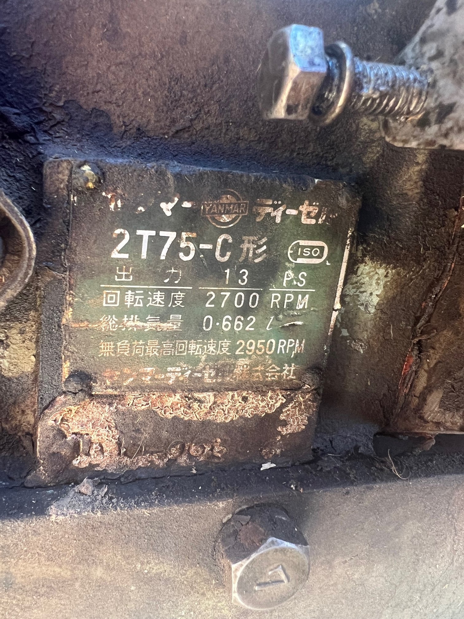

   / Yanmar 1300D 2T75-C Seeking Hydraulic Pump 'receiving side' - Receiving Side Gear broke #2
Your YM1300D should have a 2T13 engine. The engine ID plate says someone swapped the engine and/or the entire front end of the tractor, then placed the YM1300 hood on it.
A 2T75-C engine is found in the YM14 and YM146.
I looked at the YM1300 parts manual and found noting showing the broken part.
What manual did your posted image come from?
