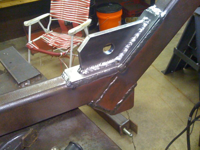

Since I'm building a root rake/grapple I figured it might be handy to have something to move the upper and lower sections around as it's being built.
Comments/feedback on the construction and design are welcomed and appreciated.
Made this mostly out of drops from the 3" x 2" x 1/4" wall tube that was left over from the grapple. The "T" section for the 3PH is made out of 3 1/2" x 1/4" wall square tube I bought a long time ago for something I don't even remember any more.
The ends of the "T" are plated with some 3/8" angle a friend and I scavenged from a fab shop's drop/scrap dumpster.

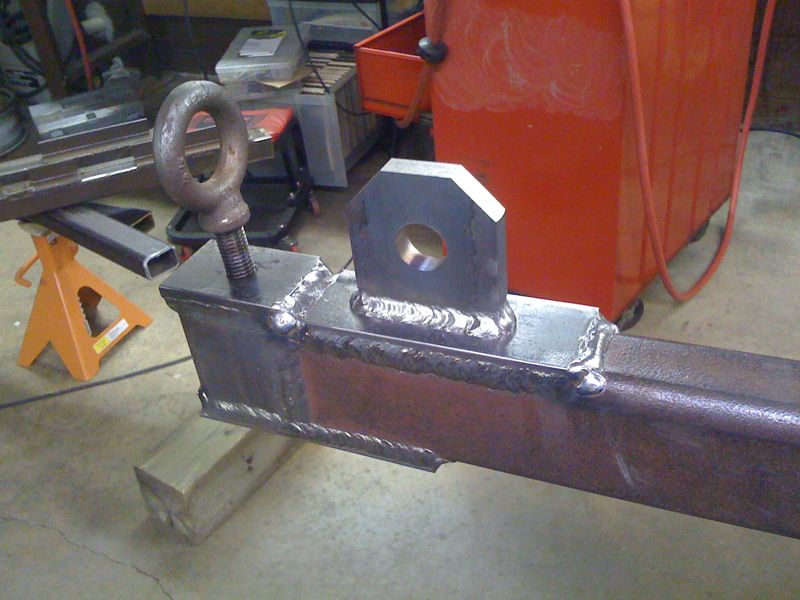

Another pic:
   / YA3PHBP: Yet another 3PH Boom Pole
The lifting point holes are 1" drilled into 3" x 1/2" thick plate ... and the places they are welded onto are plated with 2" (wide) x 1/4" thick flat stock.
The cast lifting eye is one I picked up from McMaster-Carr for another project ... but couldn't use because the threads were too short. It's 5/8" and is rated for 4800 lbs in a vertical lift.

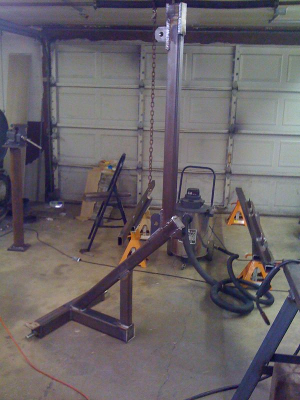

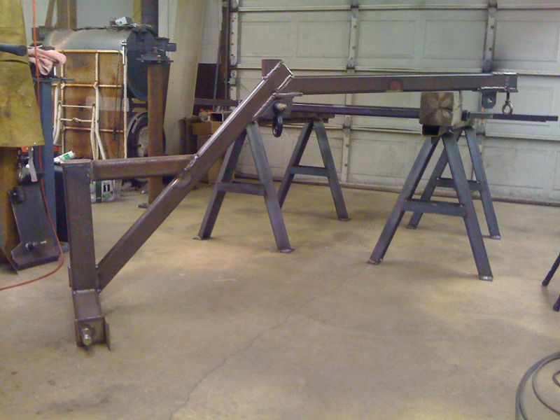

Still have a couple of things left to do before it can be squirted:
1. Weld on the tabs on the "T" for attaching it to the top link of the 3PH (in this case a Speeco Quick Hitch)
2. Weld on the top reinforcement rod ... which I have to pick up at my steel supplier today. It will be 5/8" hot-rolled solid round stock.
