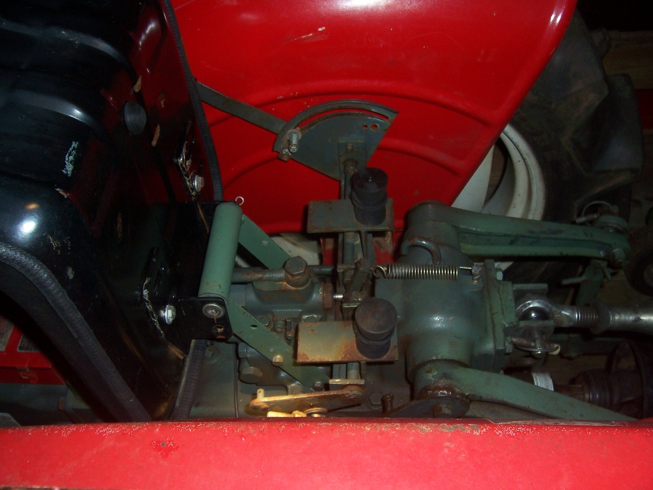

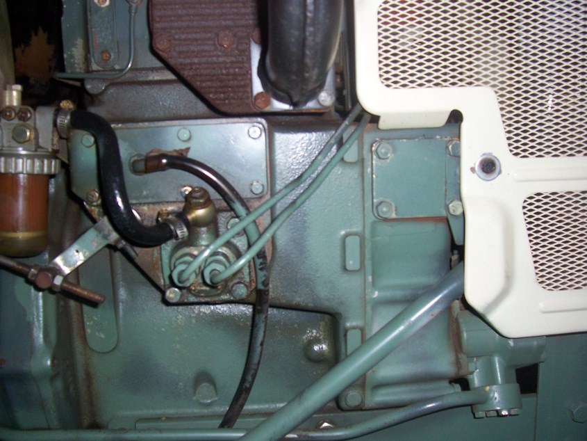

Bee's,Yellow Jackets even ants are bad in Ga.Get a piece of clear Tube so you can see through it. Like this. You can see through it when your looking at it.:ashamed: Under your seat is a U-Tube that is the Hyd.vent. There bad about getting in there also;)

   / Y1700 pressure problem
thanks, I'll check that one also. I have some clear tubing from my medical supplies that should work great. Thanks for the tip.
