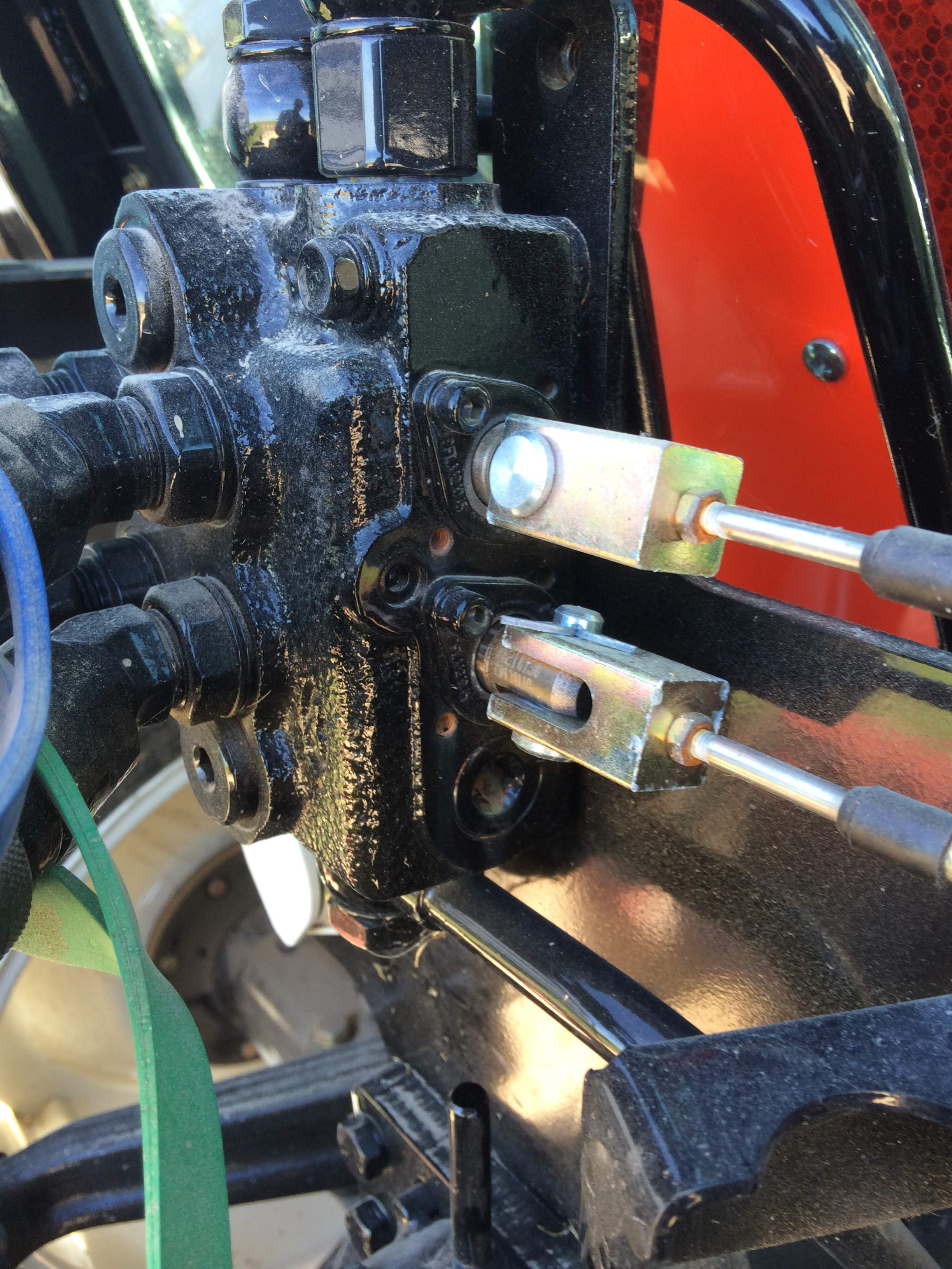

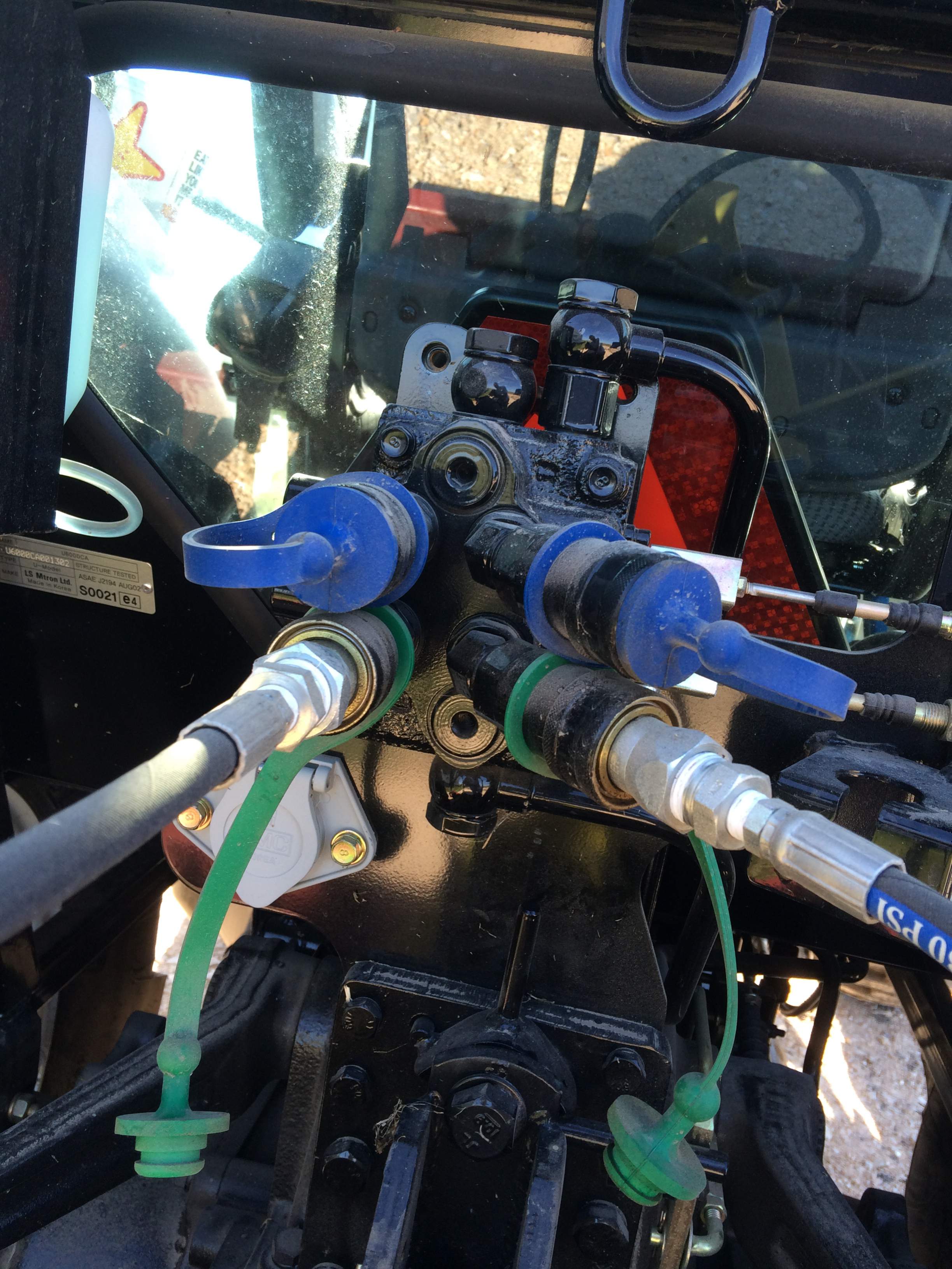

I actually want it for the rear. I had the top and side link hydros installed and wanted a third "non detent" remote to control the top link. I could remove the detent in the blue lever but then I lose that function. Here is a pic of the valve body. I thought it had the room for the third but the dealer is saying that the extra ports are for something else (possibly secondary input ports) IMG_3692.jpgIMG_3693.jpg I am waiting for the dealer cost to add the dealers option but wanted to see if there were other guys that have done this and the cost on it.
   / Xu5055c third remote #5
Typically with mono block valves, what you see is what you have. No additions like stacking valves. If there is a 3 valve option, the time to have done that would have been when-before you purchased it. There is no 3rd rear remote option shown on the website. My guess is that you will need to go with an electric diverter valve, but that is not getting you the non detent valve that you are looking for. :(
Just so you have something to reference too, A single rear diverter kit runs $715 shipped to you.
I hope that the dealer comes up with an OEM solution for you.

My guess is that the dealer would be installing an electric over hydraulic valve. So no float, no feathering. It is either open or closed.
But I may be wrong also, I hope so for your sake.
