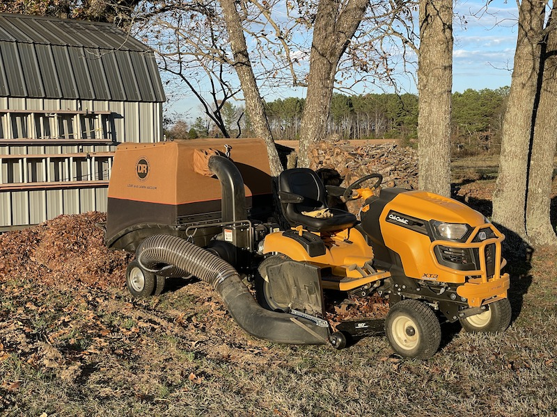

Just a followup that I ended up heavily cutting and modifying the 54" chute (including drilling holes in the deck to bolt it up) to get it to work. Mowed with it a couple times, mainly picking up leaves, and found that the three bags fill up very quickly since the deck does not shred the leaves very well. Once the bags are full, the chute/tube plugs up, which required removal to clear every time I emptied the bags.
Happened to be in town later that week and saw our True Value store (which carries a limited CC line) had a couple DR Lawn & Leaf vacuums for sale, and went back the next day and bought one. It's a revelation! It won't ever really pay for itself, other than it makes the job so much easier and shreds the leaves nicely to boot (for compost on the garden).
Bottom line: there is no proper discharge chute that I could find for the 60" fab deck, so be prepared to modify one if you go that route.

They offer a generic boot that has to be cut-to-fit. Since I had already done that with the CC boot, there was no point in buying another one...
