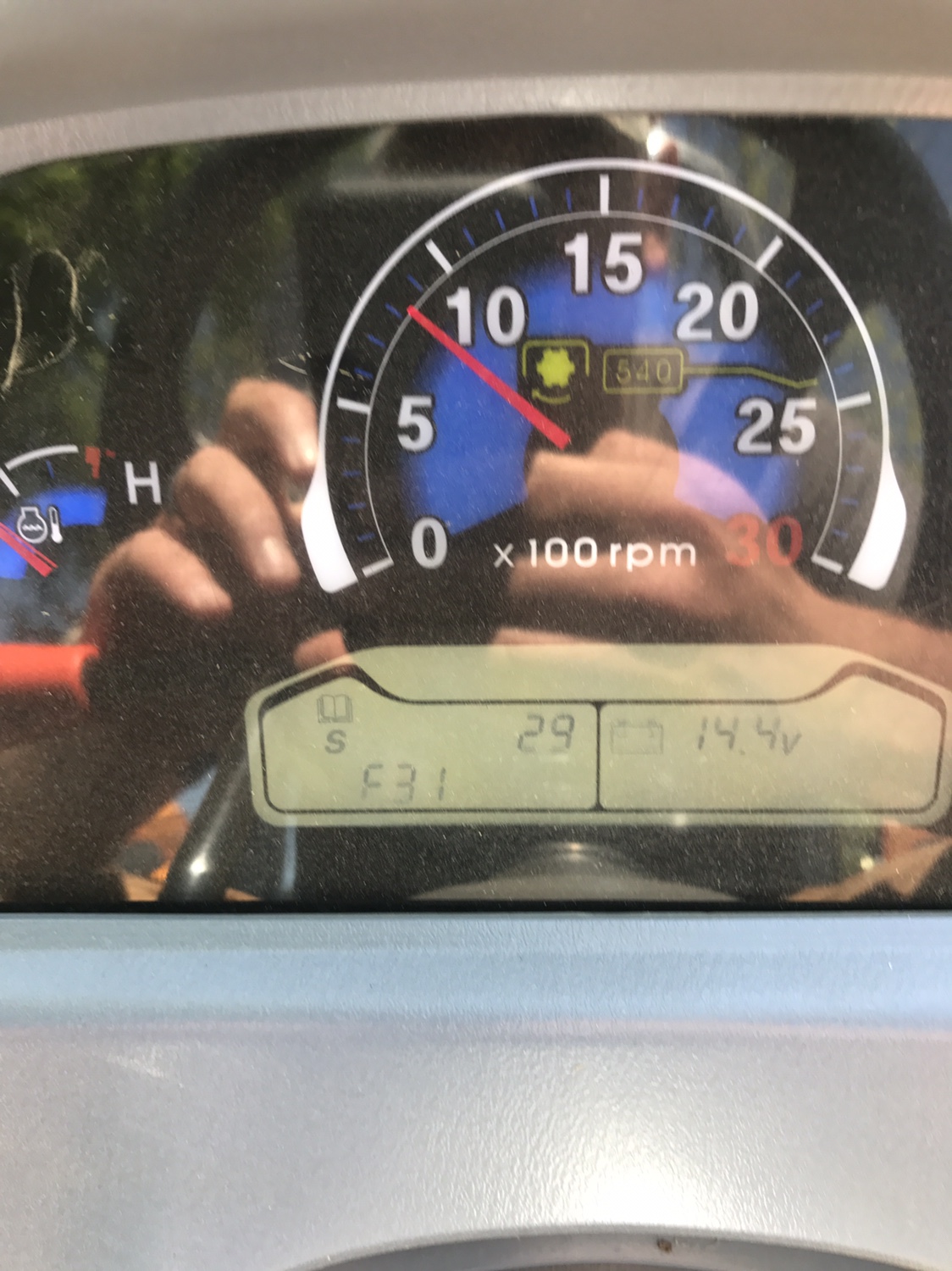

Now I'm getting a F31 , 29 code. Tractor will limit itself to 1300 rpm and disables the throttle. It also cause the tractor to bog when under a heavy load that wasn't there before. Took it back to the dealer so hopefully they can get it figured out. IMG_3952.JPG

You didn't state the hours on your tractor (may be a regeneration cycle fault) and I'm not sure what the fault codes mean. Dealer may need to re-flash the ECU with his service tool.

67 as of date. It's not a regen problem it's done a regen every 20hrs with no issues

Error codes seem to be related to the foot pedal signal as posted by an LS member here in post #3. Another member suggested disconnecting the battery to reboot the ECU on his tractor to get rid of codes. Hopefully the dealer will get it back to you shortly.

A month in on waiting on a new wire harness and still nothing. Tractor has been at the dealer for a week now and they can't even tell me if what the codes mean. Starting to really regret buying this LS and from this dealer.

Picked the ole steed up this evening after work. They replaced the whole wire harness and both the foot and hand throttle assembly's. I've got lots of work stacked up 3 bush hog jobs not counting my place so should put it to the test through the next week. Dealer did run it for 4 hrs with no issues. Fingers crossed. I'll report back next week.

6hrs of bush hogging since Friday and no issues yet.
I put it in some 6ft tall weeds/ Johnson grass and tractor never bogged or skipped a beat. It impresses me when running right hopefully this is the last of my issues.
