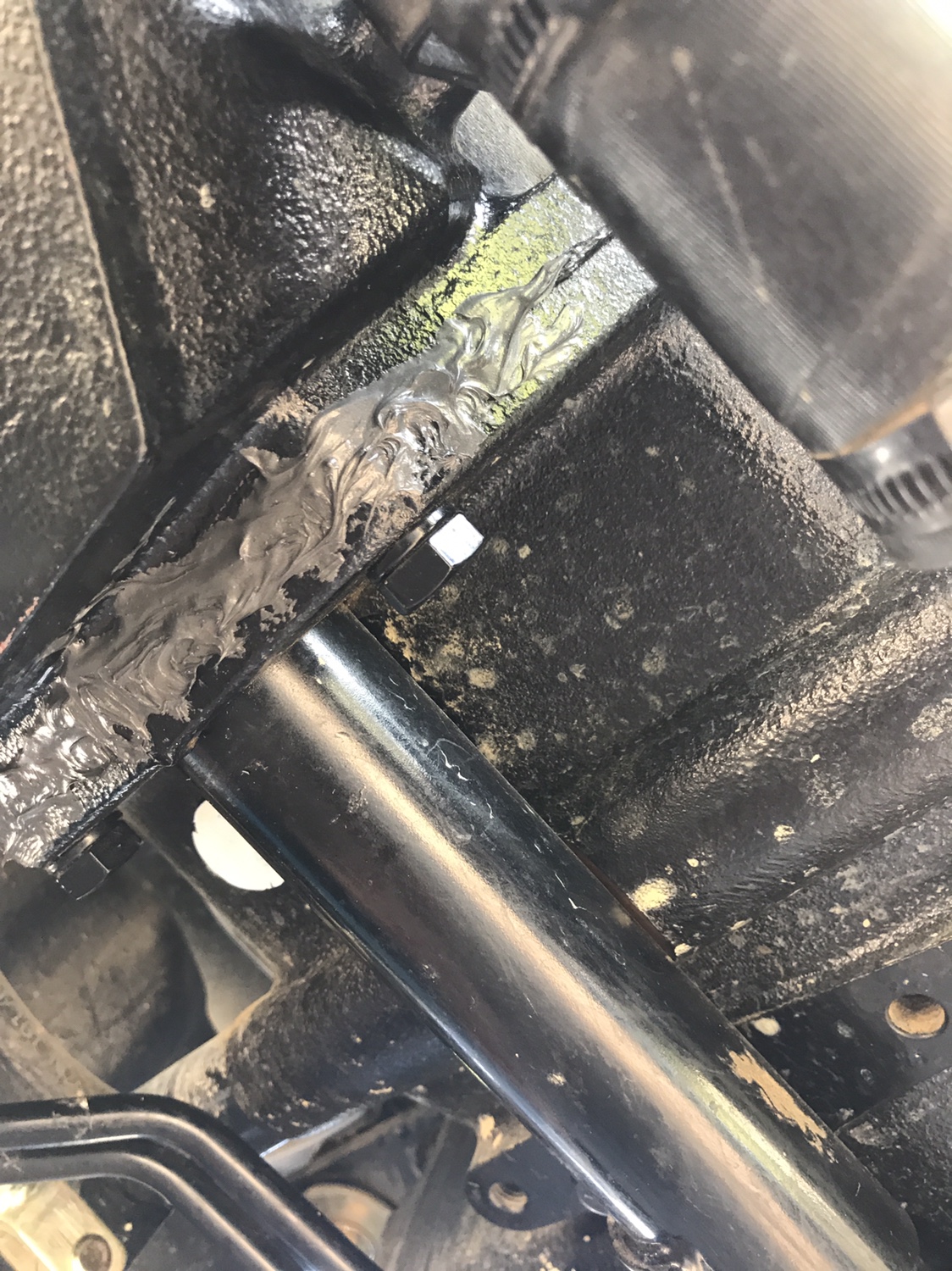

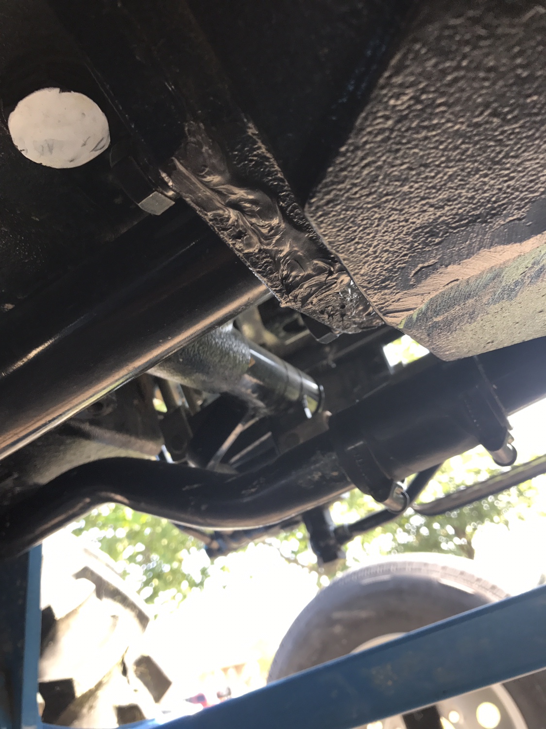

Back at it. Now I've got a hydraulic leak from right where the front drive shaft goes into the trans. From what I can tell the tractor is going to have to be split to fix it.
/ XR4155 issues continue
#11
This morning I scrapped what rtv that was on the case from assembly off and cleaned it good with brake cleaner. Put some new rtv over it hopefully this will patch it till I can get it into the dealer. Or maybe stop it all together. I've done this before on transmission pans etc and it's worked. We will see. IMG_4066.JPGIMG_4067.JPG
