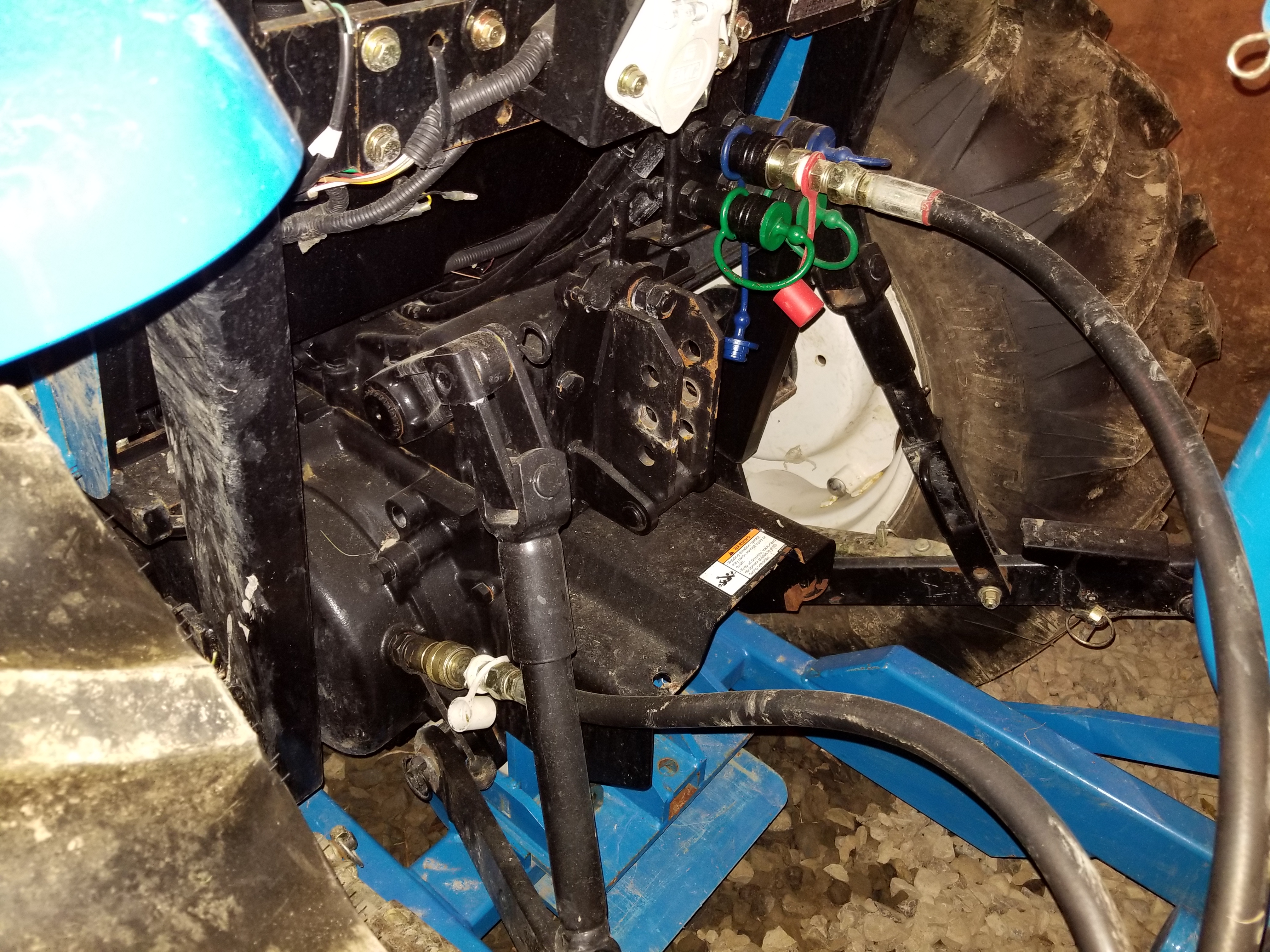

I have a question for LS backhoe owners. Do both of your hydraulic hoses go into the rear remotes or does only one go into the rear remote and the other go into a female fitting on the left side of the differential? The backhoe manuals show what LS calls a "hose kit" which puts a female quick connect on the differential. Curious as to why this is or if it is a requirement. Thanks.
/ XR4155 backhoe removal #9
One goes to the outlet on the remote with the detent valve, the other goes to the case drain on the differential. I never remember which, so when I connect them, if the backhoe works in reverse, just swap the hoses, and you are good to go. I'll get a pic of mine if I remember when I get home.
/ XR4155 backhoe removal #10
This is how I have mine hooked up. The blue lever next to the operator seat has the detent

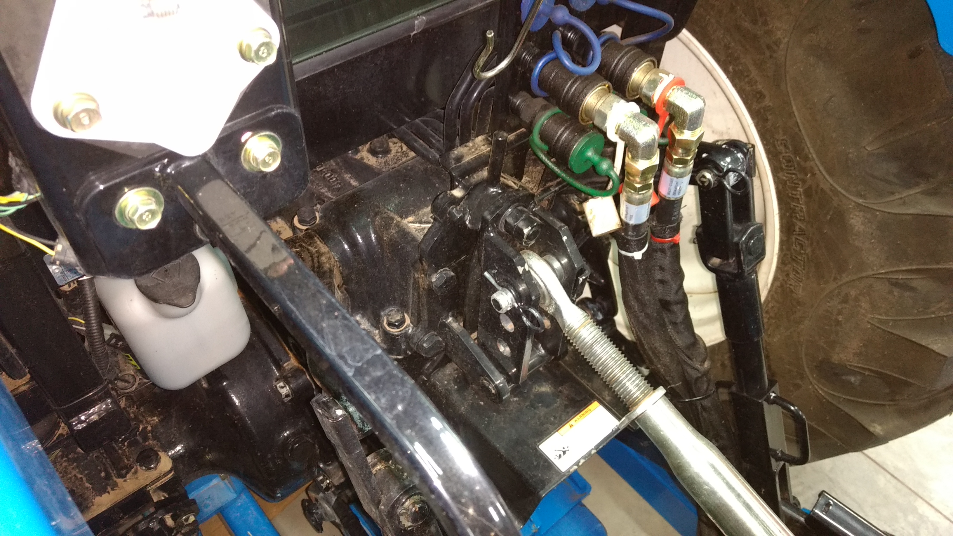

That's interesting about the "hose kit" connection. I have a 2017 XR4150HC, which I wouldn't think is much different, with no hose kit, and my backhoe connects to the two blue hydraulic couplers.
"if the backhoe works in reverse, just swap the hoses" Unless I misunderstand, it shouldn't be necessary to swap the hoses. Just change the blue remote lever to the opposite direction which reverses the direction of flow.

I have three sets of remotes on mine, blue-green-brown, male/female for each set. I just plug them into one of the pairs (usually the blue one I think)
#17
Why couldn't you just plug it into the unused blue remote? That's what I do with mine
