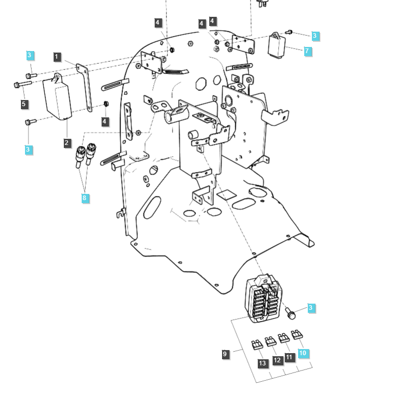

I went through the manual and could not find where the fuse box is located. I want to wire in a camera system on a switched circuit. Anyone know where the fuse box is located?
   / XR4140 Fuse Box #2
Looks like it's located under the dashboard?
   / XR4140 Fuse Box #4
left side of the steering wheel, under the dash. There may be a spare 10 Amp circuit in there

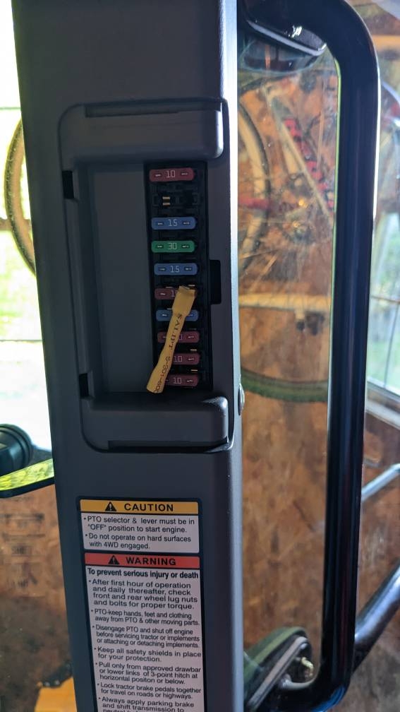

Since you have a cab tractor, there is also a fuse bank on the left pillar of the cab. FYI.
   / XR4140 Fuse Box #6
Yes, what Avenger said!

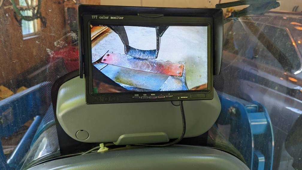

The front camera is "loose" with two rare earth magnets so I can move it around and mount it wherever I want and move it from one implement to another (see picture). In the picture, I have it mounted up above the grapple just so you can see it in the picture.
The wiring is placed inside loom and runs up the loader arms along the hydraulic lines. It then runs under the tractor (zip-tied) and runs into the cab through one of the through-hole ports through which other wires run.

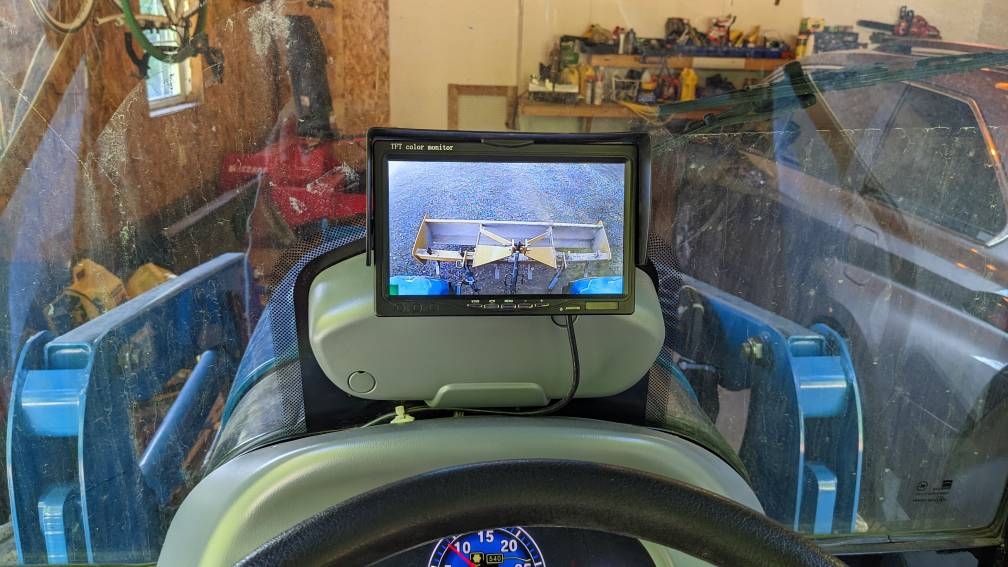

The line to the monitor runs up under the dash and comes out the top, with the monitor secured to the window with double-sided tape. You can see the view provided by the front camera with it mounted in it's normal position (see picture).

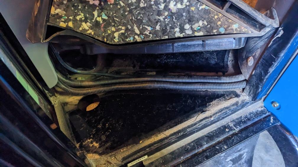

The power runs along other lines that are under the floor mat (see picture). It runs up the left pillar to the fuse box where it is jumpered to an existing fuse for power (see picture). This way it turns on when the key is turned on.

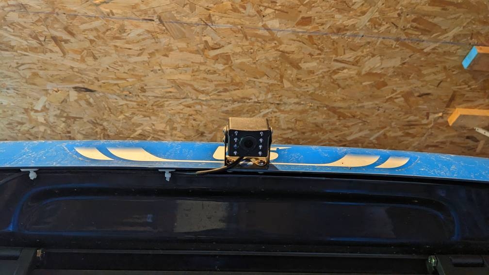

The wiring for the rear-facing camera then runs up inside the pillar from the fuse box and across the roof (under the panel), before exiting the rear at the roof (see picture).
