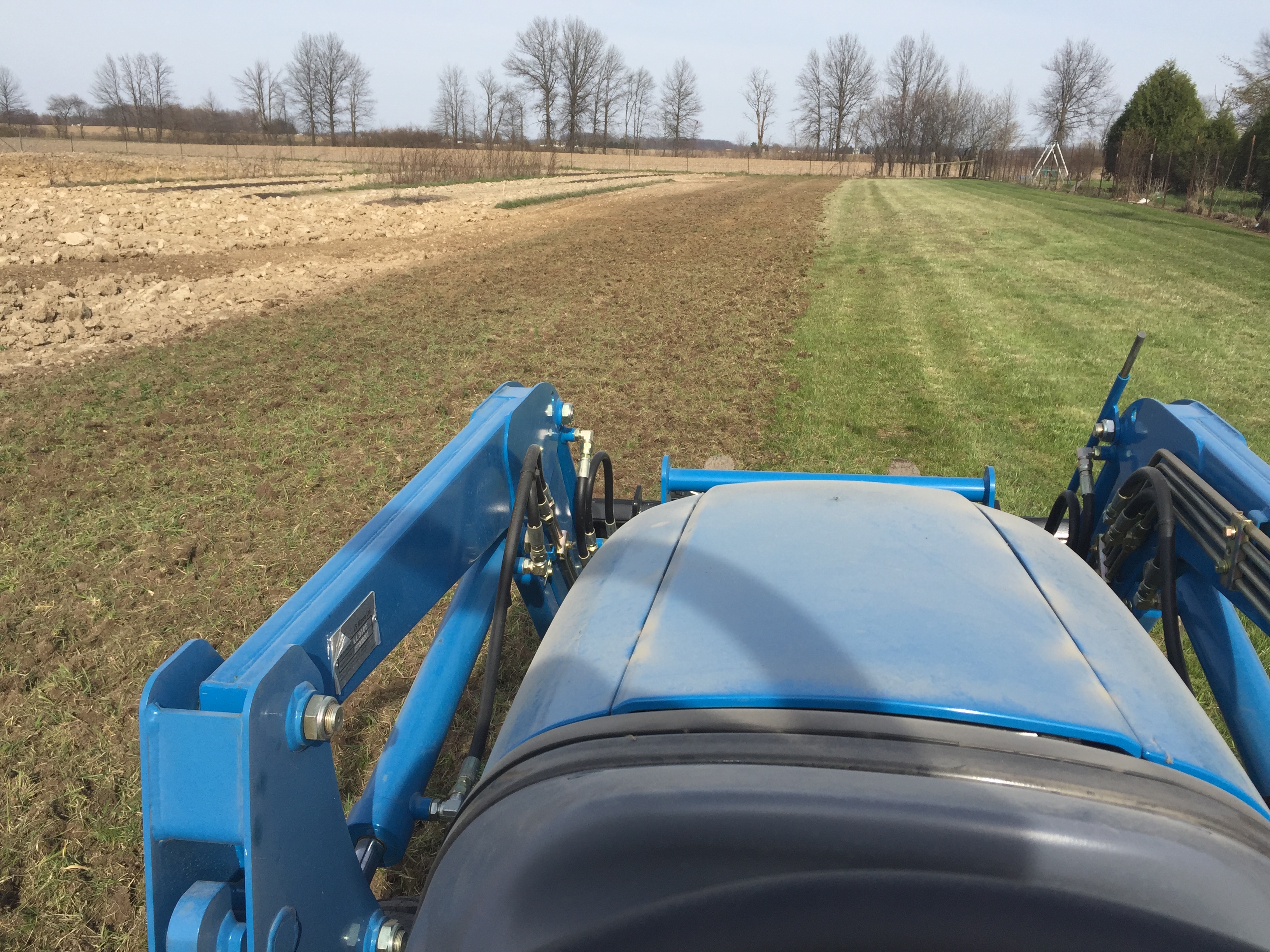

I appreciate the replys. I've given it some thought. I should have some pictures to post of a King Kutter later this month.
   / XR3037H rotary tiller questions
My 'test' run ended up being more like an acre. It's a 6' KK tiller, forward rotating. I had previously been running a sub-soiler through the field. The tiller did a good job leveling the humps, etc. back down. It was a little damp in a couple of areas so stopped for the day. The rain is coming this week so that may be it until next month. It bogged down a few times but not enough that I would be worried about running it. It did good tilling up the sod as well as last years field space. I'll try to attach a couple of pictures.
